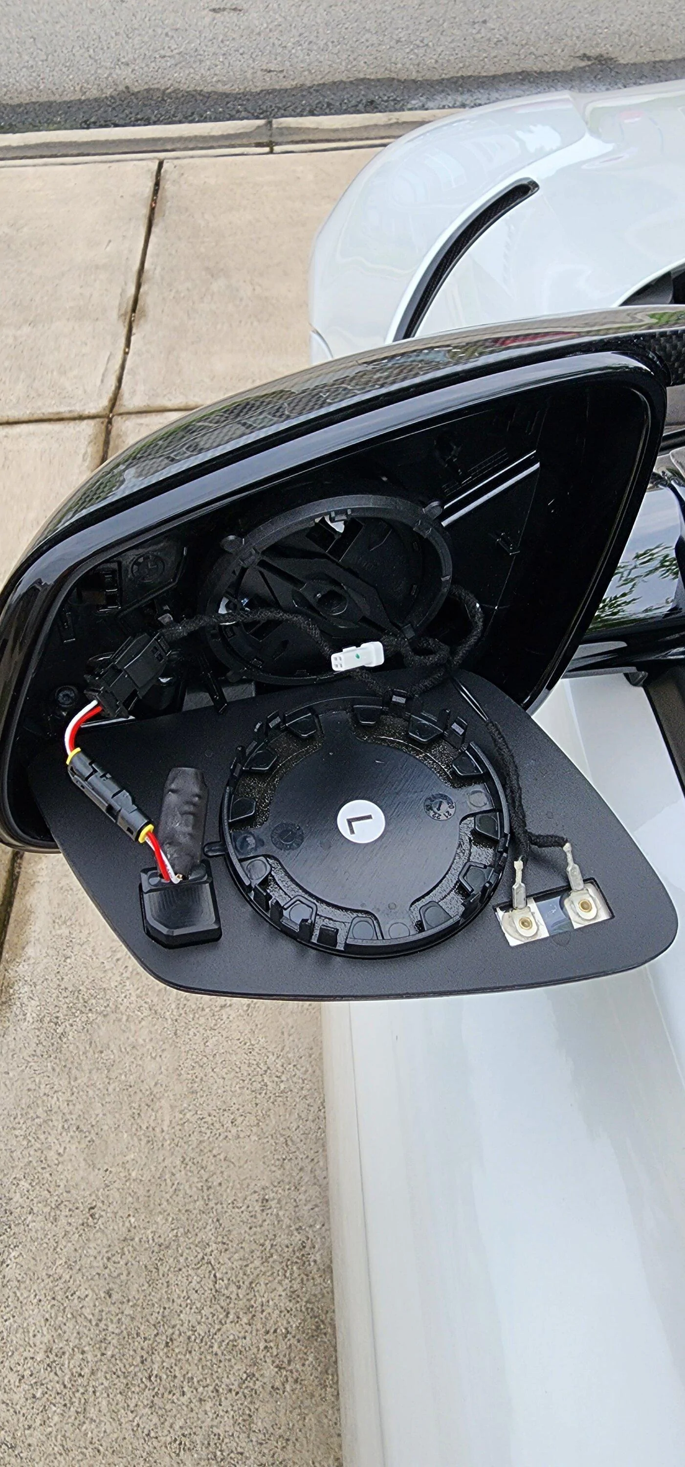

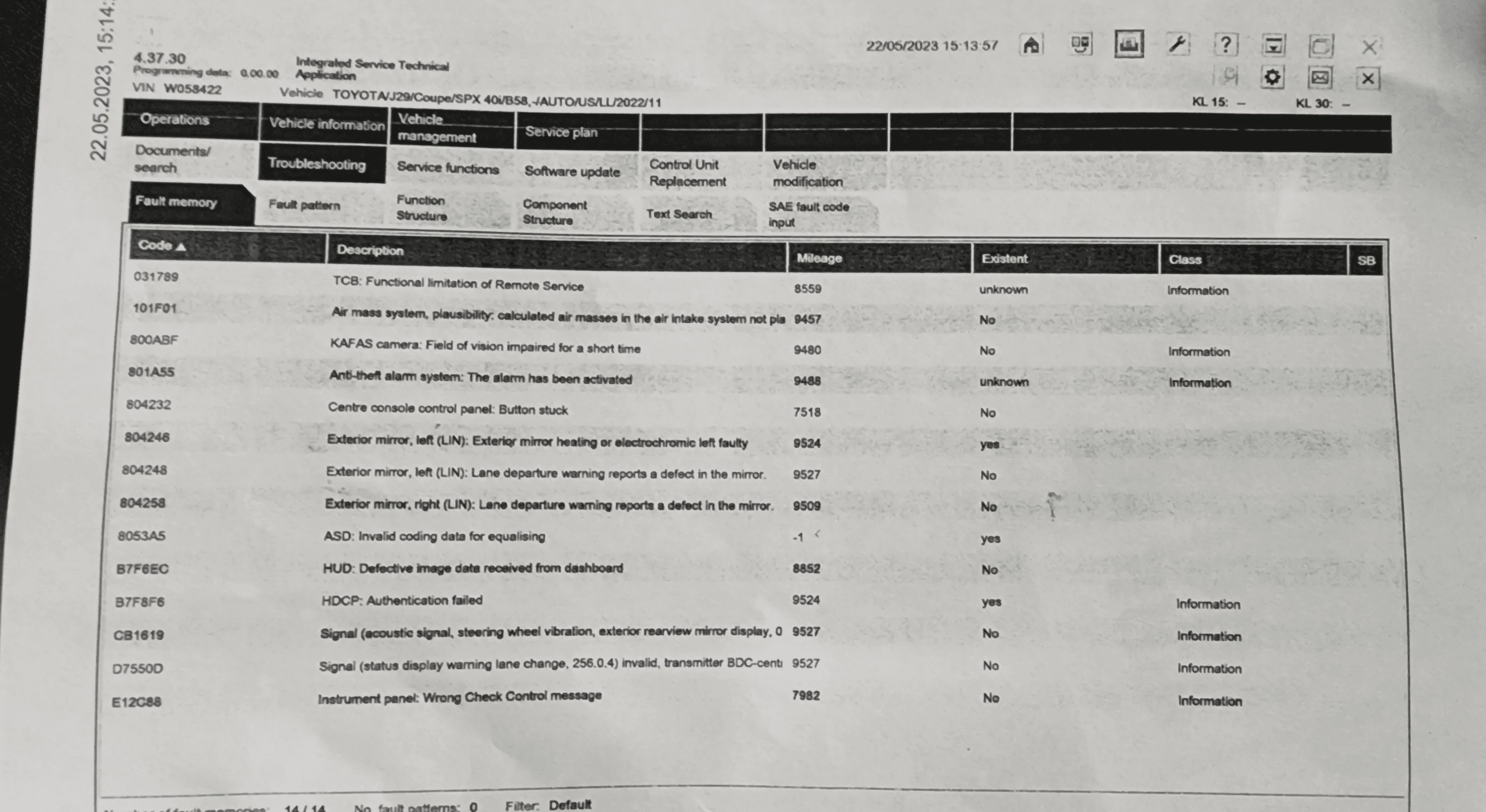

Hi guys,
Has anyone run into this problem? The blind spot indicators light up just fine, but I'll sometimes get a constant ping of Reduced Driver Assistance Warning popups whenever a vehicle is on my sides. The master tech at my local dealership returned the following error codes (attached) and thinks it's likely an issue with the mirror being defective.
I've also attached my wiring (excuse the mess, never fully cable managed it with electrical tape like I had planned due to the errors...) - the white cable doesn't' seem to connect to anything and I've just left it hanging - could this be why it's throwing errors?
Any insight would be greatly appreciated. I'm hoping it's not a defective unit.

In your left side picture there's a connector that isn't plugged in. If you didn't wire tuck well, there's a chance that one of the wires got pinched.

So I also bought these mirrors. Swapped in the new ones and everything worked fine but the blind spot malfunction kept popping up nonstop. Unfortunately for me when i swapped back to the oem mirrors I still kept getting the error as well.
I also had the extra cable on the drivers side that didn’t plug into anything.

Hey Henry,
The extra white plug / cable in the driver side is for the Anti-Glare of the OEM mirrors. Since the polarized mirrors already have the anti-glare function on it, we recommend that you use the waterproof tape to wrap and fix it in the mirror base.
As for the Reduced Driver Assistance Warning, we believe that it will stop pooping out after the Anti-Glare function is closed from the car screen or the computer from the body shop.
