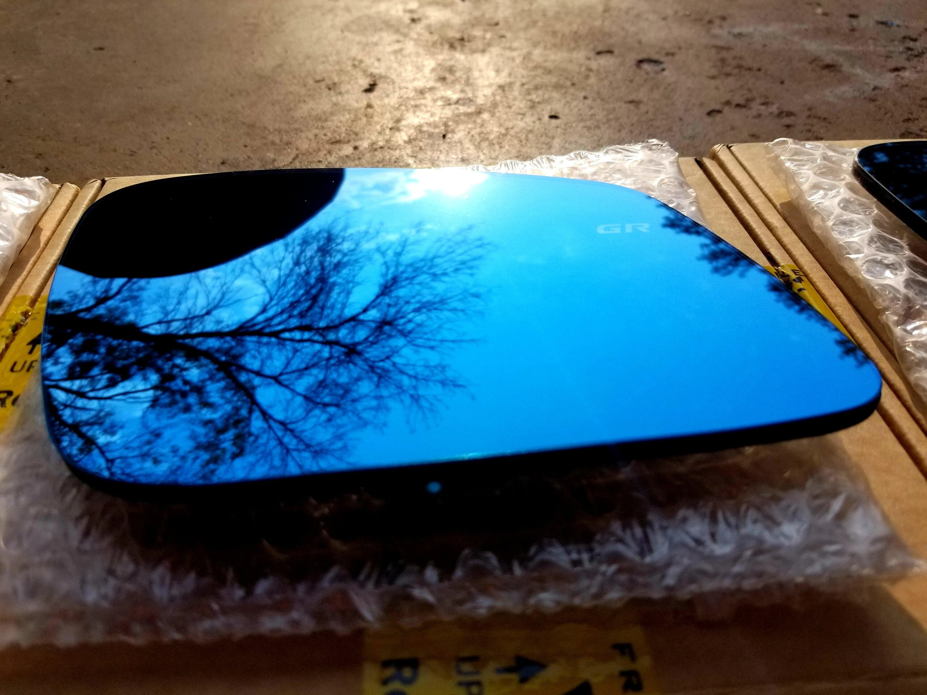

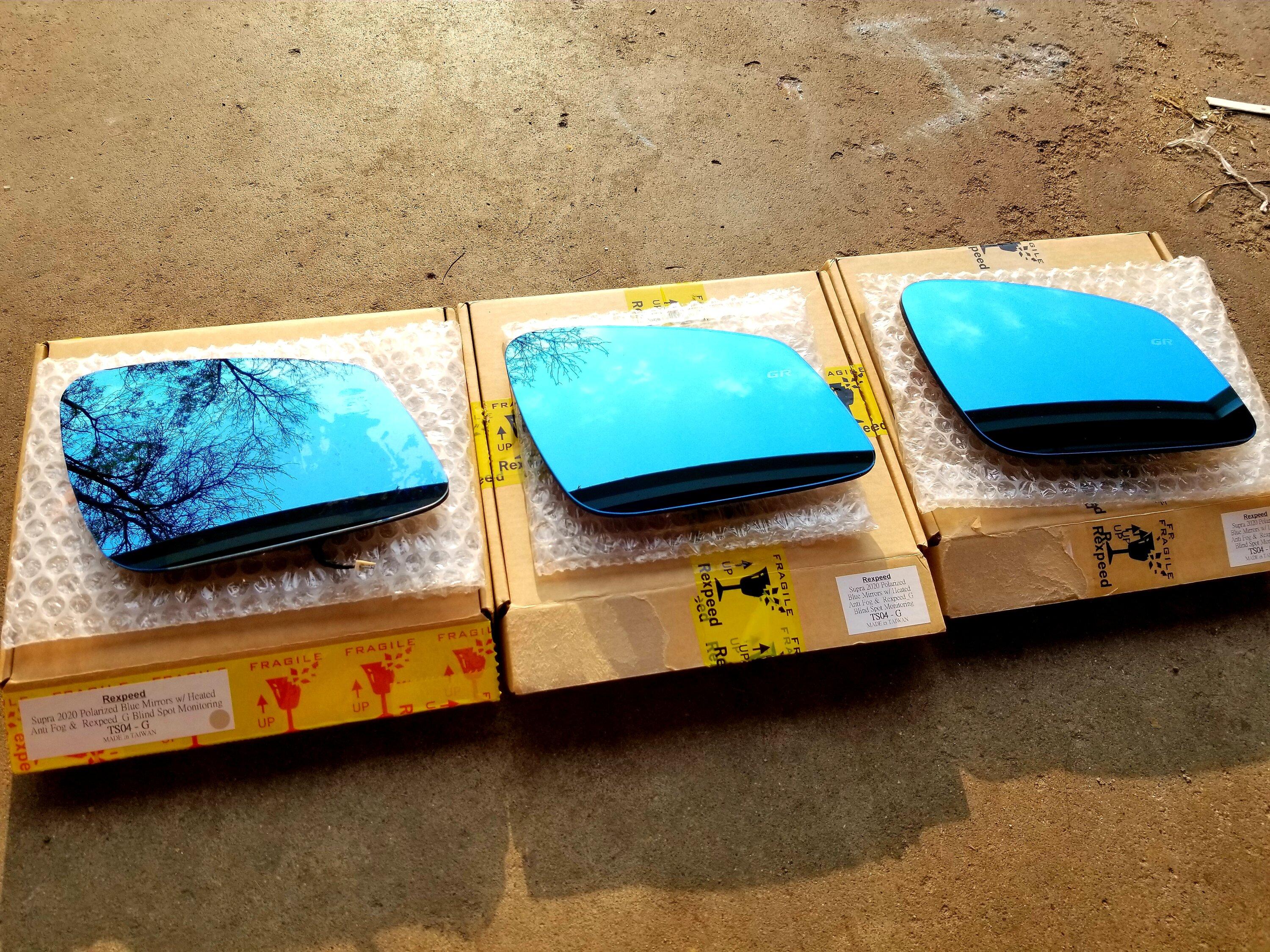

Here's my update.

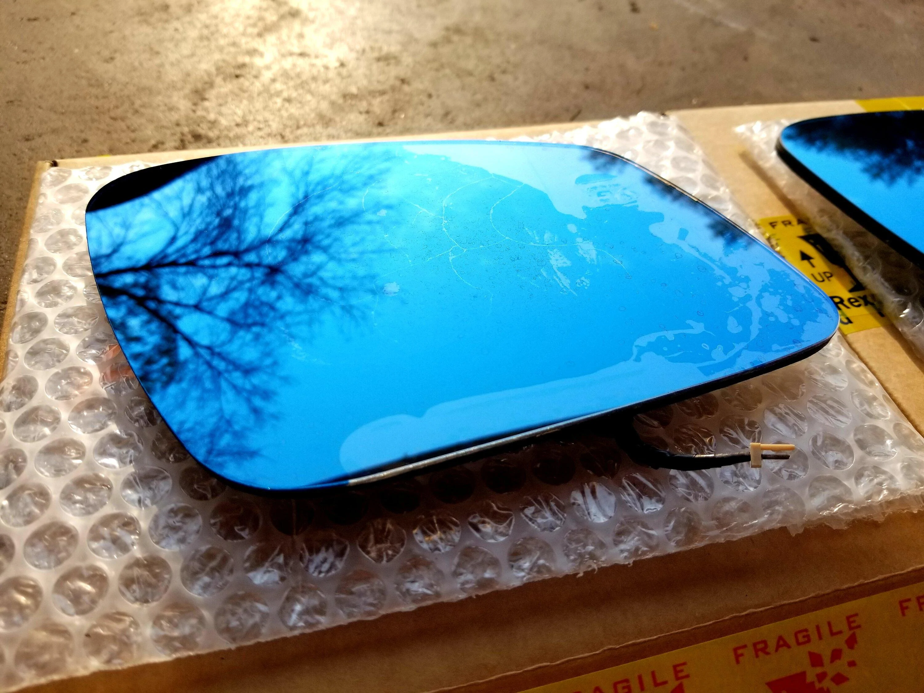

I bought a pair of Rexpeed GR logo side mirrors back in 2021 from Speed Industry. The driver side started started to bubble from the adhesive peeling and cracking behind the glass. I emailed Rexpeed providing the invoice # back in May 2023 hoping to just buy a driver side replacement, but I received a compensated offer to get a whole new set.
After receiving my new 2nd pair of GR logo mirrors 25May2023 I started to get this same reduced blind spot monitor error message and found this on the forums. Rexpeed confirmed it was a manufacture defect and announced a remedy to effected customers on this thread. It's already been a month since the issue has started and I've reinstalled the oem mirrors back on. I had given up all hope and I didn't want to spend anymore time reinstalling the mirrors to record and prove they had the errors. I just planned on sticking with the oem mirrors until next year for a better batch of chips can be made.
To my surprise, I received an email that I was getting a GR logo mirror pair mailed and got it to my address in the same week. Just installed the newest set of GR logo mirrors today and drove with them for 40mins working great with no error messages.
Can't thank @Rexpeed enough for backing up their product and great customer support!!!
Here are some pictures to show I actually went through 3 sets and still would highly recommend getting them.
(Oldest to newest left to right)
You can see the comparison of bubbles on the outer side of the passenger mirror here.

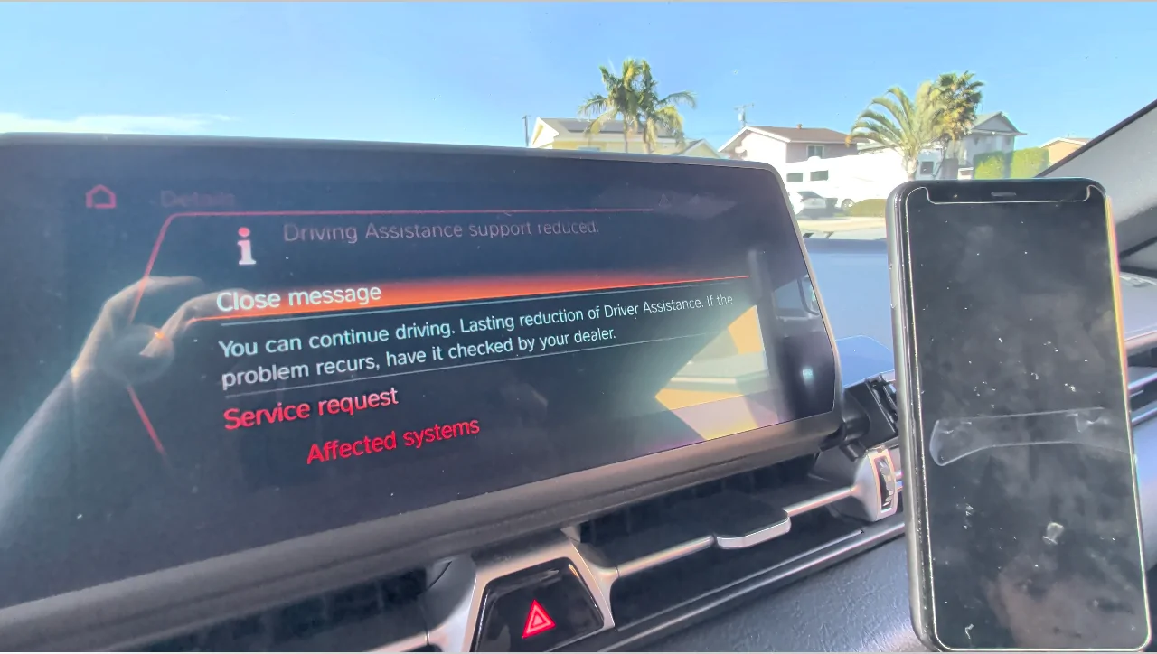

I'm gettig this error with the Rexpeed mirrors now. Will reach out to @Rexpeed for help.

I'm getting driving assistance reduced popup.
