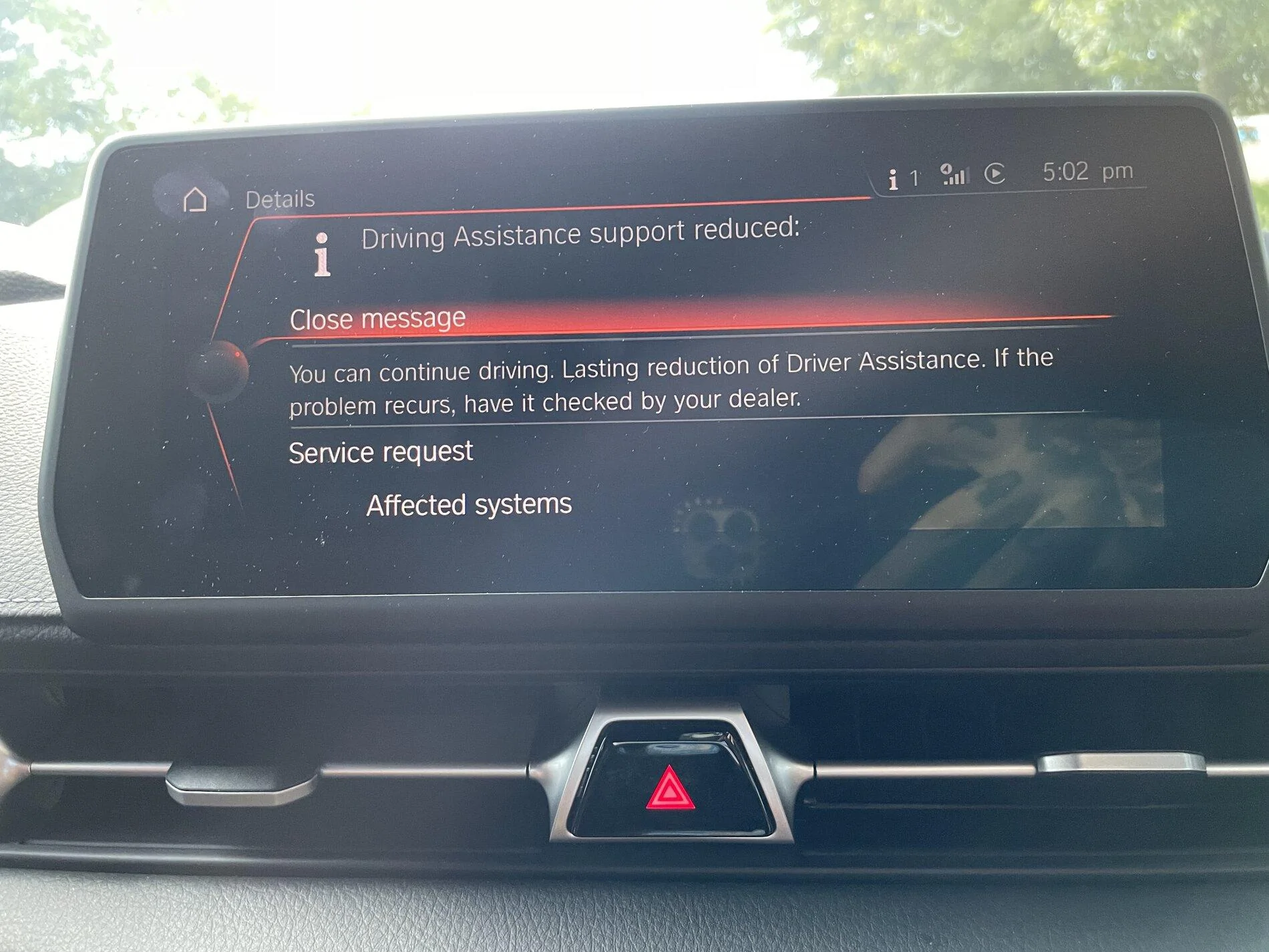

Update: The warning now pops up every time I start driving. I just spent 4hrs at the dealer for a diagnosis today. They said they will need to replace the camera at the rearview mirror. Estimated part cost = $5,000. Good thing for warranty! Part is on backorder so will have an update in the next week or two.

They had to replace the front camera located in the middle of the front windshield. After it was replaced they have to do a calibration to it. I had to go back three times for them to get it calibrated and adjusted properly for it to work. They had to get Toyota on the line and do walk-thru's to get it figured out. They even had to flash all the computer software car. Kind of annoying but it is all fixed now without any issues.

They couldn't figure out what was the root cause that made it go out. They think it just shorted and crapped out and had to be replaced. It's actually only been about 3 weeks now since it was fixed 100%. It was a long process getting it taken care of.

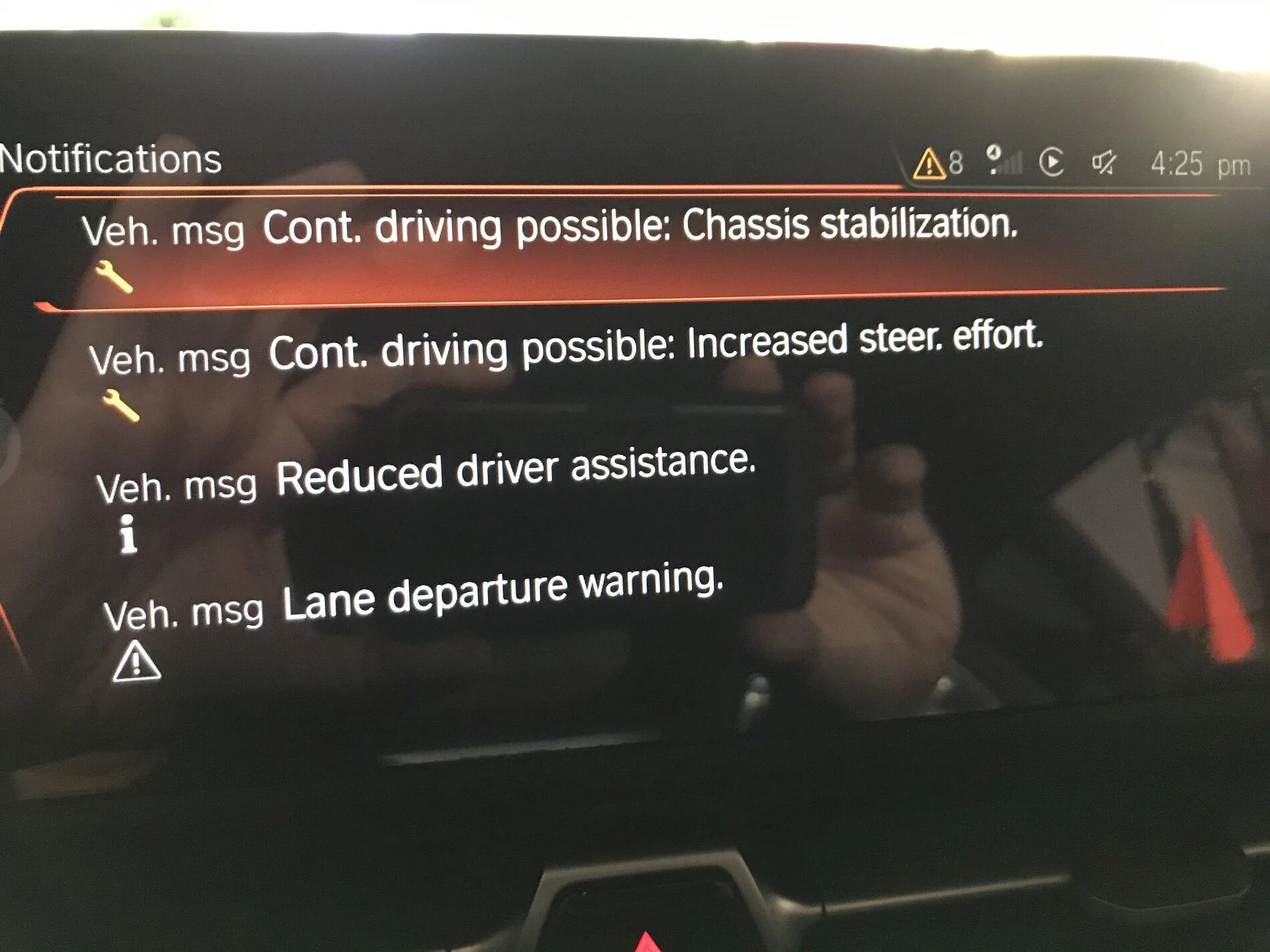

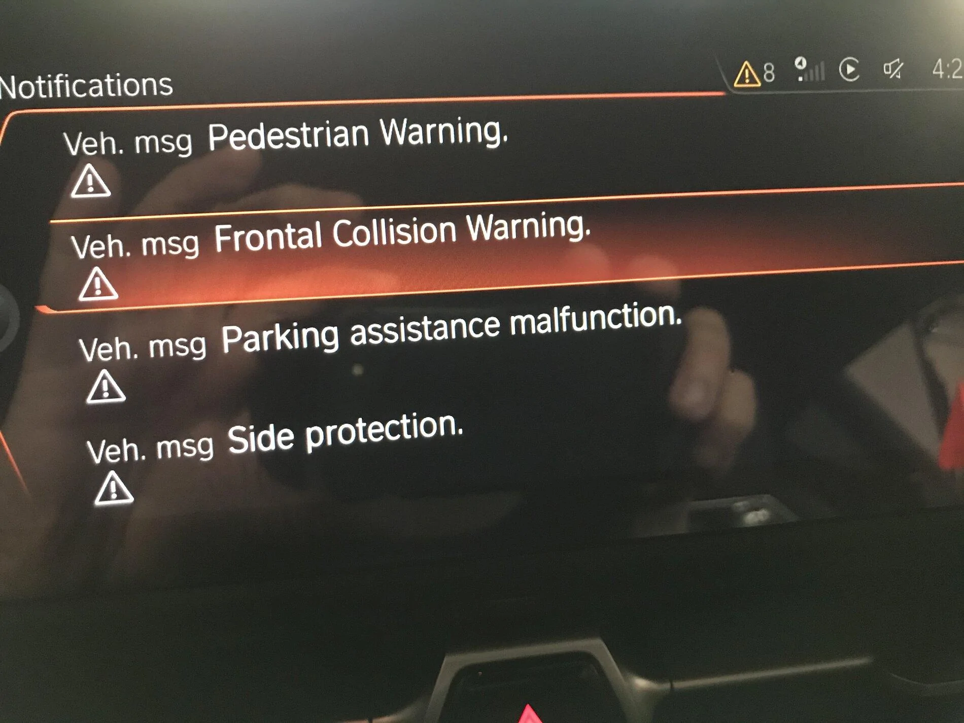

My 2021 3.0 Premium did the same thing. I had between 7 and 9 warning messages popping up every time I started up the car and it would reduce power steering assist & the locking of the rear diff. Eventually the EPS (electric power steering) went out completely and I had to have it towed in for service.
The dealer claimed to clear the codes by flashing it with the latest software but they couldn’t get the EPS to communicate with the car and had to replace the EPS rack entirely.

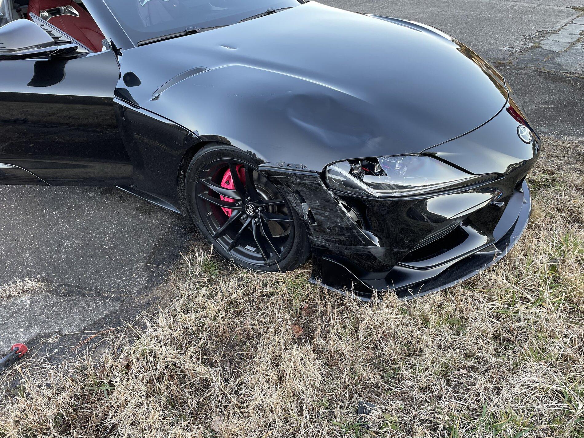

But this issue didn't start happening until after I was in an accident that involved replacing the front bumper. So if Toyota won't cover it, my insurance company will
Update *** Dealership said it's a front sensor, ordered it from Germany, and will be here in 3 weeks.
Sorry about the accident hope you get resolved smoothly. Please lets us know if that sensor fixes it.
