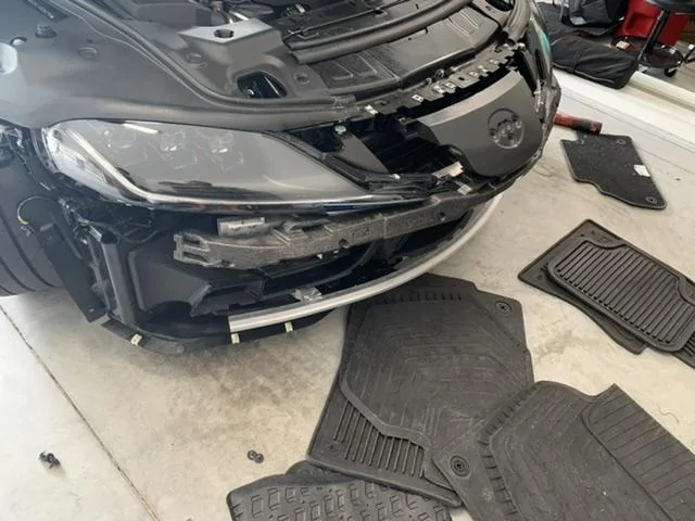

black_sedan
BR
Sep 15, 2019
635
551
Northeast Florida
a90 Supra, Ford Raptor
Crazy I had this pop up before. I believe someone bumped my car with a cart in a parking lot since the radar sensor was shifted. I pulled the bumper off and realigned the sensor and made sure all connectors were connected and tight, it went away shortly after a 50 mile drive
