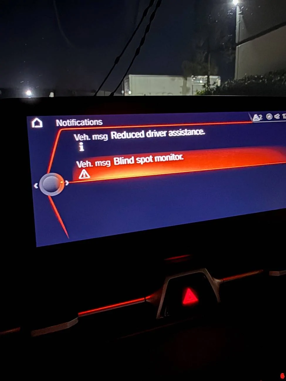

We took the bumper off to wrap and now when I started to drive off, a notification popped up "Veh. msg Blind spot Monitor".
I checked the side mirrors turn signal and they light up but I did notice that the arrow on the side mirror itself did not light up and could not pick up the car next team when on the road.
Has anyone else every encountered the same issue?

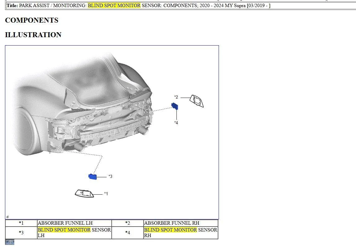

There are no sensors on the mirror. BSM uses the sensors on the side of the bumper primarily for blind spots. The front and rear ones mainly for front and rear detection.
BSM sensors wouldn’t disable all sensors.

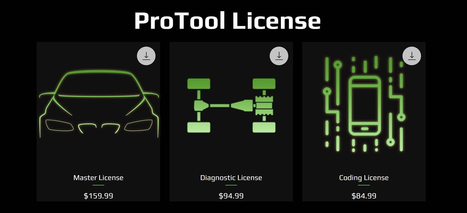

If you have it, use Protool to tell you which sensor is giving you the error. I had a BSM error and it told me my passenger mirror was the issue as it has the part that lights up the orange triangle in the mirror (that was dead).

Thank you! Looks like it’s only for android devices. I’ll have to find someone in our group who has an android phone.
oh thats right. You can also just use a cheap android tablet too. There are different licenses depending on what you need from the app...

mhd universal (red one) works with protool. that's what I use.
