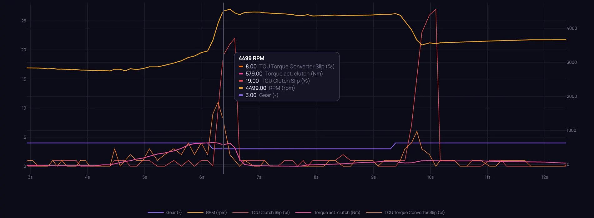

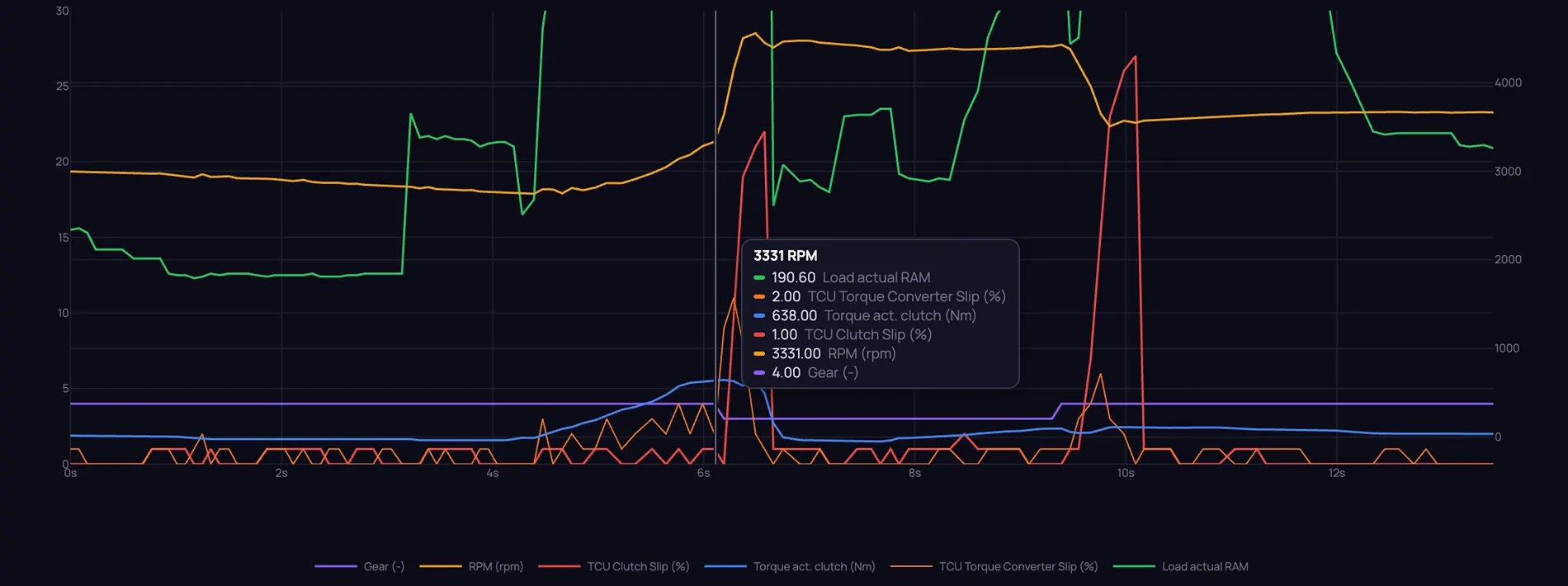

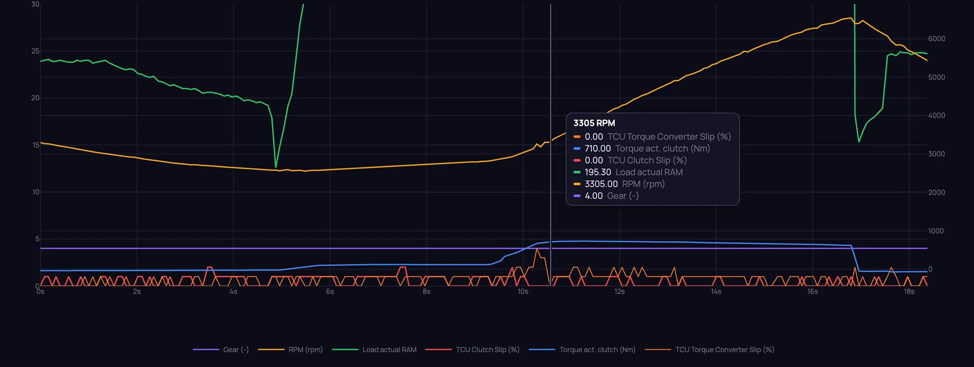

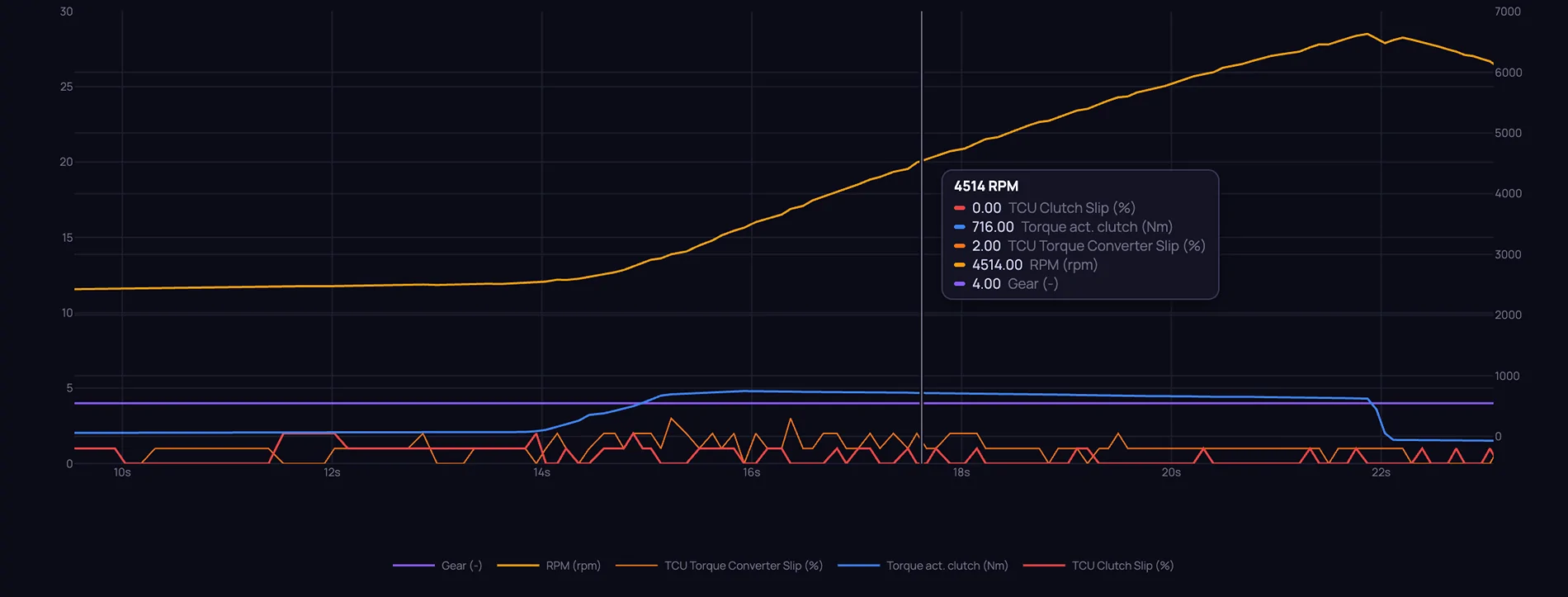

TCU consumes reported torque from DME, TCU decides line pressure, clamping force, converter-lockup, etc based on reported torque from DME. If the car is actually making more torque than is being reported, the possibility that the TCU isn't giving enough line pressure/clamping force/converter-lockup is higher and clutch slip can happen.
You don't even need to be making a ton of power to have this happen. Stock turbo... clutch slip, converter slip, RPM flare, gear decrease. Increasing Z values in KF_MDIOP_1_TQE confirmed to work.
Before
After
Before
After
