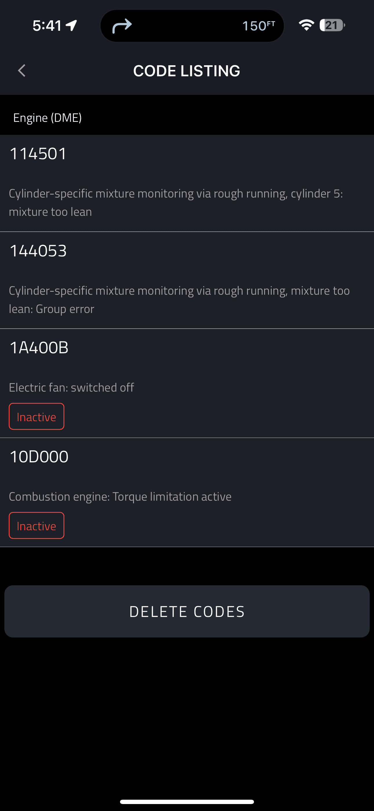

Hey good afternoon everyone,
I had about 1/4 of gas when this came on. Thinking might’ve been either low gas or shitty gas. But would love a second opinion on why I random got a CEL light throwing these codes?
Mods:
BM3 running OTS MutiMap
BL Downpipe and Exhaust
Driving on 93 Octane
After I filled her up, cleared the codes and drove her 50 miles. Not getting any CEL lights anymore but still want to know if anyone else had this issue?
Thanks

BM3 OTS maps aren't all that good. I wouldn't worry about it.
8,831
17,324
BM3 OTS maps are fine. I've looked over hundreds of logs from them. People are just biased because they are human.

I agree with @razorlab the bm3 OTS tunes are fine for mildly modified vehicles.
If you just want a custom tune Botti, Payn, Viscontii are the most popular, I used Paul Johnson aka F80Paul.

Alright so with the OTS maps being fine, should I worry about these codes or nah?

The codes are not a normal part of a BM3 tune. I would only be concerned if they come back or become persistent.

And with that, they haven’t came up again after driving it for 100+ miles today. I do want to appreciate everyone on this thread for their input.
