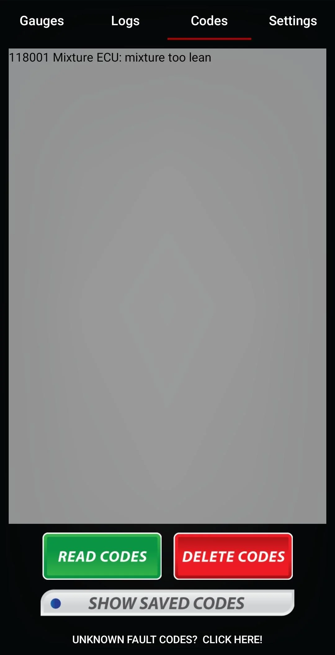

Running e33 on a custom jb4 map and this fault code just showed up today with about 1/4 tank of gas left.. any ideas?

I got this code after finishing the custom tune on jb4. Cleared it and it never came back.

I’ll get the code after filling up. Once I clear it, it won’t come back until I fill up again.
8,472
14,122
Too much E.
JB4 can't actually control fuel, mixture, or lambda tables. Clear it and see if it comes back.
If it doesn't you're fine. If it does, you need to use less E.
