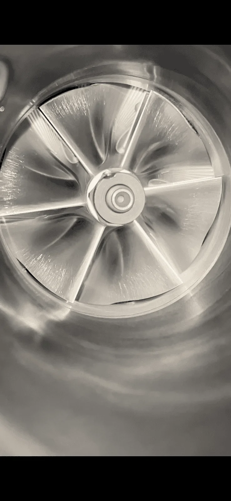

Well that sucks, I’ve seen plenty of people run the JB4 on map 2 with zero issues, tomorrow I plan to take my car to a shop and see if my turbo really is done. Not saying you’re not wrong or anything. Took a picture of inside and not sure of any damage is done.

Remove the airbox, intake pipe, and PCV heater from the front of the turbo.
Then check for shaft play. If you have in/out movement, the turbo is junk and needs to be replaced.
