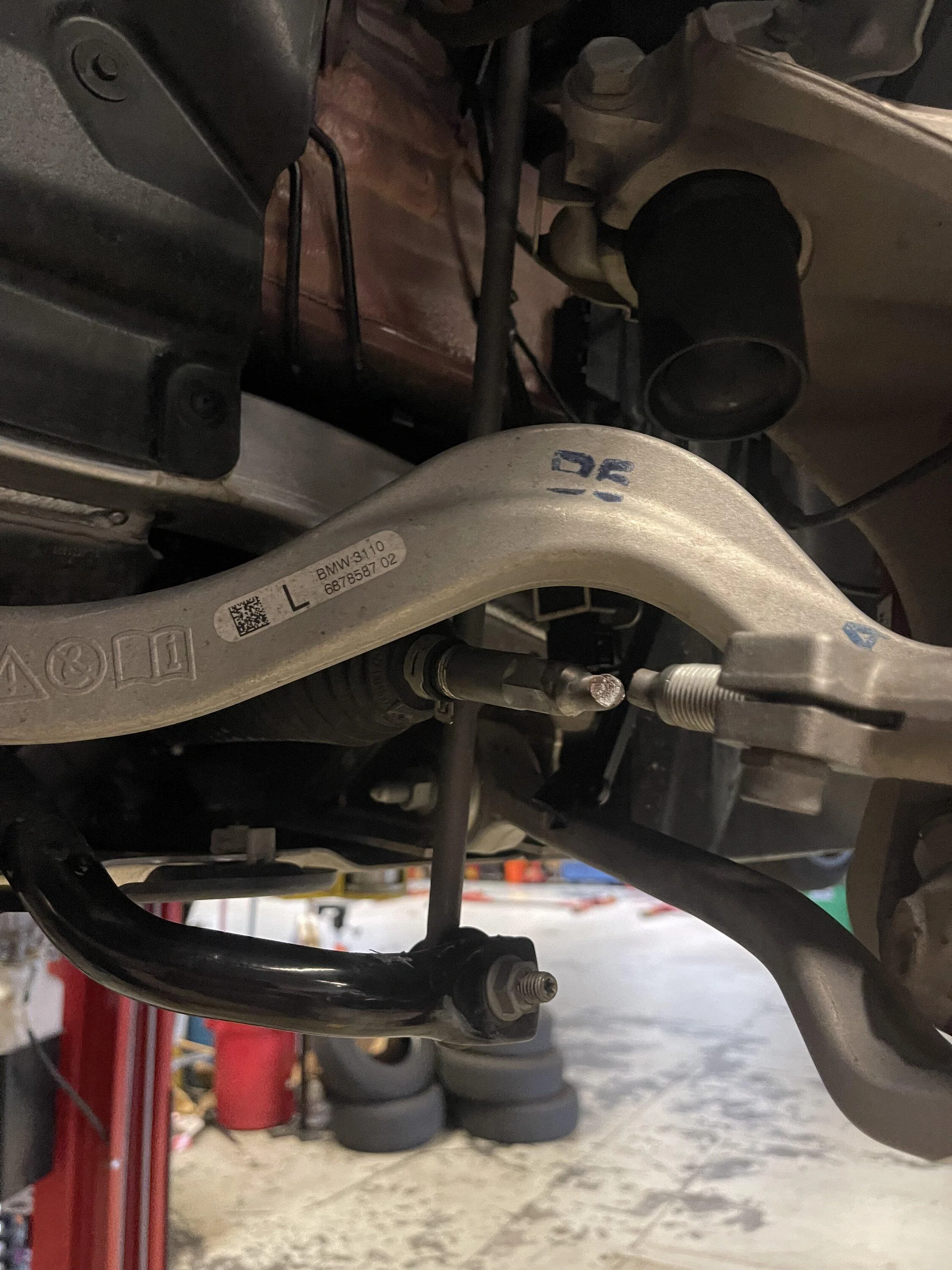

I struggle to see this costing less than $500, but certainly under $1000, provided that the tie rod is the ONLY problem.
OP @SupraSteve1 , with the tie rod so bent for a time before it broke, didn't you notice the front end alignment being total crap? One normally can't bend a tie rod that severely and drive on it without the front toe being quantifiably out of whack.
Would be pretty close.
$120 part
$250/hr shop time (anyone that takes longer than 1hr to install a tie rod with a lift is scamming you.)
$150 alignment
$520 total
hell, let's say MSRP for the part
$157 part
$150 alignment
$557 total
I guess I forgot tax.
$50 for 9% sales tax = $607 total
$4,393 less than $5,000

It was in for routine oil change service a couple of months ago, so I guess it may have been on a lift for the tires to be rotated
Maybe they put the lifting block under the tie rod when lifting the car since most blocks are to high to go between the lift and the chassis. No way that could bend like that just driving out of your garage.

I believe Toyota are quoting me for the entire power steering rack assembly, which is a $2000+ part. The other Sid etie rod and everything else looks good
Car was driving perfectly last time when put away in garage, but assuming the tie rod may have been severely fractured then, then the last bit finally separated when backing out of the garage. It backed out OK, but literally moving a few fee I noticed a major steering issue, as the RH wheel turning OK, but not the LH. Couldn't really see anything wrong as difficult to see under there. Managed to back it into garage, and continued to move steering wheel, then no steering to the LH when at all. Guess that is when it finally broke completely.

My steering rack failed on my POS lol, sitting dead with barely any steering while toyota finds me a rack, back ordered to hell and back. FML. can't wait for my manual. my 2020 is such a piece of cheese, (no pun intended) if it isn't broken due to a quality issue, it is rattling itself to death. I expected issues with stuff I modified, but nope, wheel bearings, driveshafts, oil sensors, speakers, interior stuff, and now a steering rack. Good luck OP

Possible someone else drover your car, nailed a curb, and was afraid to tell you they hurt your baby? It drove home fine, a few days went by and nothing happened, so they thought they were OK. Ignorance being bliss... Even the guys at the oil change place could have done this.
