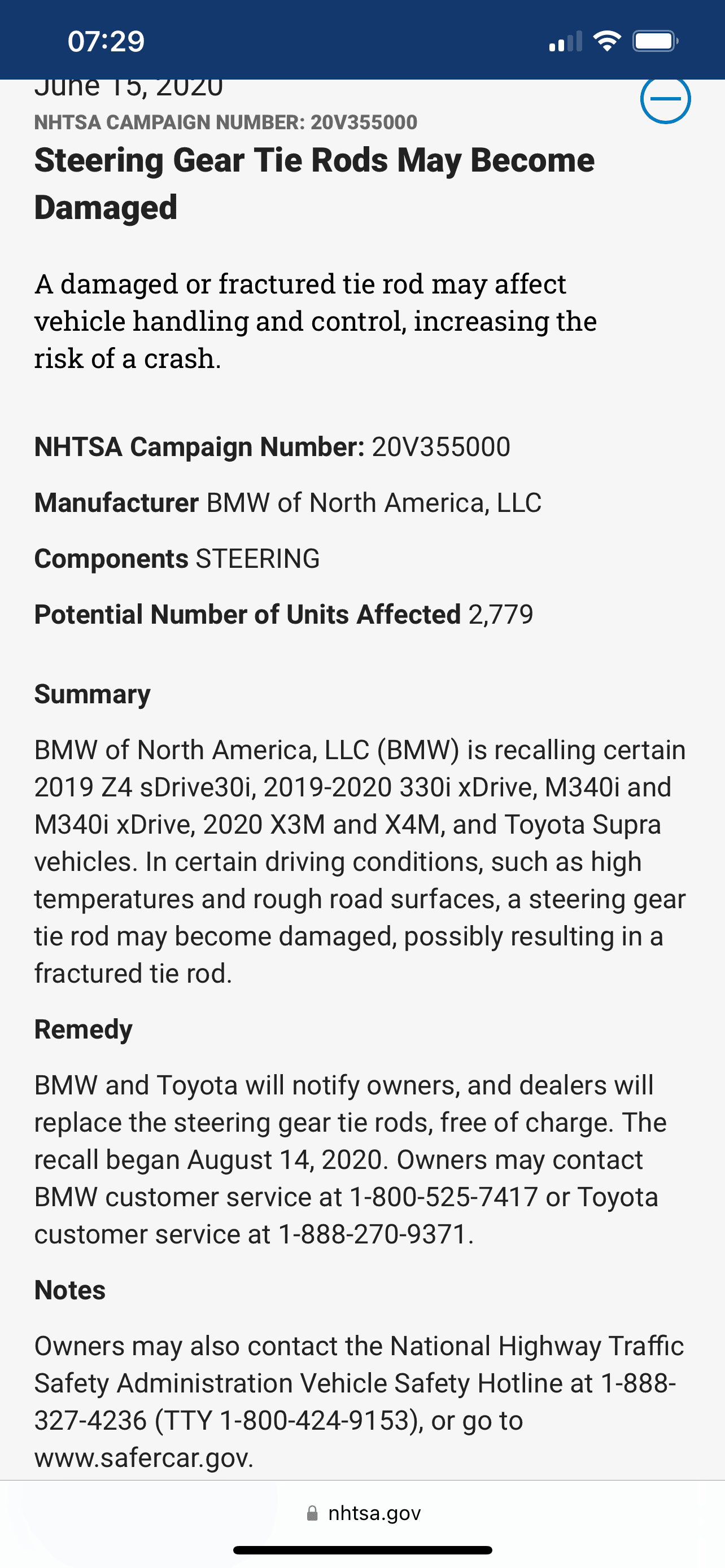

I’ve read this whole thread but can’t remember, did anyone mention this as a potential culprit? This was from the NHTSA website

@Cptnslo - It probably is.. did the OP ever fix his car?
