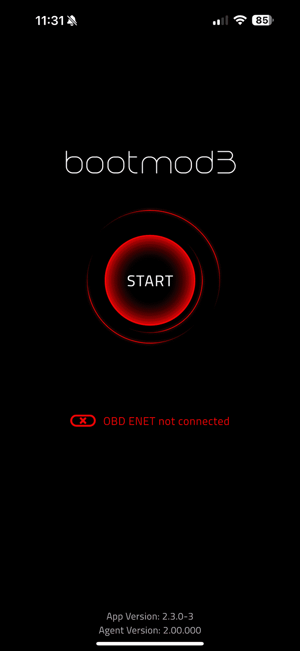

I have the WiFi adapter but when I plug it in and connect my phone to the bm3 WiFi and then open the app the car never connects

Make sure you aren't connected to carplay. In fact sometimes you need to delete the phone from the car. I actually am fortunate enough to have a second iphone I use for BM3.
Also, some people have luck forcing the IP addy, but I never did.

I’ve done all of that including using my wife’s phone and nothing, the Manuel IP didn’t work, simply trying to connect to the adapter WiFi didn’t work and I have delete my phone from the car play

Are you able to connect to it via the WIFI selection in iOS?
8,852
17,340
Yes but when I open the app it will not link my phone with my car
When you go to the wifi adapter menu item in the BM3 app (after hitting the circle on the launch screen), does it come up as connected to the adapter?
That is how I know it's connected to the adapter and shortly after you will see the icon in the top right turn green. Sometimes it takes awhile.

No it never connects even after leaving it for minutes at a time

Have you tried "forgetting" the adapter from the wifi iOS screen and deleting the BM3 app, reinstalling it and also hitting "reset defaults" in the About screen?
Sometimes the BM3 app just decides to stop working for me and I have to do those things. It's annoying but it doesn't happen very often.

So I stopped trying with the WiFi adapter and switched to a cord and I can’t get the cord to work either

I think it had something to do with me having an iPhone 15, Bootmod3 support had mentioned that phone giving them problems so I used my adapter and ENET cord on my pc and it worked! Shows that I need a bench unlock since my ecu was built in October. Just ordered the mission tuning unlocked! I’m getting my exhaust, down pipe and cold air intake installed on Wednesday so I can’t wait!!

Great, glad you got it working. Mine said unlock needed as well but it flashed just fine. If you didn't have the recall done and don't have full screen carplay you could probably flash it just fine. If you do have full screen carplay, then yea, you need an unlocker.

I do have full screen and I called my Toyota dealer and they told me they did do a brake recall but there is another one that they haven’t done, I did get a letter for a brake recall recently

I used the mission tuning unlock tool and it showed that the dme was successfully unlocked, I have yet to tune the car because I’m getting a new battery first but I did plug in my laptop to check out the BM3 software and it did still say bench unlock required. I was curious if bm3 would still say that even after the unlock or should it update since I did the unlock?
