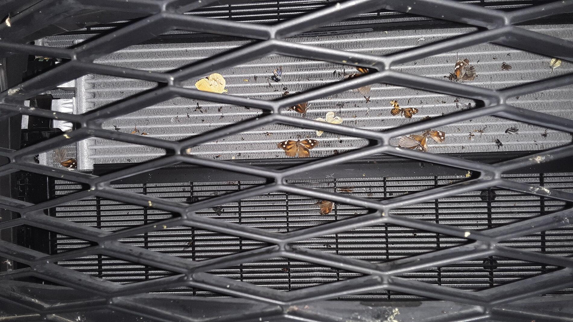

Did a long trip today, and the bugs were out in masses. What's the easiest way to get them off the radiator and or condenser.

Pressure wash them into oblivion. Pretty much the only way without taking the front bumper cover off and picking them out one by one.

Yeah, got a pressure washer, I'll surely not use high pressure, low pressure so I don't flub up the radiator. Thinking bout fabricating some type of screen to slip on for long trips.

Pressure wash more than likely may push them into the fins, allowing less air thru and possibly damaging the fins along the way if directly applied. Not easy to do it at an angle unless you remove things.
Compressed air on an angle would be better imho. There are also chemicals for it bug remover etc..

You're going to have to pick it off one by one without distorting the shape of the fins. It's tedious work. I would not use high pressure to clean it as direct hit will push the crap deeper info the fins as xtreme noted above.

How about a shop vac with a crevice tool attachment?
Crevice tool wouldn't go between the plastic to get back there. I used light air, and hose with nozzle. A few off the fines on the upper what ever, I think trans cooler flattened a little. What ever that little rectangle cooler is, dosen't take to much to hurt it.
