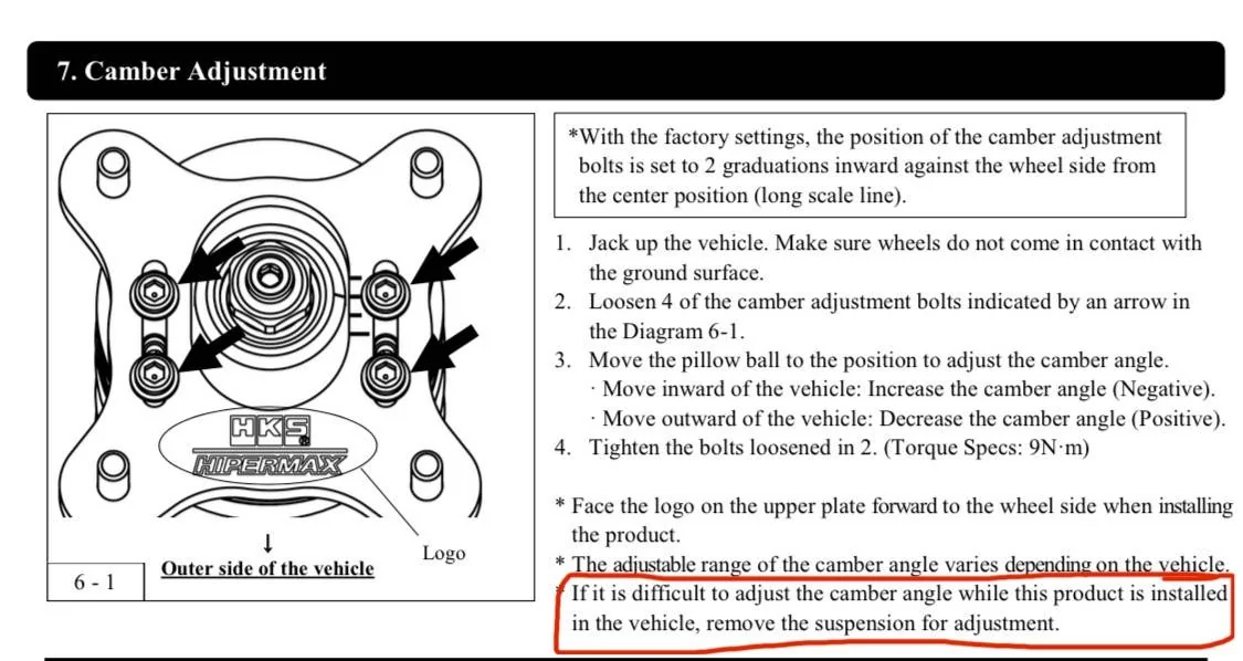

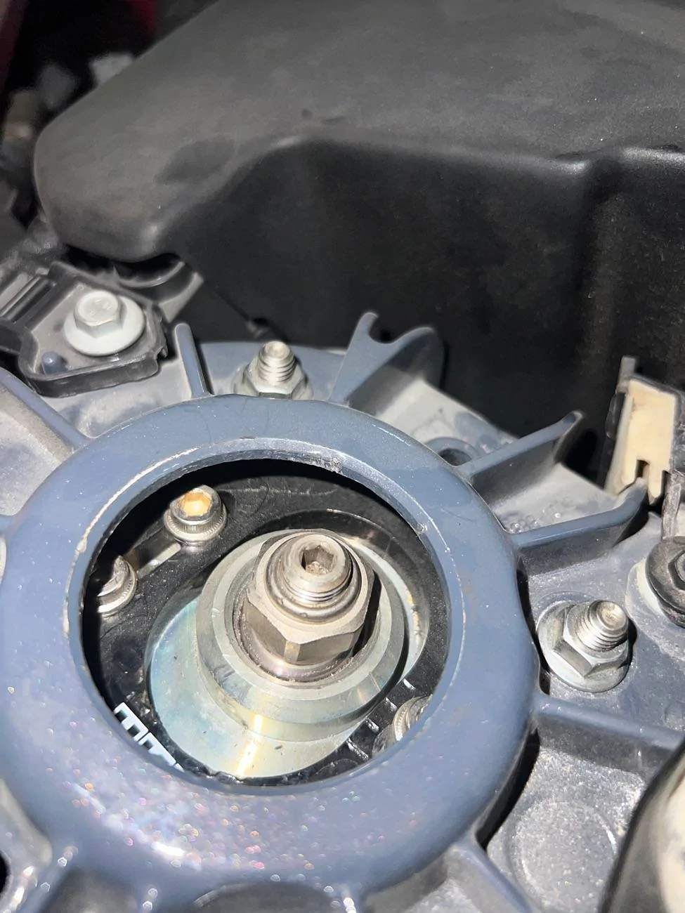

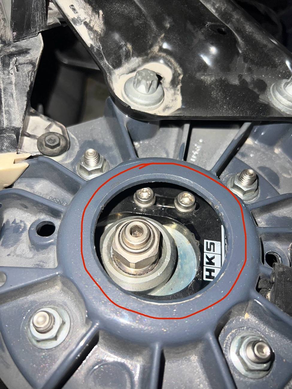

if you’re talking by mm then I would say 5mm is the correct size for HKS camber bolts. I wrote 3/16 so most of the people here in this forum using Amercian chart sizes, so I wrote it in American chart size to not get them confused. BTW, 5mm would work well for the HKS camber bolts and I tried it.
Ya but American sizes arent the same as metric. You cant use a 3/16" allen for a bolt designed for 5mm allen. The car and all its components are metric regard less if the car is here in America.

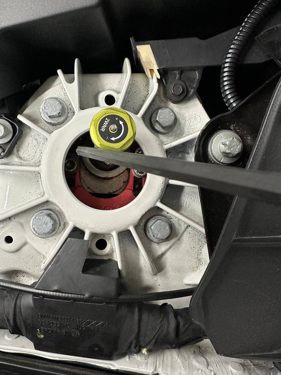

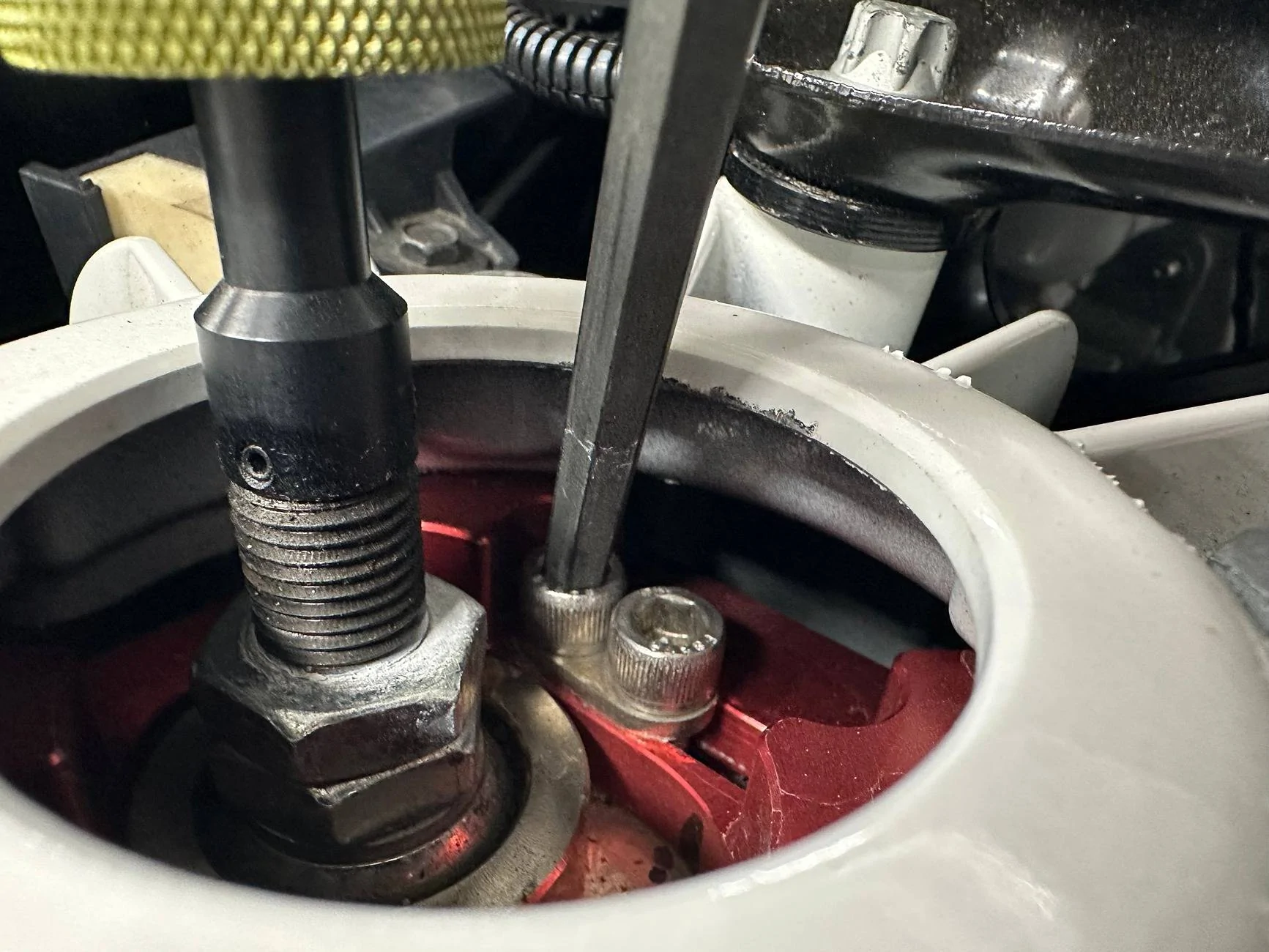

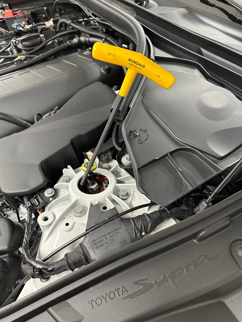

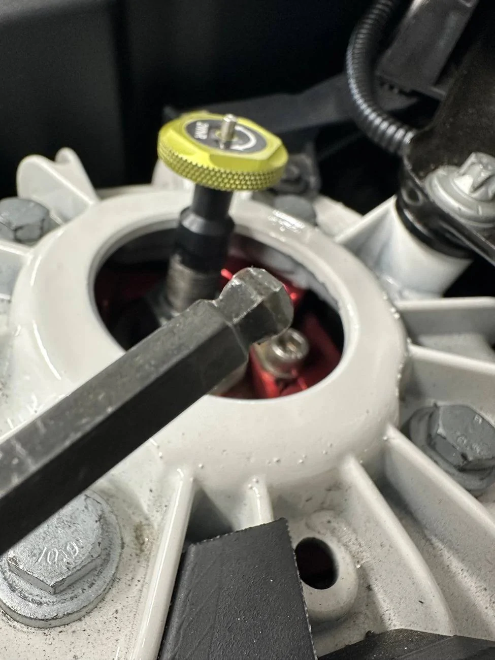

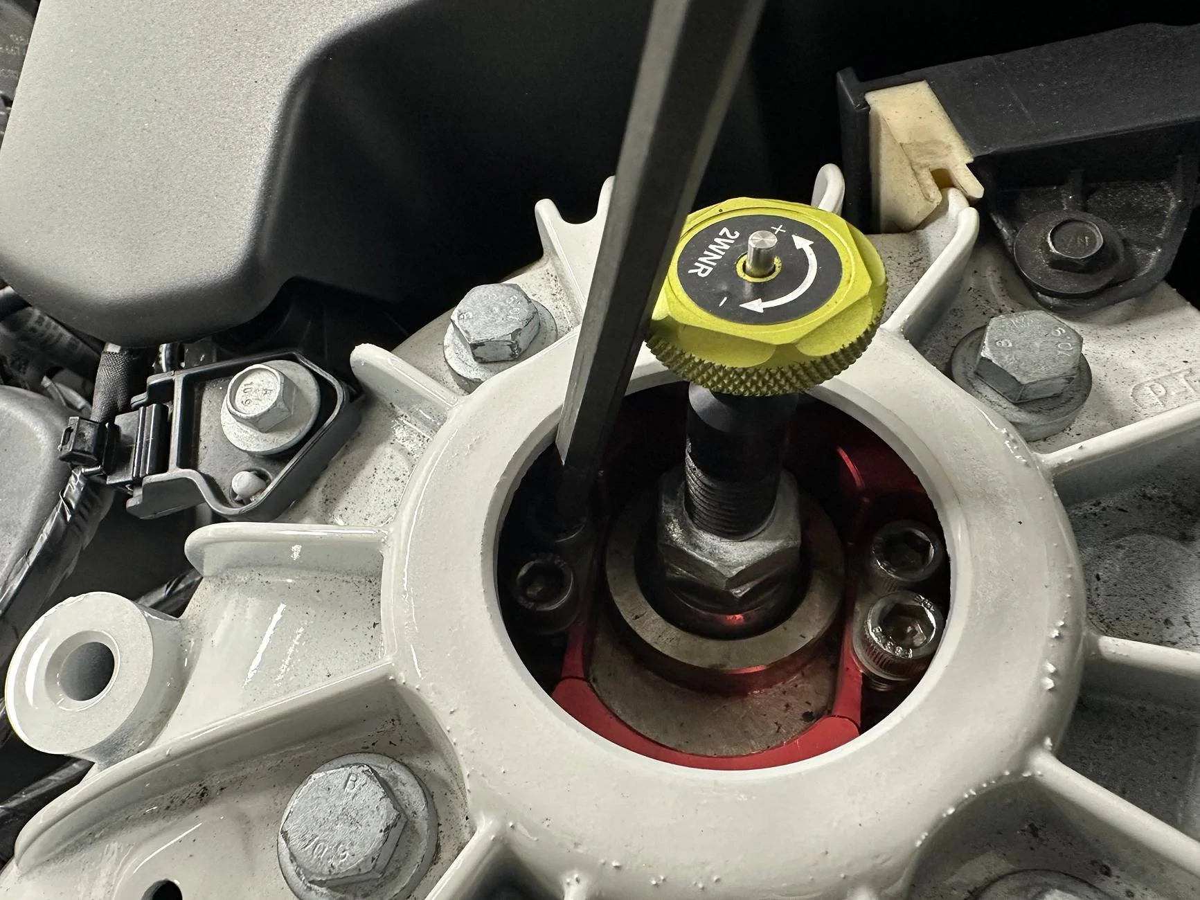

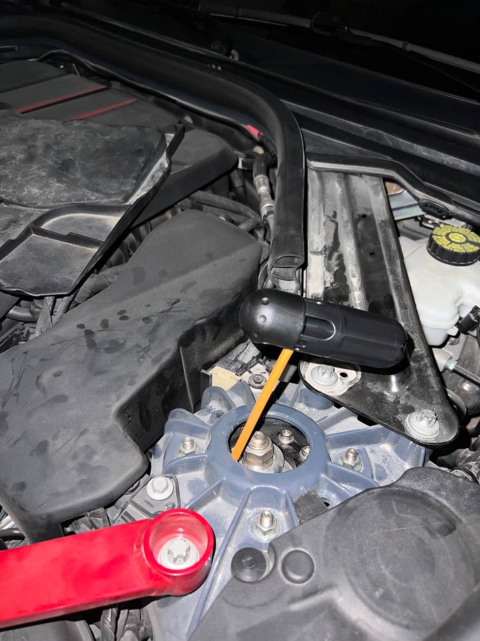

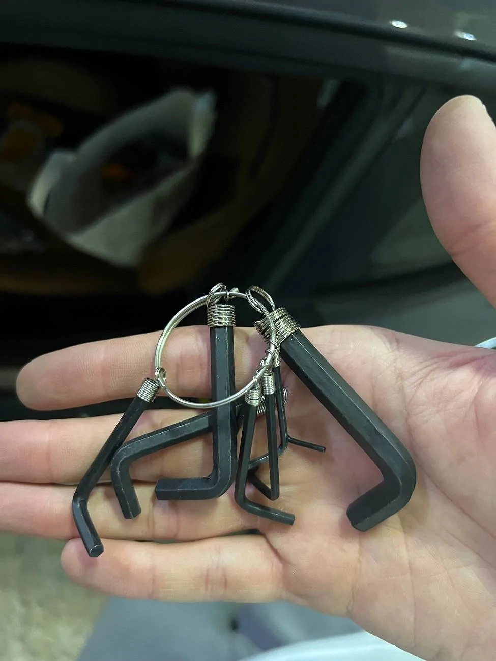

Yesterday I adjusted my camber bolts by using these tools and did the alignment at the shop.
I marked both of them in red color
I have both of these sets, and both of them worked great. I used the first photo screwdriver. BTW, You can loosen the bolts without jacking your car.

5mm = 5mm. 3/16” = 4.78mm. Yes it will work. No it’s not right. Using a ball tip Allen wrench is only asking for a stripped bolt if using the 3/16”. Some top hat bolts are button head style bolts (normally a 4mm Allen) and those, especially stainless ones, strip like no other if you use the wrong size socket.
