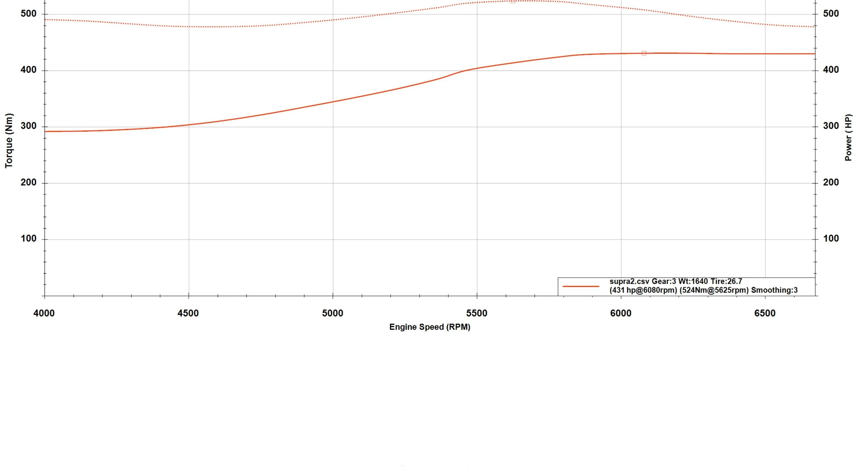

I'm not really familiar with the BM3 protocols (I use MHD), but there is a strange thing – at least for me. Your MAF value peaks at 1020kg/h and then stays there for the entire protocol, which is, impossible.
So imho there should be an error with the logger or with the MAF sensor. ( or maybe you are using an air intake, which is not OEM)
You have 1020kg/h which is about 283g/s, and it’s is realistic at 5300rpm ( that should be about 370hp at that point). But with your estimated power of about 420-430hp it should be at 1200kg/h at higher rpms, and this is not the case.
I checked your "times" from the log and you reach 100-160 km/h in 4.28 seconds (in real life it would be a bit longer [~4,5]as these values are speedometer values and not GPS).
That would be around 9.0sec 100-200km/h, which is realistic with a Stage 1.
When I had 422 hp on my Z4, that was about the same time.
I tried creating a virtual dyno run using your logs and it appears to be the same (~430hp). I assumed your fuel tank was full and so the weight is about 1640 kg and that you measured without any slope..
If you could upload a full log in 4th gear (2000-6800 RPM) I could create a better graph.
You started WOT at around 4000 rpm and the turbo needs time to ramp up, therefore is the torque too low at ~4000 rpm..
You car is the 340hp version, right ?

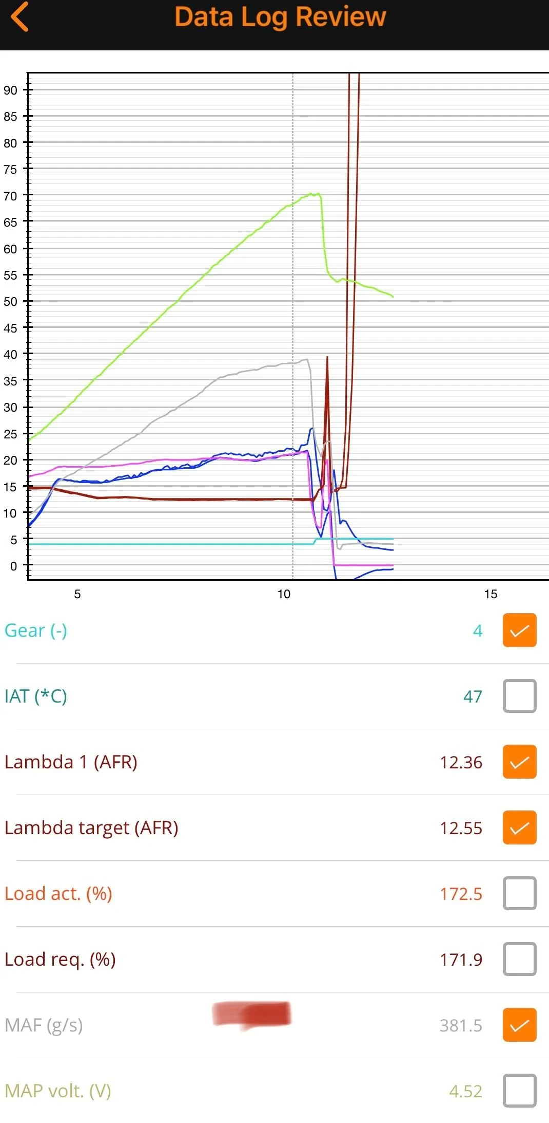

That is interesting. This is a sensor value and should show the reality. You could even calculate the approximate power from this value (MAF g/s multiply by 1.25-1.3 depending on the AFR value).
In my MHD log with Stage 2 OTS I see MAF values over 380g/s, which corresponds to 1368 kg/h.

If you have the 383hp version then there is something wrong.
The factory spread should be within the 5% limit, i.e. in the range 360-400 HP crank.
The BMWs are more like +5%, so let's say you should have about 400HP without tune (I don't want to start any discussion about WHPs from dynos with optimistic readings here!)
What I can see from your log is just a small plus, but a Stage 1 should be stronger ( +30HP and only in the upper range).
That's why I have a stupid question: Is it possible that you don't use xHP or some other transmission tune?
Because in your protocol there are 3 torque values, one is different from the other two. I created a chart for you with the values from your log.
There you can see the two values. I think the orange one is what you should have. That would be around 680 Nm and 472 HP@6200rpm (that's what I would expect from a BM3 on your engine ).
The blue line corresponds almost 1:1 to the values that I generated from your log in my previous post ( I mean the dyno chart). There is a peak of 432HP@6200 and my log told 431@6080,
As you can see, the torque seems to be limited in the 500 Nm range.
So I would guess that your tuner is trying to produce more power but your TCU is limiting this.
Is it possible to flash back to Stage 0 (~Stock) in BM3? I would be really interested to see what a standard log looks like.
