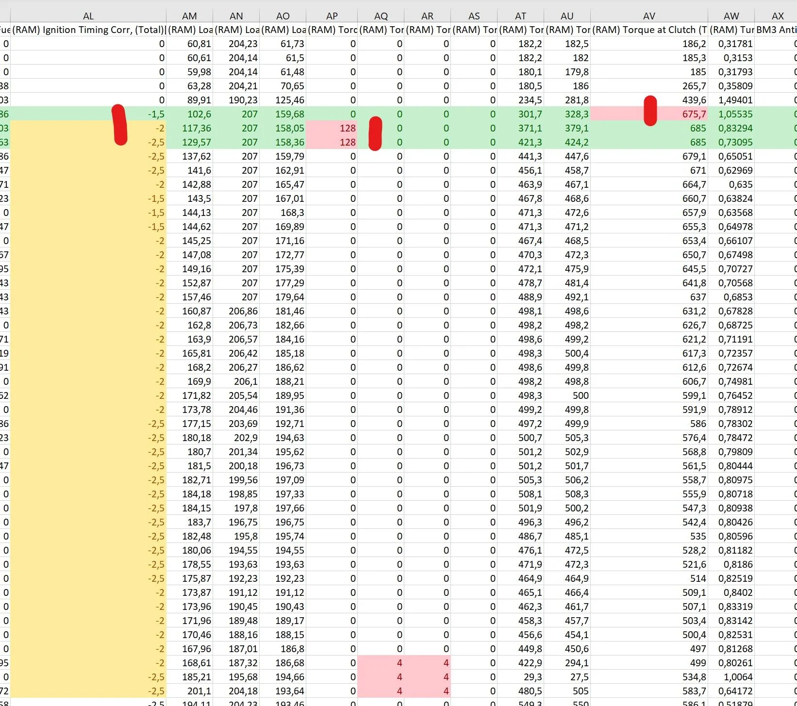

Can you help me diagnose a log?

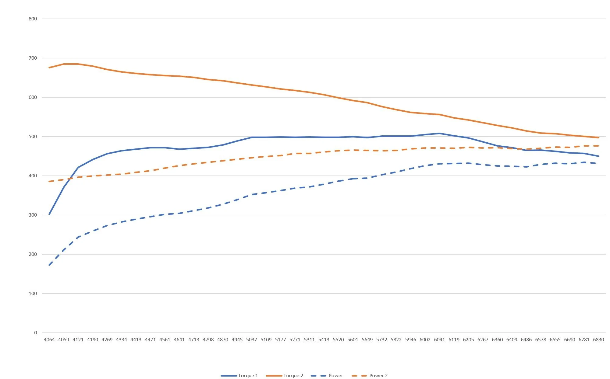

What I can see from your log is just a small plus, but a Stage 1 should be stronger ( +30HP and only in the upper range).
That's why I have a stupid question: Is it possible that you don't use xHP or some other transmission tune?
Because in your protocol there are 3 torque values, one is different from the other two. I created a chart for you with the values from your log.
There you can see the two values. I think the orange one is what you should have. That would be around 680 Nm and 472 HP@6200rpm (that's what I would expect from a BM3 on your engine ).
The blue line corresponds almost 1:1 to the values that I generated from your log in my previous post ( I mean the dyno chart). There is a peak of 432HP@6200 and my log told 431@6080,
As you can see, the torque seems to be limited in the 500 Nm range.
So I would guess that your tuner is trying to produce more power but your TCU is limiting this.

My car is 6/2020 with the 6 port
So it’s the 383 Hp version and I didn’t need to send the DME to femto.
My tune is OTS stage 1 with map switching, limit remover and etc

Then you are one of the lucky ones.
But if you have CustomROM with limiters removed and fully customized software, then you shouldn't have any limit codes, right? There is eg. code "4" at every gear change, which means that the gearbox requires less torque from the DME to be able to shift up cleanly (or to avoid a slip when declutching). However, I don't think BM3 has partially reprogrammed the TCU like xHP. I think they have rather removed the limiters to be able to work cleanly with the tuning.
Here you can see the codes :
https://ecutek.atlassian.net/wiki/spaces/SUPPORT/pages/469270529/BMW+Limit+Flags+States
But upload the log in 4th gear if you have it, I would be really interested now what it shows.
