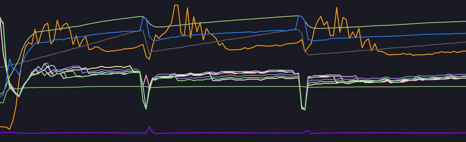

I recently changed my spark plugs, and the car threw this code. After turning the car back on, it ran perfectly. I double-checked the plug gaps, reinstalled them, and did two logs. Could someone take a look at the logs and let me know if something looks off?
Current mod list: Catless DP, MST intake, flex fuel kit, and running a custom E45 map. First Log
Second Log

What’s so bad? I’m not too knowledgeable on the tuning aspect of these cars.
AFR way too lean, boost out of control. Way too much timing. On and on.

Ah okay could you take a look at this log? Talked with my tuner and he sent a revision. Car feels better but I’m not 100% sure how it looks on the data aspect. New log
8,771
17,207
Trending better. AFR is much better. However, you didn't go WOT so hard to judge.
