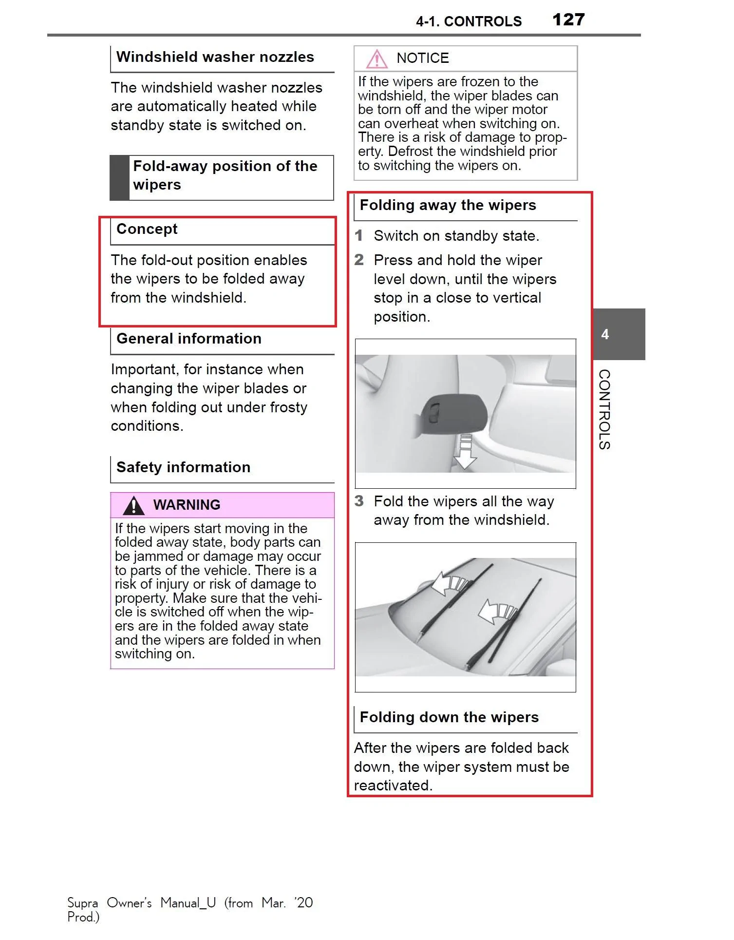

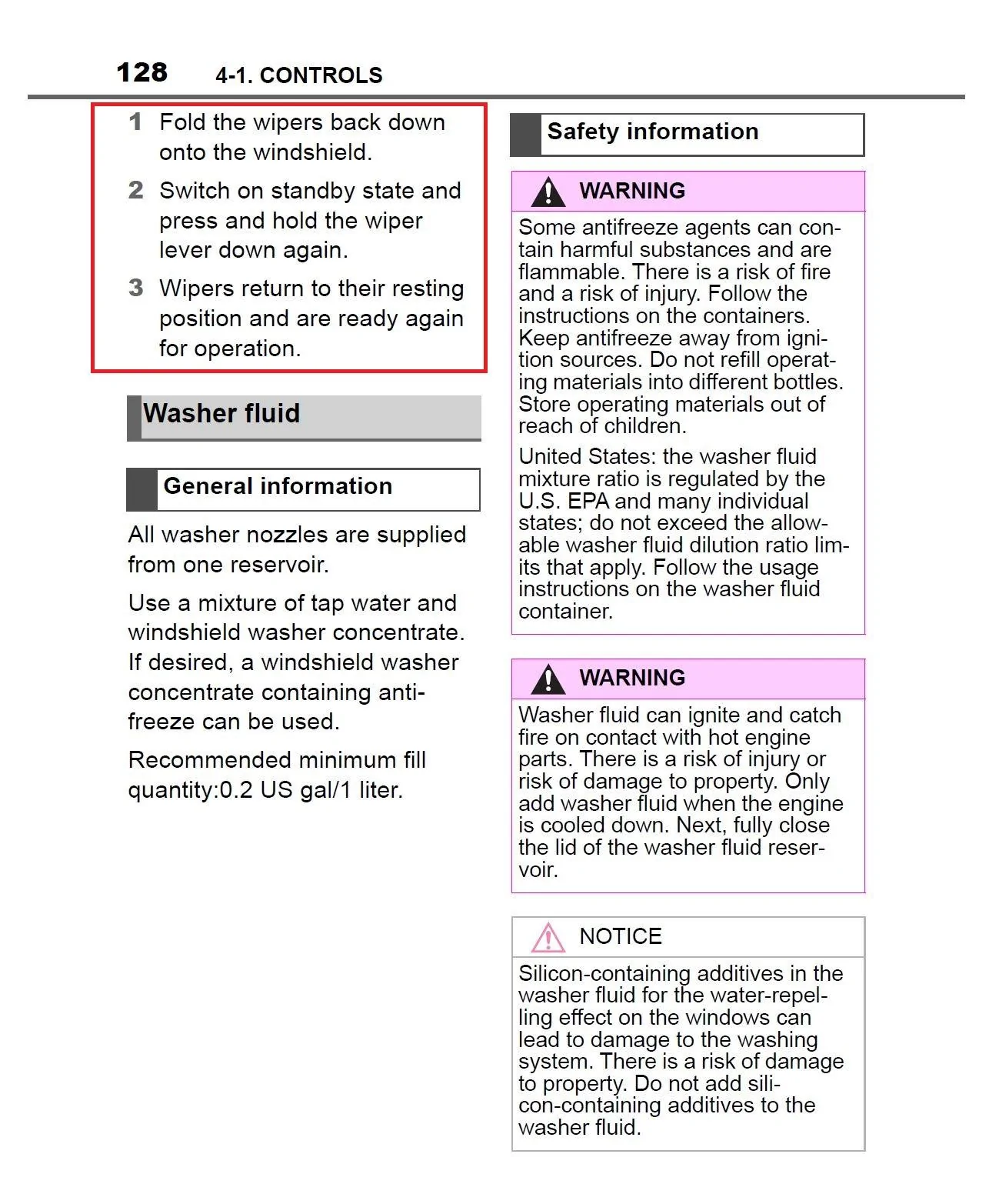

For reference, here is the procedure for positioning the blades to change (note, they cycle 3 times so prob a good idea to wet the windshield if it is dirty):

To save someone having to go through their manual for the replacement procedure:
  • Put car in standby (basically just open the door and sit in the car without hitting the start button)
  • Hold the wiper stalk down (towards the ground) for 3-4 seconds. The wipers will move into straight up and down position. Fold them out from the car.
  • On the stock wiper blades you will see a button on the top. Press it and pull the blade straight out from the car. It should come out with a little jiggling.
  • For the Bosch blades I purchased you can use the adapter that came on the blade. It came with 3 or 4 different adapters. Just push it straight on the stalk until it clicks. Note: The driver and passenger side are slightly different lengths. Make sure to compare before you try to stick it on there.
  • Fold the blades down against the window. Go in the car and hold the wiper stalk in a down position until it goes back under the hood cowl.
  • Voila, done.
