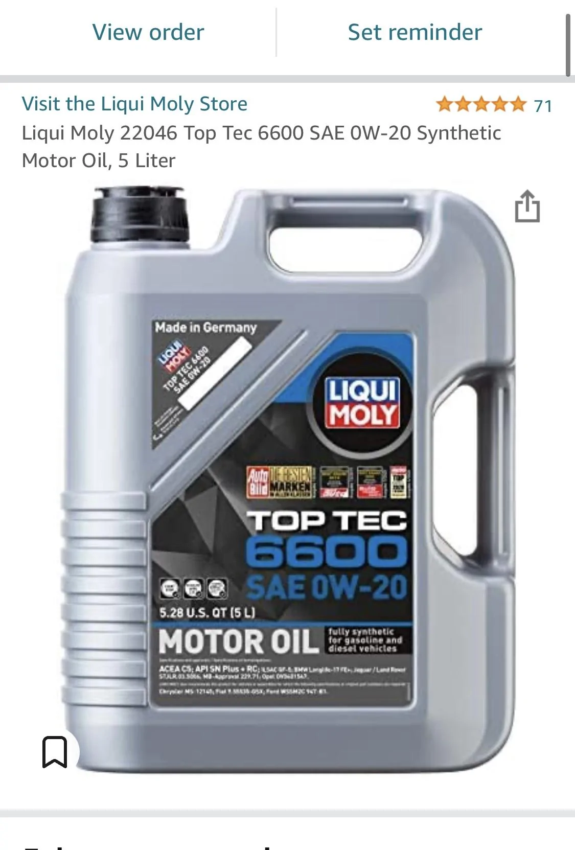

After changing the oil to the newest generation of 0w20 the shakes on startup are completely gone, or at least I didn’t notice them anymore.
Tested on a few cold starts from 30-50 F
so it could be related to lspi
can really recommend the engine oil it’s Liqui Moly TopTec 6600, for the states it should be Special Tec AA
This is what I use ?
