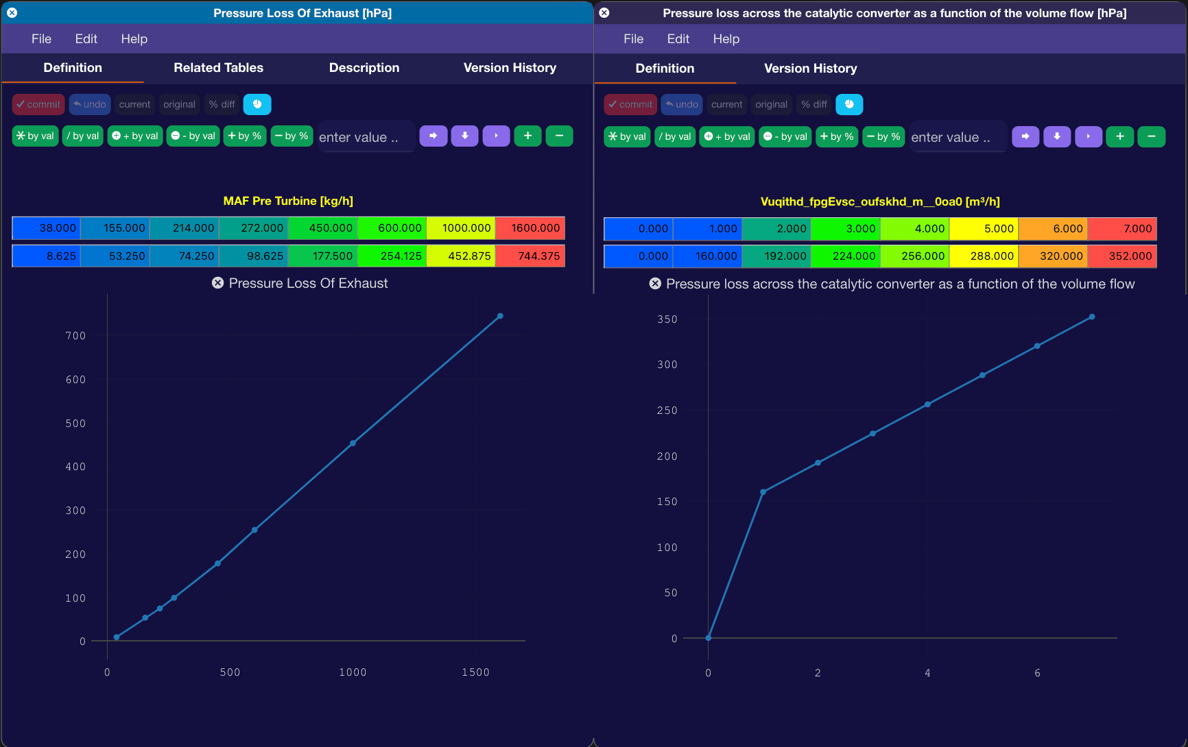

The ECU is torque/load target based, not PSI target. PSI level can change day to day, hour to hour.
There are some tables in the ECU that basically shows pressure loss in the exhaust system. If you don't tweak those tables after taking the cat out or adding a free flowing exhaust, the boost can raise.
