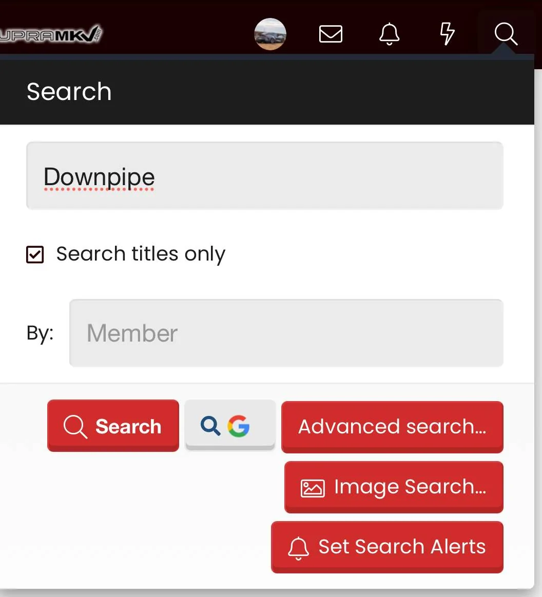

I don't think has ever been asked before, so the search feature built into the site may not help.
