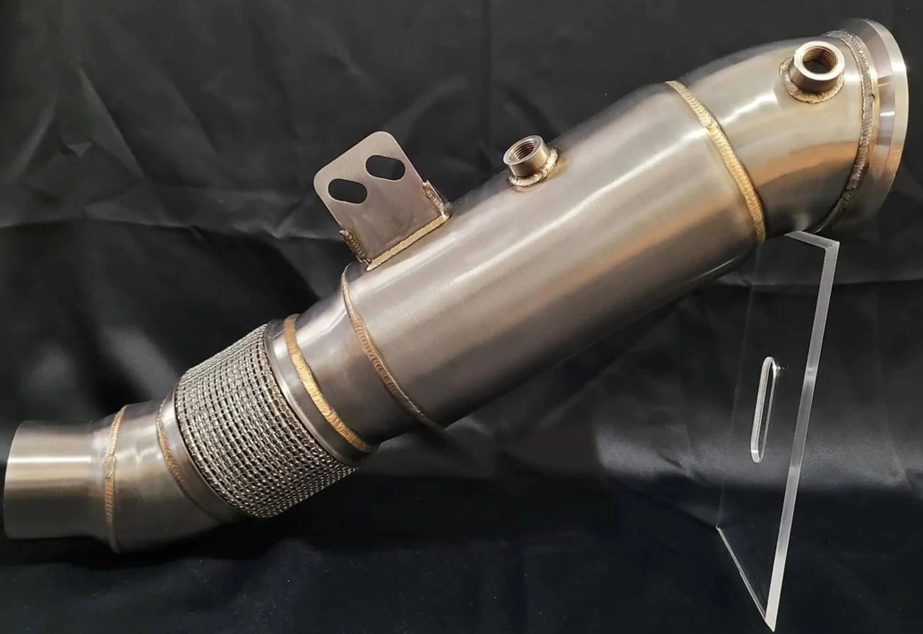

Hello everyone. What good options are there for DP with 200 cell cats. Thanks
Cg precision is a proven dp with an 5” top section, this dp was my top choice but i recently came across another dp im highly considering made by LOGOS called MONSTER SERIES:Ultra High Flow 5" Catted Downpipe. This is the only 200 cell dp with the longest 5” barrel I seen on market (rather than just a portion of the pipe) but not alot of people are familiar with the brand on this platform. They are well known on the mercedes and audi platforms tho

I'd be curious what cat they use as a GESI cat alone would cost more than $695.

GESI is over expensive. Other brands are way less. A 200 cell cat is going to cause a CEL anyway. As long as it can take care of the fuel smell I'm okay with it.
Exactly my thinking brother. Plus you can go femto unlock custom tune so CEL will not be issue as you can disable the sensor… atleast those are my plans anyway lol

GESI is not 200 CEL, its 400 CEL
the flash tune hides the code, you will still fail emission testing so if thats a thing in your state, the GESI cat is worth the investment since its EPA approved

For me thats all the more reason to not go with GESI.
You can get the Fabspeed 200 CEL HJS downpipe, but its even more expensive.
leen in mind the Gesi cats used in the Active Autowerke downpipe are rated at 950 HP, so if you are not even close to that power level, there is no downside to going with them
