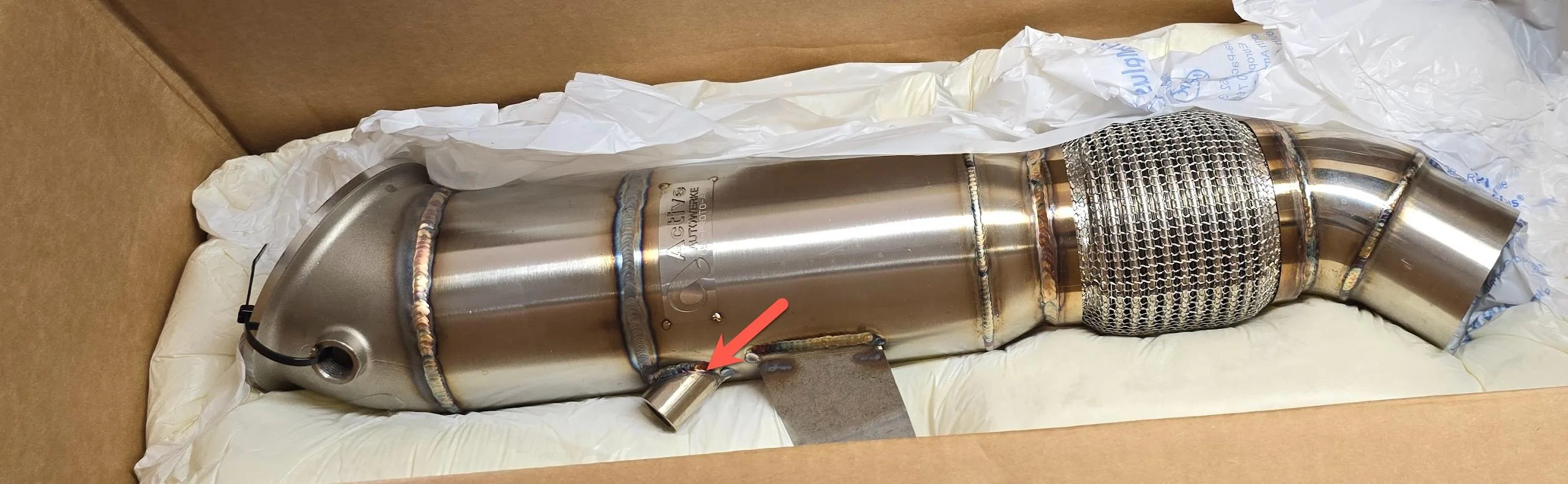

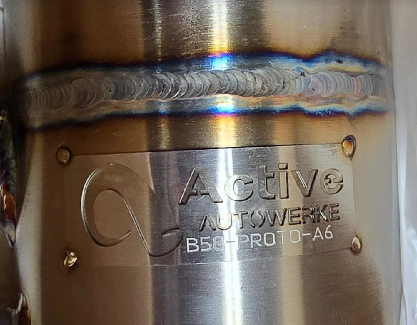

I recently installed a active autowerke down pipe. First one produced a CEL (catless down pipe detected). They RMA'd that and sent me a newer one, a proto type of sorts and is labeled as such (see photo), but this one has a different O2 sensor port, angled differently than the previous one (see photo). My problem is that I am now getting a different CEL that says: 12b701 lambda probe heating after catalytic converter. resistance too high

I have delt with this code for a while. It is due to the secondary O2 Sensor extender on the downpipe.
So what's the fix, if any for this specific downpipe?
The only fix I can see is to get that O2 bung to the same length and angle as the stock downpipe. i have notice some supra are just more sensitive with that O2 sensor code. Mine being one of them.
