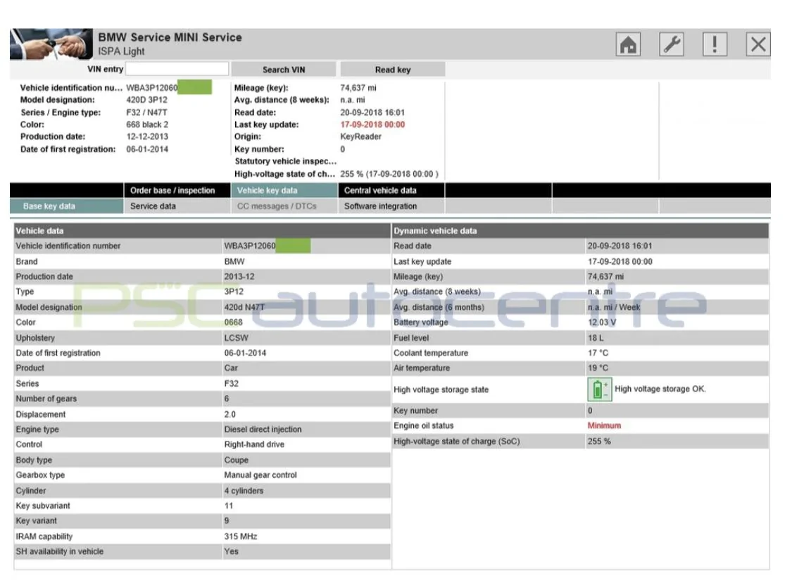

I wouldn’t drive it until it’s read. Your dealer should be able to scan your key at any BMW key reader they can view most DTCs.
