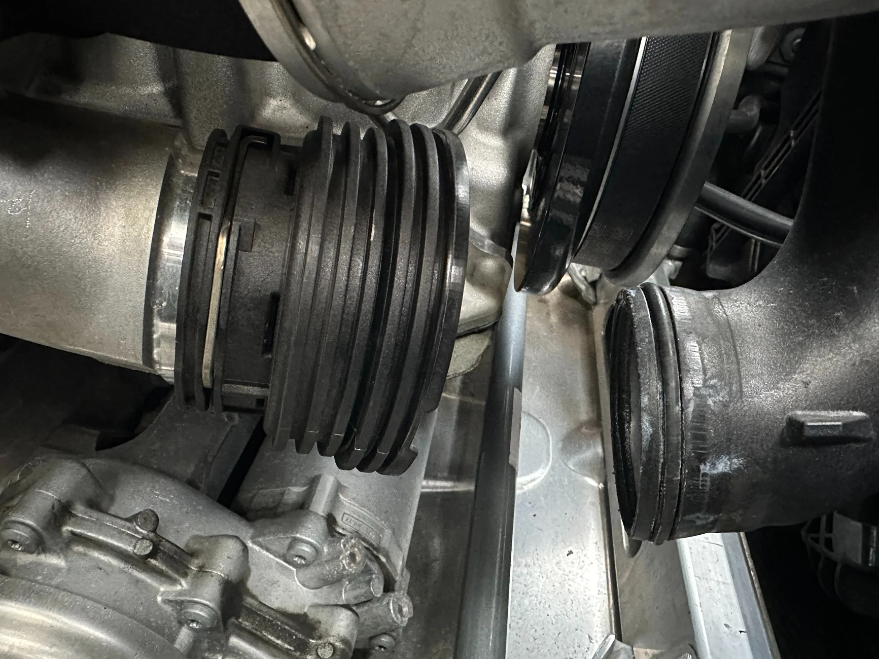

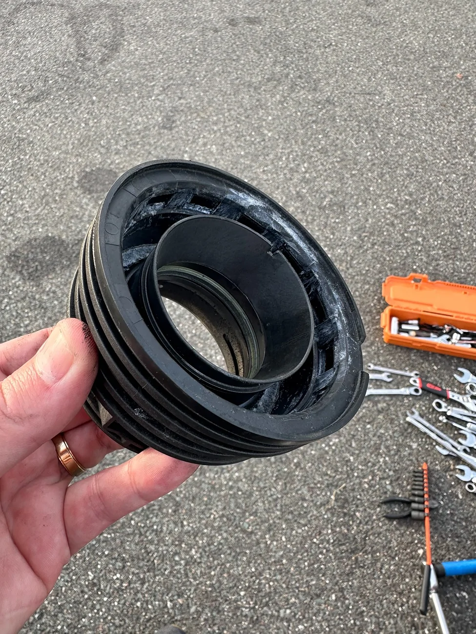

My charge pipe was fine for basically 60+ track events, 40 of which was on a larger turbo with up to 30psi out the top of the rev range. Then one day it decided to not be okay with it and it blew itself apart on track.
