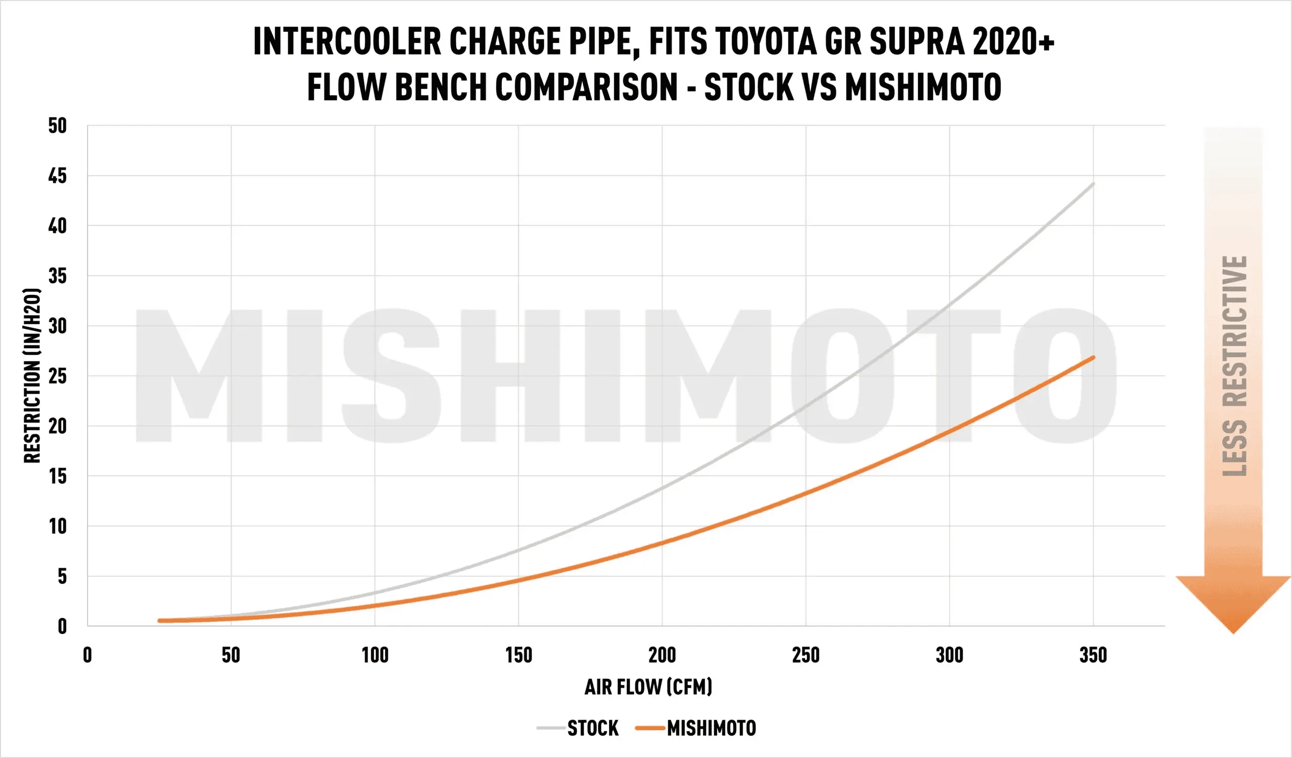

Not advocating Mishimoto's chargepipe, but they had some data.
I'm sure its a good pipe, but have no experience with it.
https://www.mishimoto.com/engineering/2021/06/toyota-a90-supra-charge-pipe-production-sample-2020
Ok, so let's convert this plot into layman's terms. First, let's figure out what the typical output is from the stock turbo. Since the stock turbo has a compressor inducer of 50mm, this is roughly equivalent to the GT3076 which has a compressor inlet flange of 51.8mm. Looking at the GT3076 compressor map, the 74% efficiency island has a right edge of ~40 lb/min. Let's just go with this for now - most of the time stock turbos are undersized, so you'll running further to the right when you turn up the boost.
From there we need to know what is the uncompressed volumetric flow rate. Let's convert.
40 lbm = 18.1 kg
air density @ STP = 1.225 kg/m^3
1 m^3 = 35.3 ft^3
18.1 kg * (1 m^3/ 1.225 kg) * (35.3 ft^3 / 1 m^3) = 521.5 CFM
Now, that volumetric flow is uncompressed. The air in the charge pipe is compressed. What is a typical boost pressure? According to this post, stock ECU map has a limit of 2.5 bar absolute (1 bar = 1000 hectopascals). Since this is a limit, let's round down a bit for sake of argument.
2.4 bar absolute = 1.4 bar gauge = ~20 psi gauge
Now that volumetric flow we calculated was uncompressed. How do we find the new volume? Let's assume an ideal adiabatic compressor which means no heat transfer in or out, and a compressor at 100% efficiency.
p1 * v1^gamma = p2 * v2^gamma
1 bar * 521 cfm^1.4 = 2.4 bar * X cfm^1.4
X = 278 compressed cfm
On this map, let's lookup the pressure drop at 275 cfm. 27 inH2O -> 16 inH2O. Converted, 0.067 bar -> 0.039 bar.
Since the ECU will target maniform pressure to be the same, this means the compressor outlet will be slightly higher to compensate. Let's quantify the additional delta-T which comes from the work done on the air. By using the adiabatic equations again, this time targeting P and T:
P1^(1-gamma)*T1^gamma = P2^(1-gamma)*T2^gamma
For both conditions, P1 and T1 will be room temp and sea level (give or take). P1 = 1 bar, T1 = 25 degC = 298 K. We will try P2 with 2.467 bar and 2.439 bar, and compare the T2's.
if P2 = 2.467, T2 = 385.7 K = 112.5 degC
if P2 = 2.439, T2 = 384.4 K = 111.2 degC
Therefore, we can conclude that for the stock turbo, the decreased pressure drop will reduce compressor outlet temperature by ~1.3 degC. While the real number will certainly be different, the exercise here is to show that you can either be roughly right or precisely wrong. All estimates are on the correct order of magnitude, so I expect my estimates to be 20-30% wrong.
Edit: yes, I know that there are estimates on how to estimate flow rate based on target whp. I avoided using that rule of thumb. We ended up in the same ballpark anyway.
Edit 2: did I expect the results to be more substantial after investing all that time writing it up? also yes.
