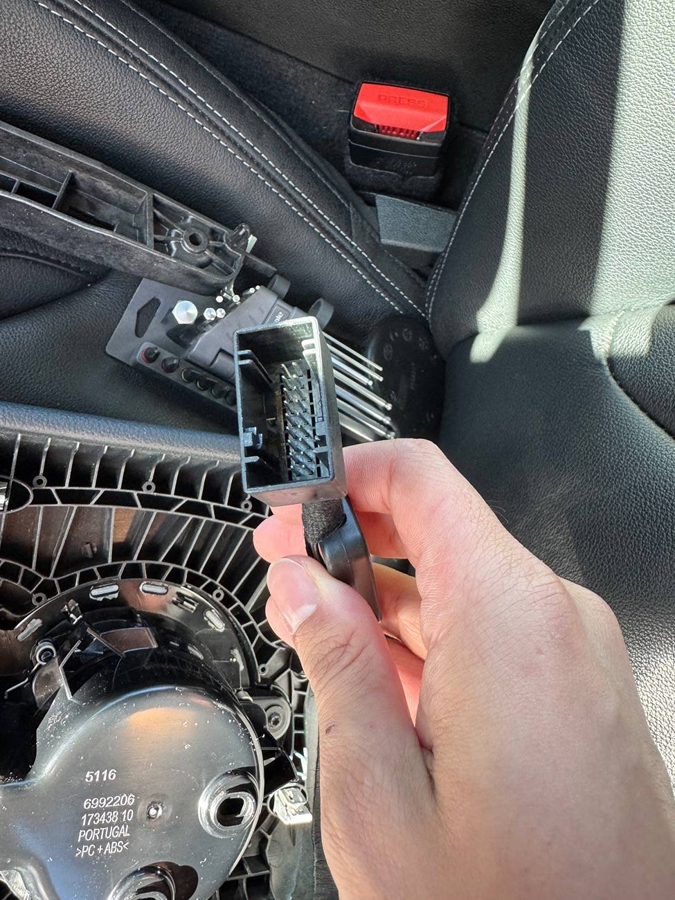

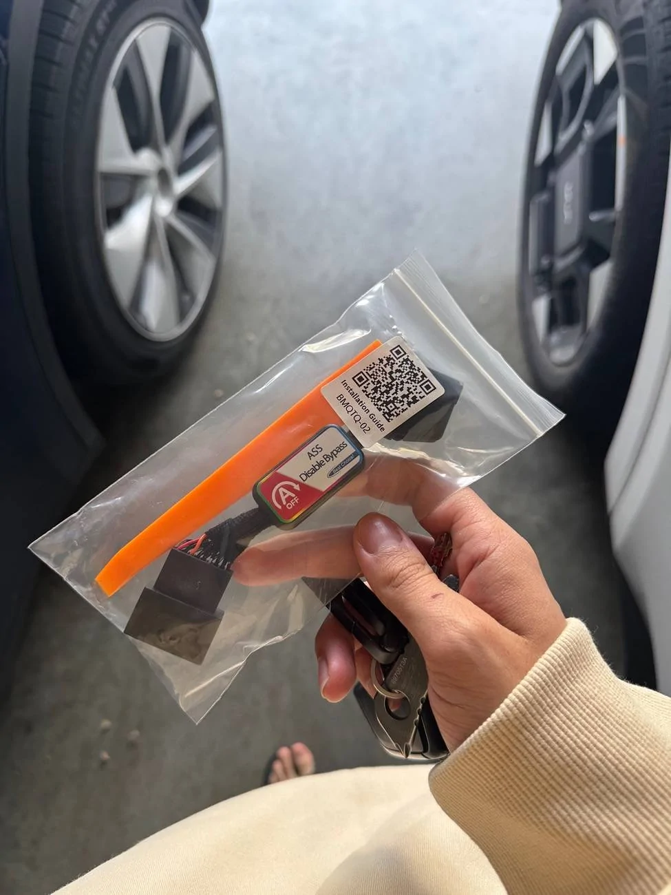

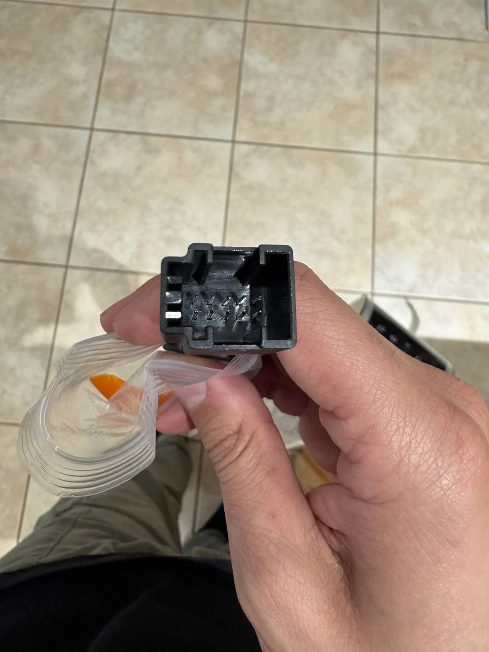

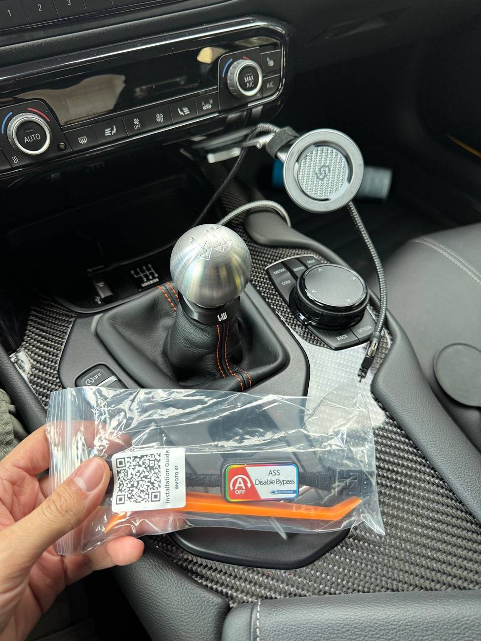

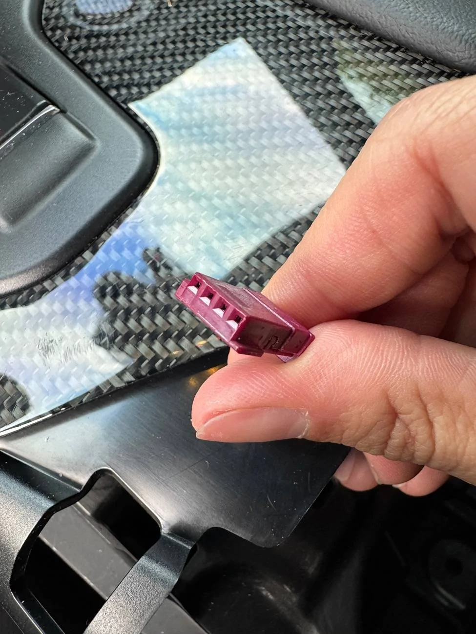

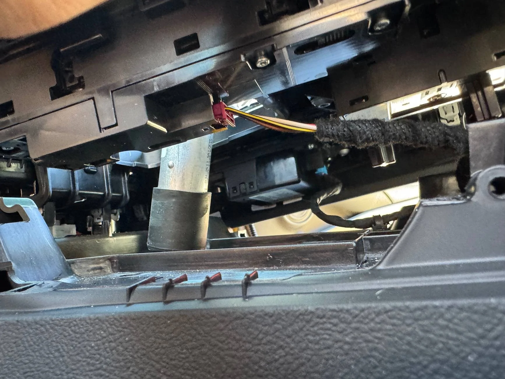

Update: there is no plug under there that matches the disabler. It looks like there’s a different plug for the section of buttons that includes the auto stop/start.
Fortunately, the console was easy to disassemble and took less than 10 minutes.
I am mildly disappointed lmao
