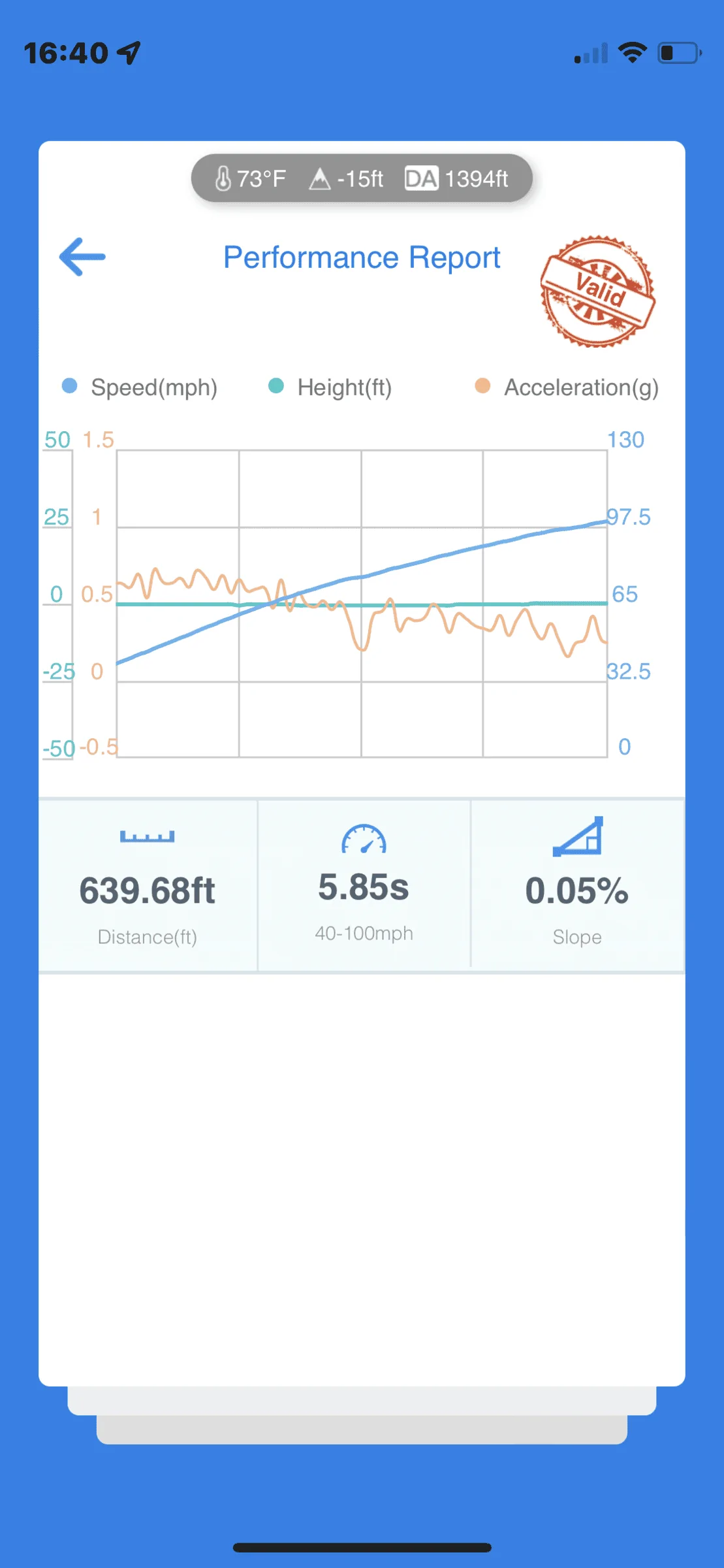

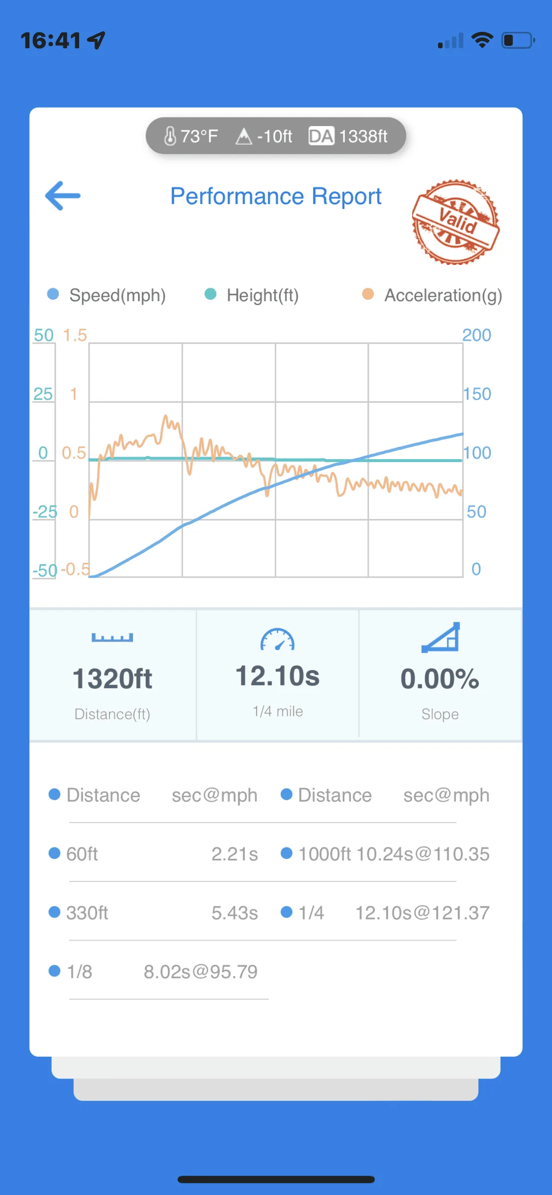

Comment on my times… 22 A91 JB4 dragy
8,473
14,120

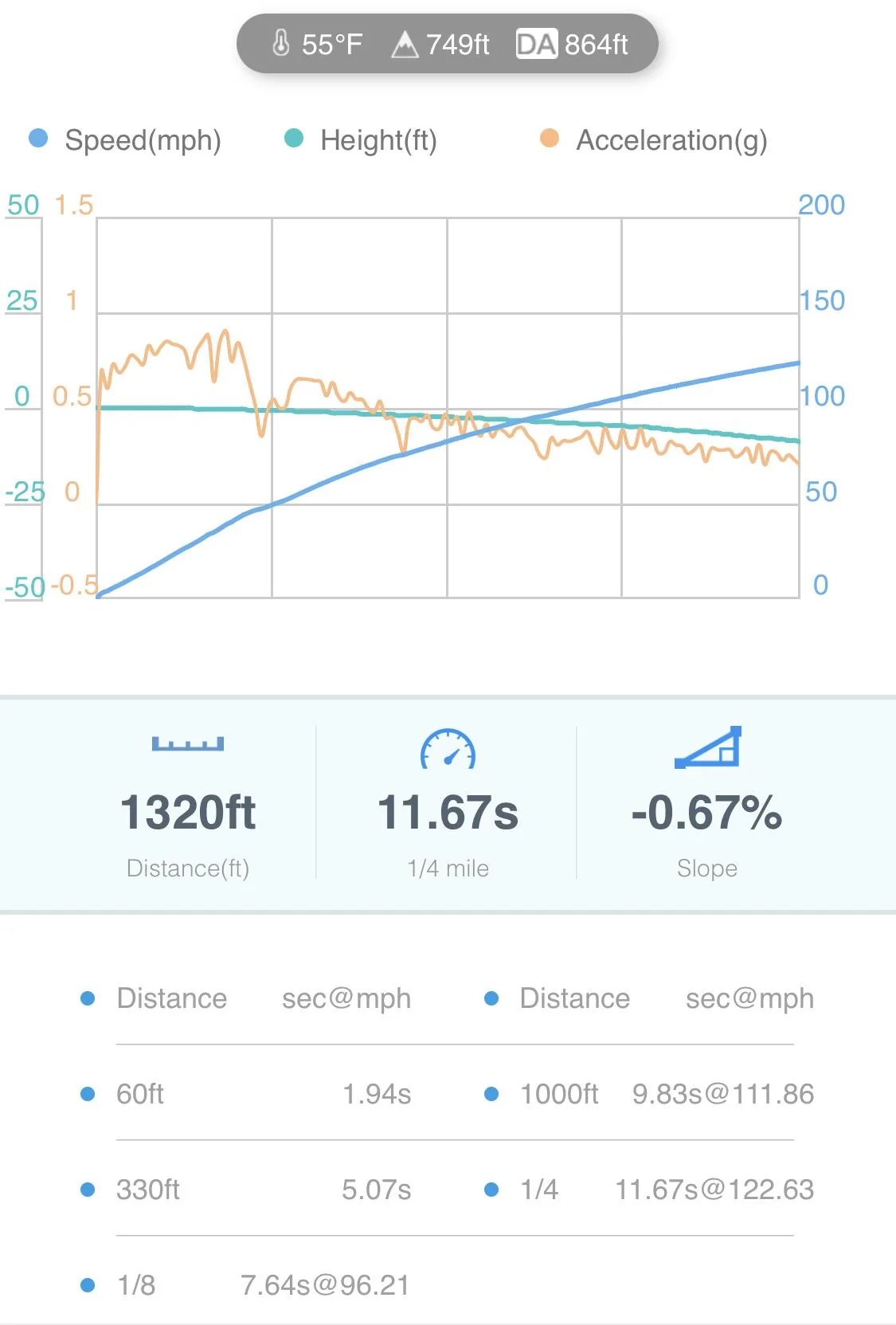

Should be able to do better than 12.1 with that set up.
I am running 11.85-11.9 on the street with only an Ecutek tune, rest is a 100% stock car on pump gas.

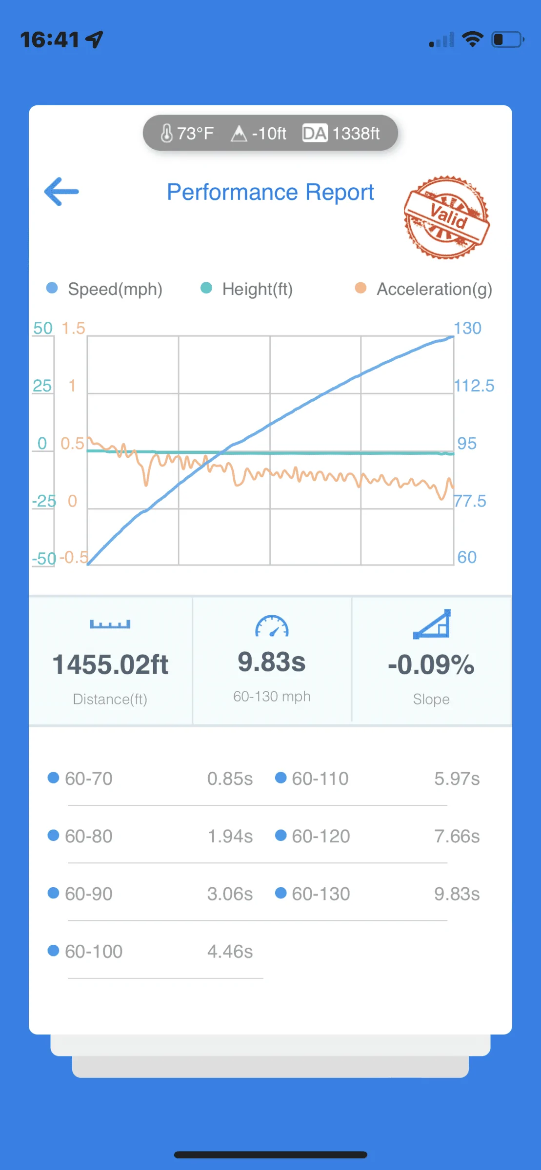

moving!!! you on map 6?
Map 6 with a few more psi on tap, but ran out of time. This was at the end of a 1/4 mile pass riding out 5th; I think shifting into 6th would improve the 60-130 but it would have hurt the 1/4 ET.
