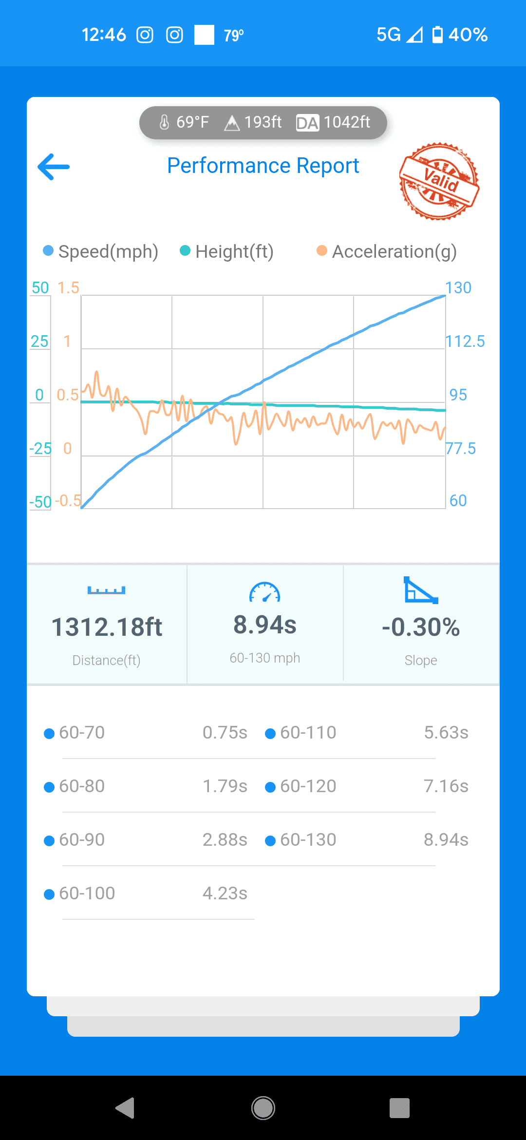

moving!!! you on map 6?
Map 6 with a few more psi on tap, but ran out of time. This was at the end of a 1/4 mile pass riding out 5th; I think shifting into 6th would improve the 60-130 but it would have hurt the 1/4 ET.
