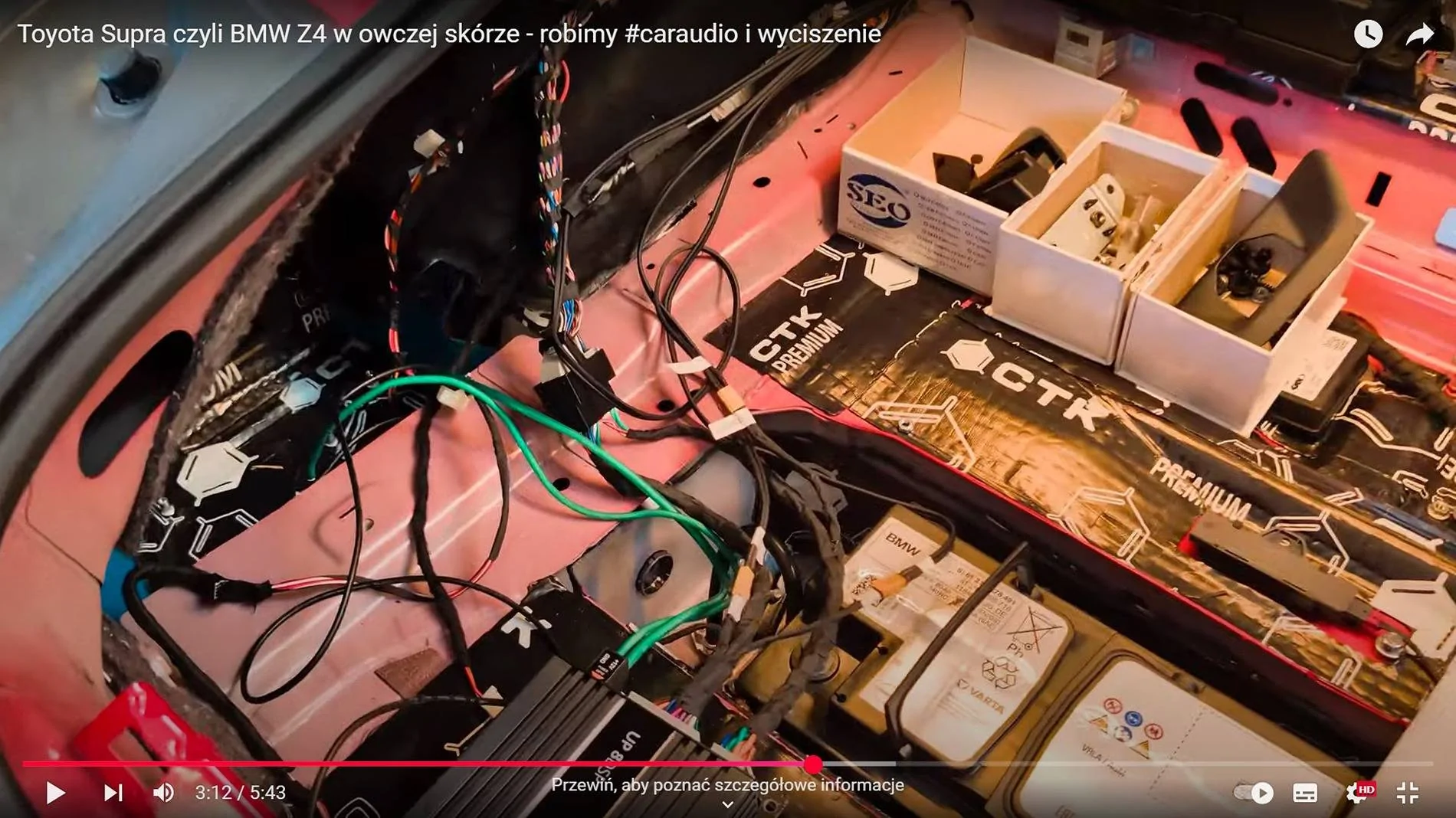

I wish I had such 'base' setup as you have in USA, but in Europe they really nailed it with 2+2 speakers only. I found a nice YT video, showing amp installation on exactly the same car as I have and as you say, there's no RAM, just AMP, which was replaced by Fisher Matchup8 DSP.

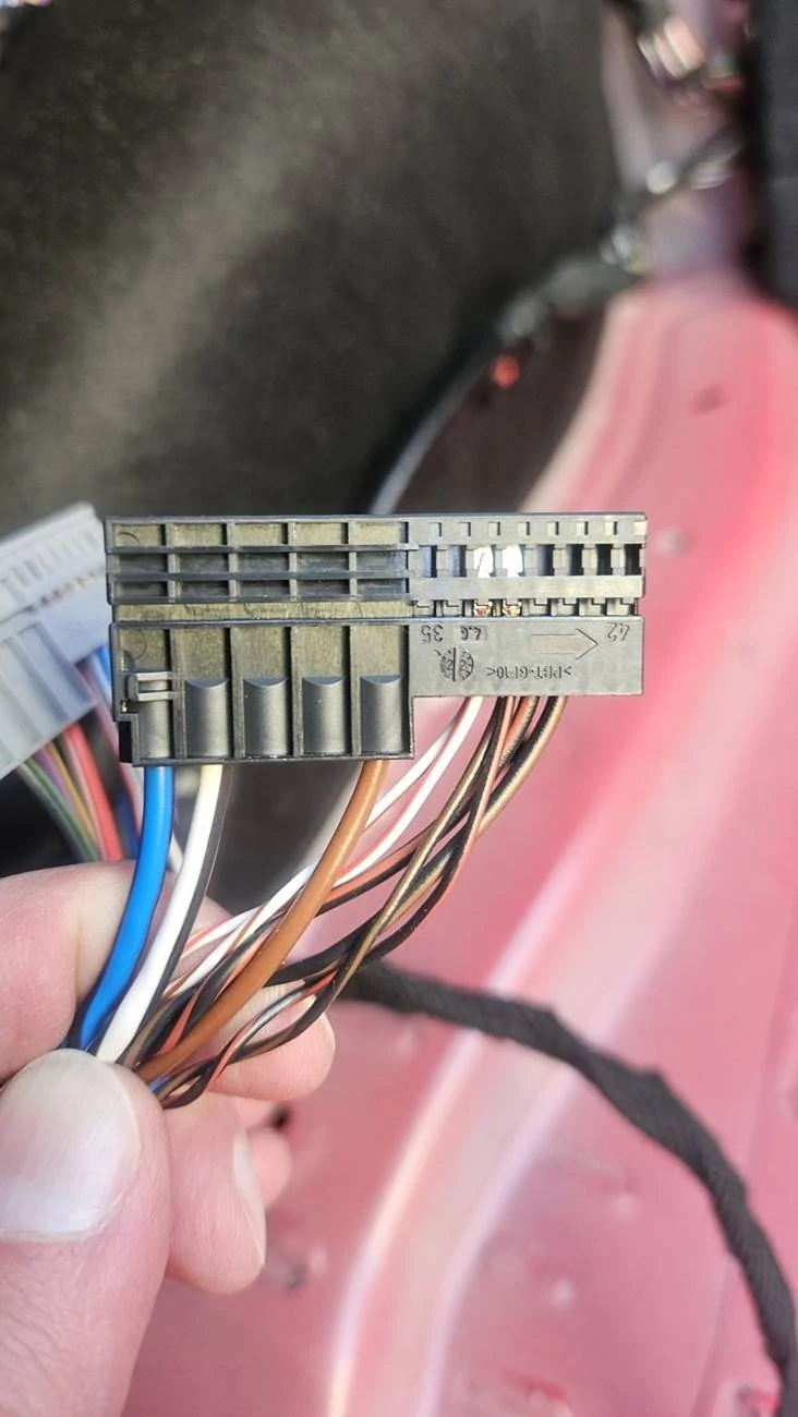

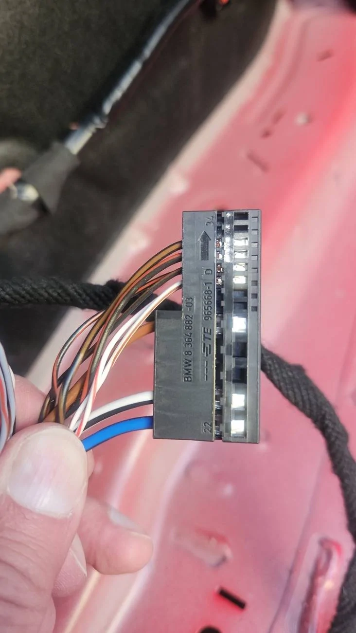

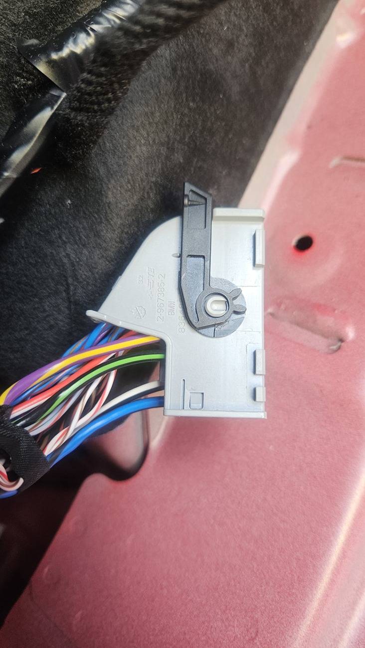

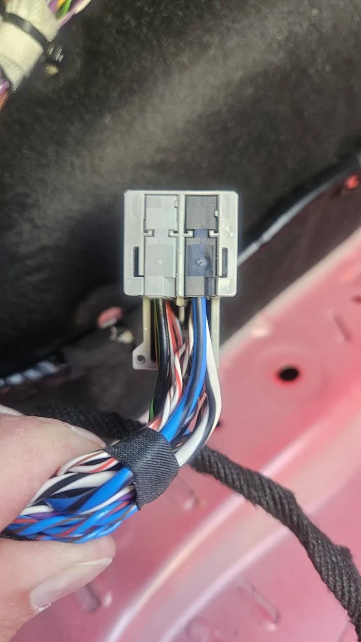

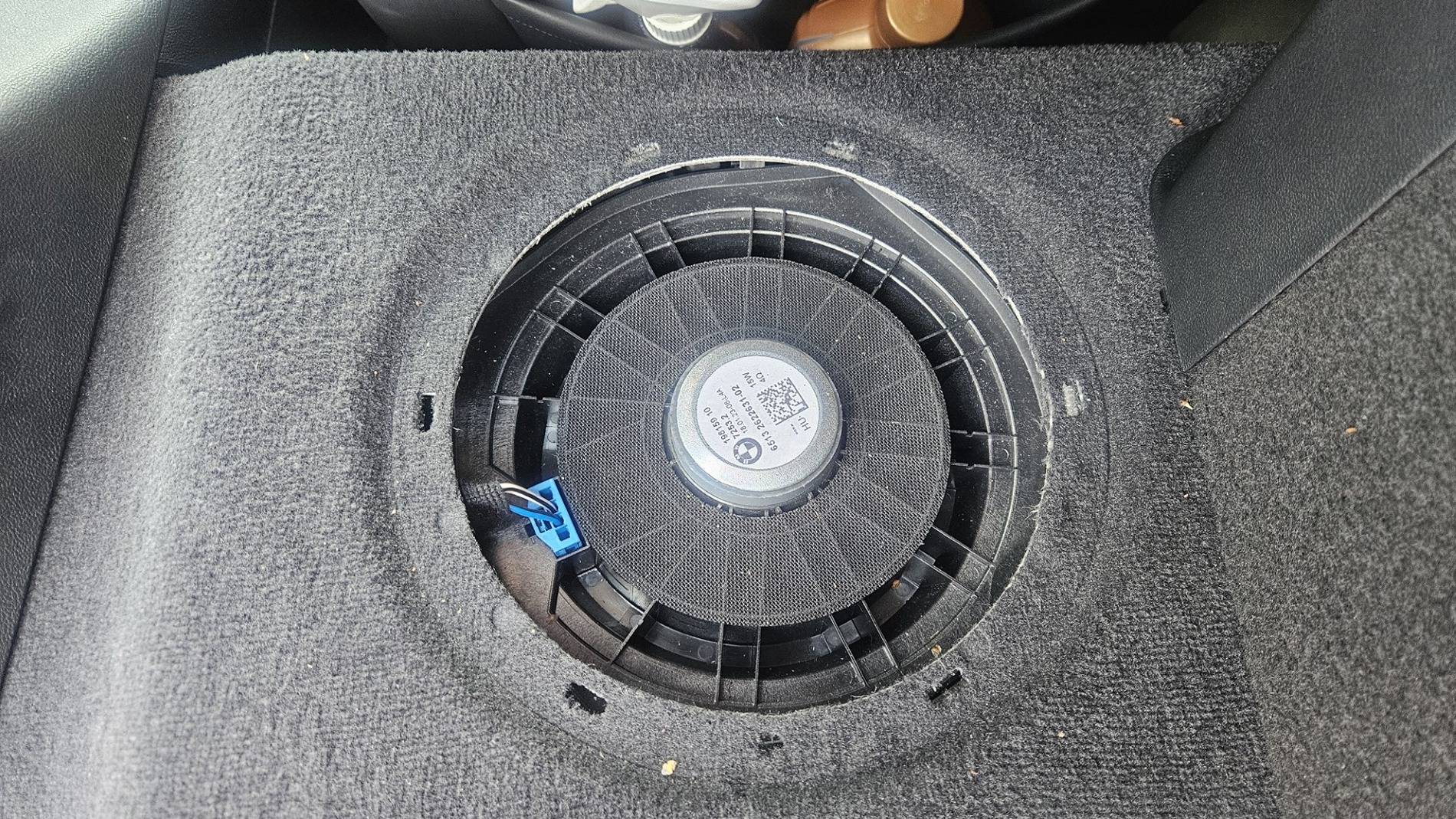

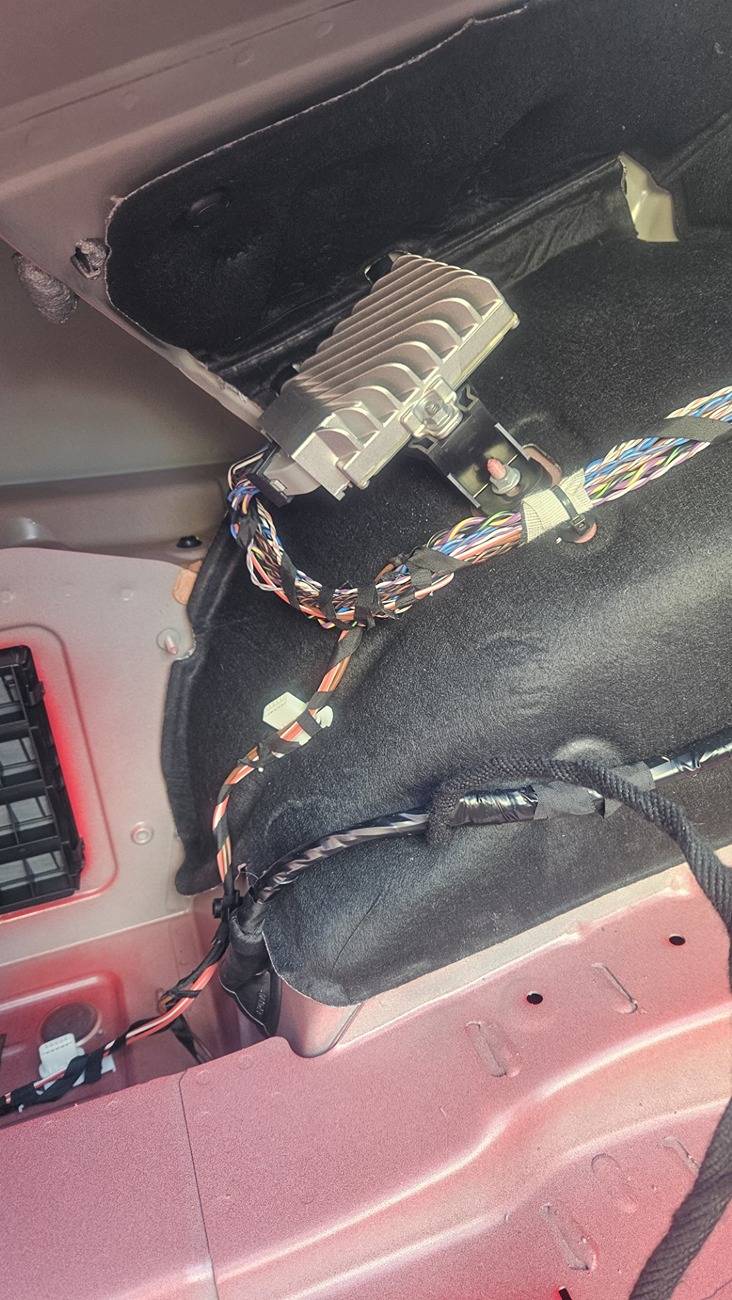

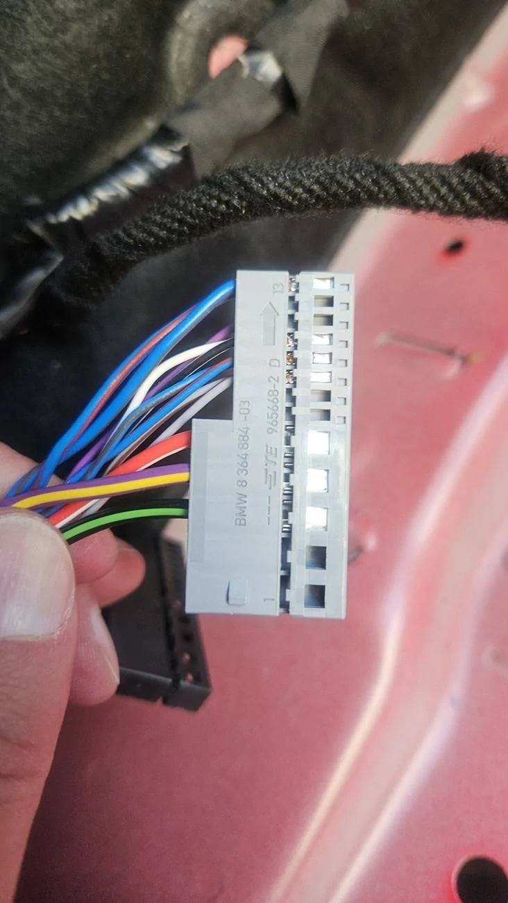

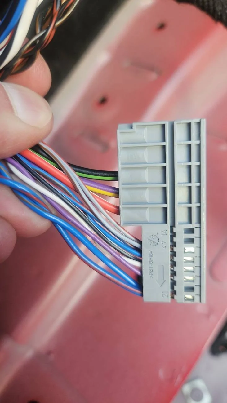

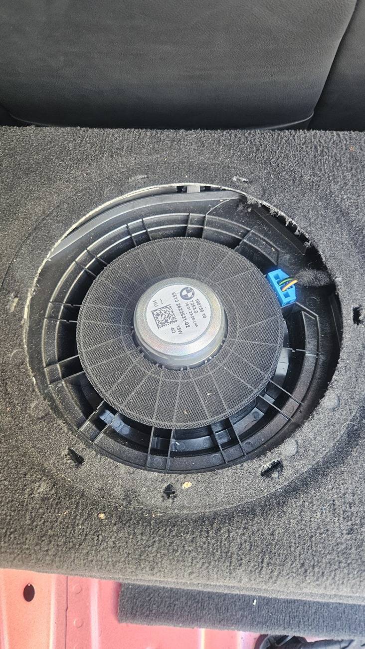

OK, so I removed the trunk side cover and I found out that I have ASD only (I have Sport package) which means all speakers' wiring is already in the ASD connector ... which is an excellent news.
I see that wires: "black-green & purple-yellow" and "white-black & blue-black" which go out from each subwoofer, go directly into the socket. At least what it seems like.
Can somebody help me to understand rest of the wiring in this socket? Pictures attached.

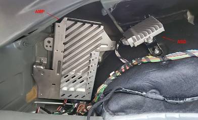

Do you not have an amp right next to the ASD?

monkahead
Artur
Oct 22, 2023
95
51
Poland
Supra MkV MY23 B48B20 (30i)
No, I wrote that I have ASD only, I know how AMP looks like ;)
