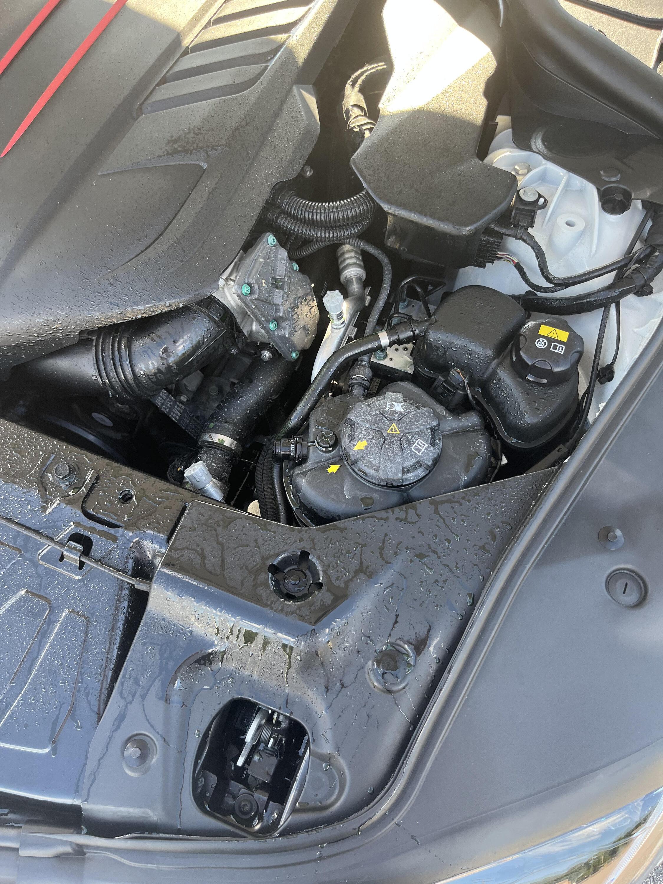

my advice is get a exhaust gas check on the gas in resevoir to ensure its not a gasket/block fail ... I have seen a very similar thing on an i8
Got this exact thing checked actually, came back fine no issues.

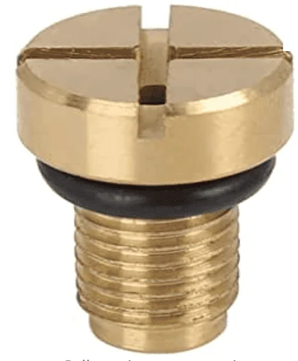

hmmm .. then sounds like an air lock somewhere IMHO ..
I would keep bleeding it ( via bleed screw .. which you should change for a brass one ) .. if pressure is lost in the system it will immediately boil over .. check all connectors locked and tight.
good luck bud
ethanmk5
ethanmk5
Ethan
May 1, 2022
2020 A90 Supra, Focus ST, E36
good stuff ... then thats the worst scenario avoided ...
good luck bud
Actually just put a titanium bleeder screw in about 3 days ago so far so good.

Kind of confused how a wiring harness (assuming electrical) would cause coolant to spray in that location.
ethanmk5
ethanmk5
Ethan
May 1, 2022
The rodent chewed the wire connection to the coolant temperature sensor.
