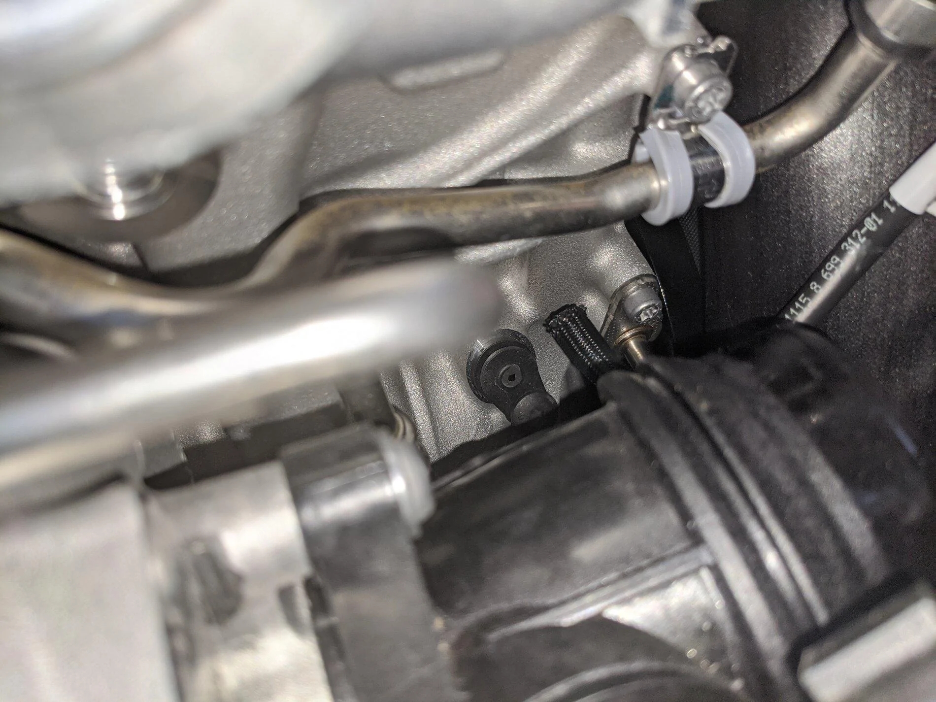

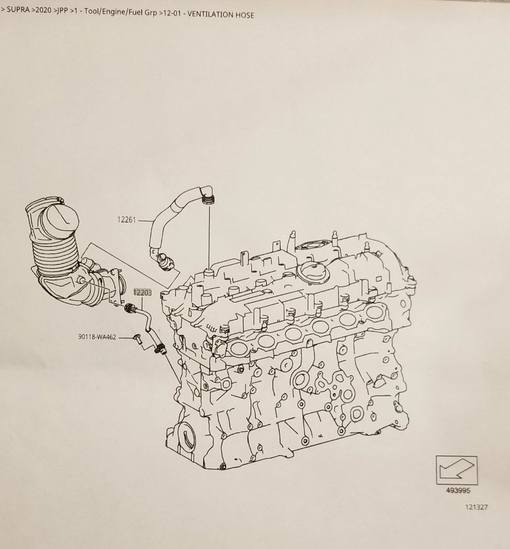

Hello everyone, so in installing my MST intake part #2 in the listed diagram above broke off as well. The portion that connects into the crankcase has snapped clean off of piece #3.
Will this cause majors issues? Can I run my car for the time being? Is it a simple fix of just replacing part #2 & #3? Do I need to bring it to the dealer to have it fixed?
Thanks for any information guys.
you will more than likely get oil residue where it broke off. You can drive it, but i wouldnt leave it like that for an extended period of time. I guess i should make aluminum -AN replacements for that.

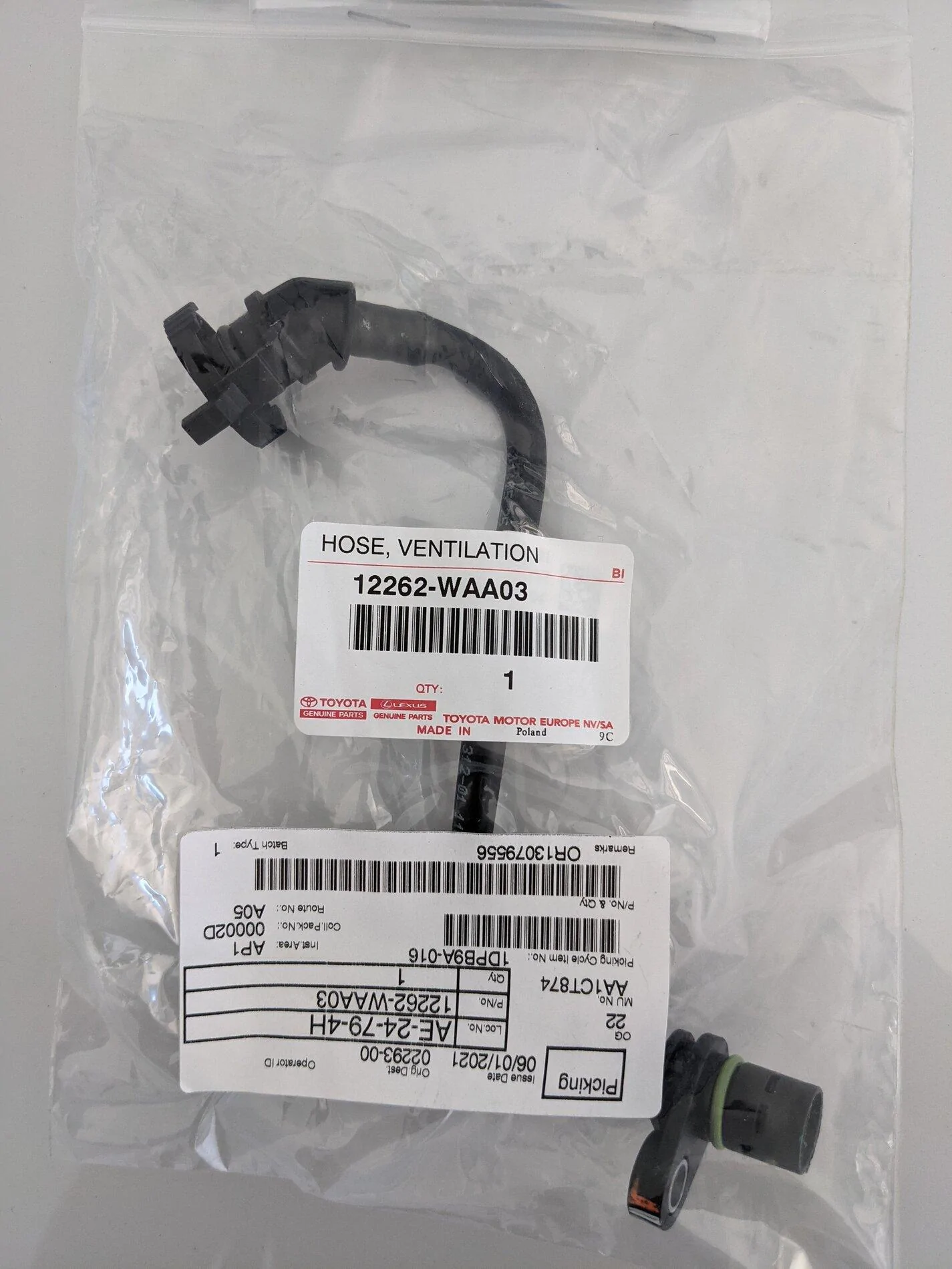

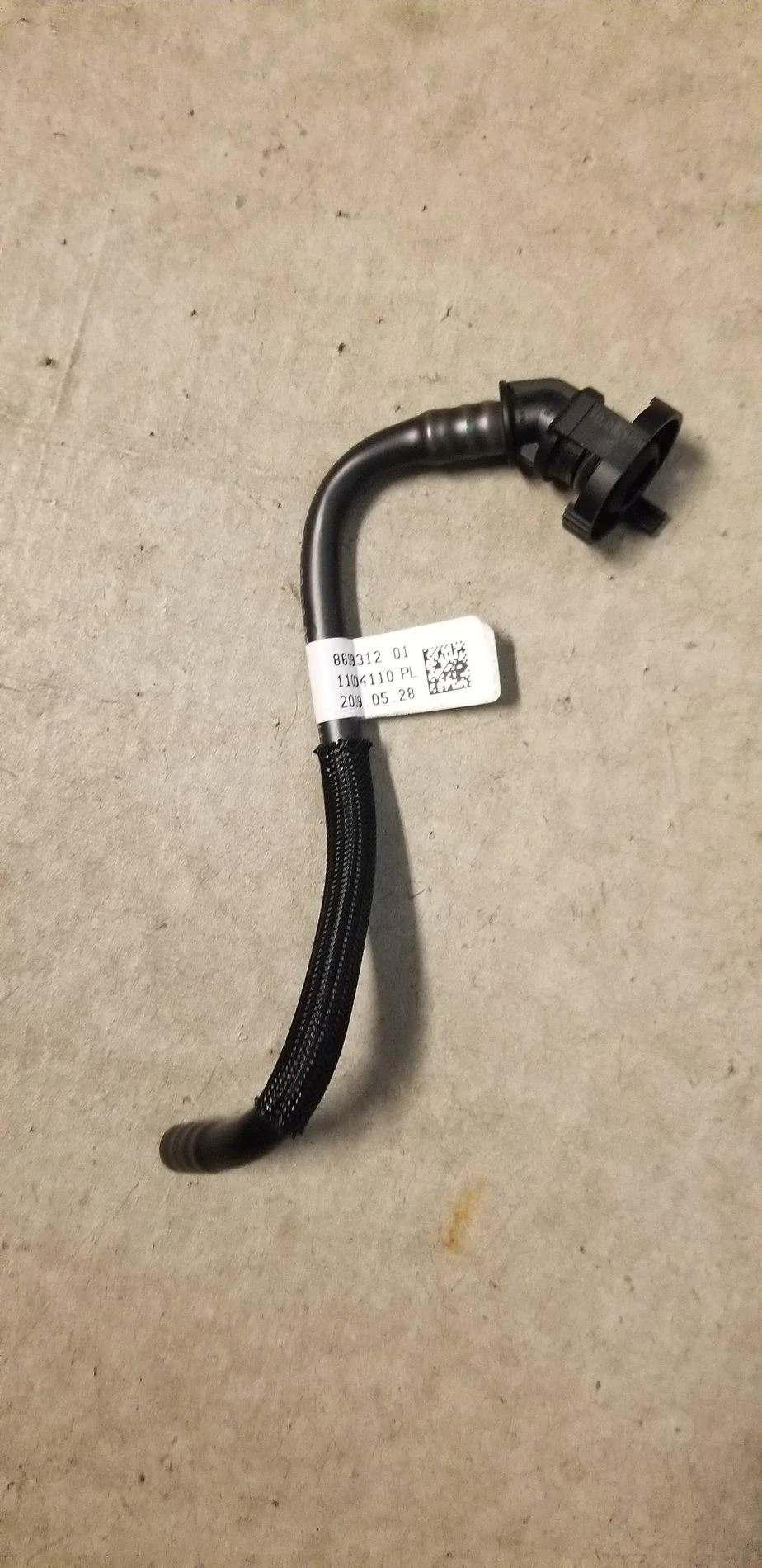

I had the same problem. It's pretty easy to break. I believe this is the correct part.
https://www.hubauer-shop.de/en/carp...=en&cPath=3_760_754_60523_6052311_60523117808
Someone please correct me if I am wrong, but I'm pretty sure this is it.

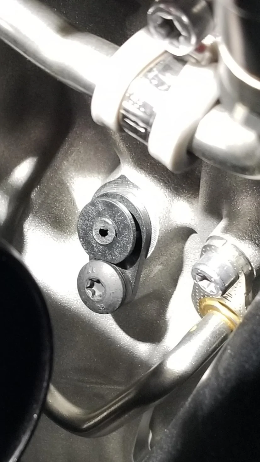

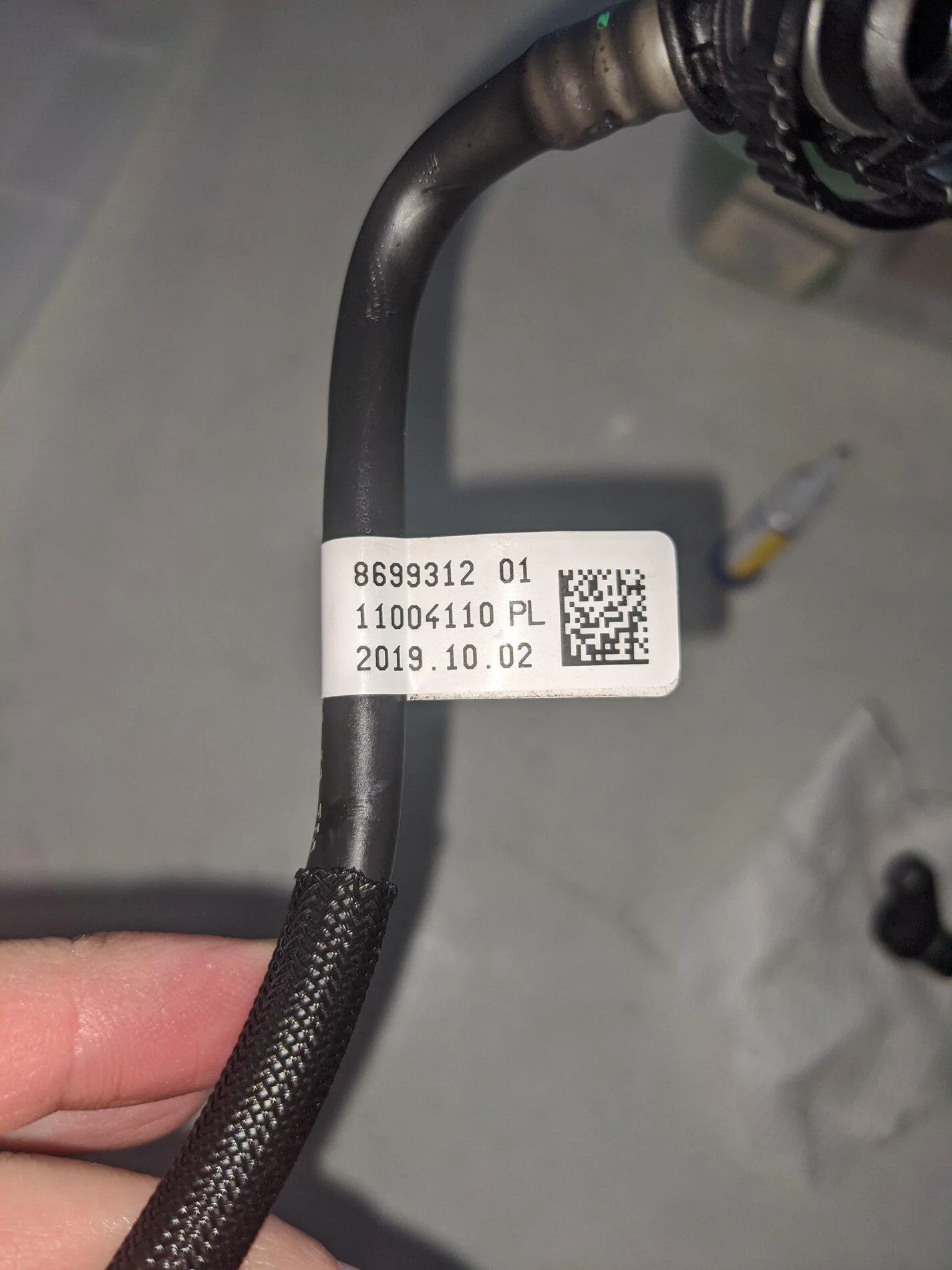

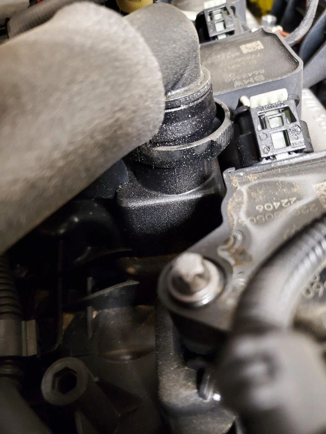

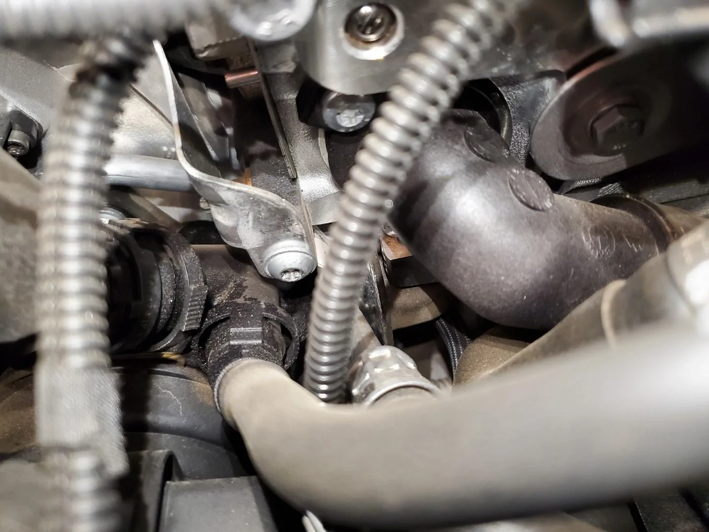

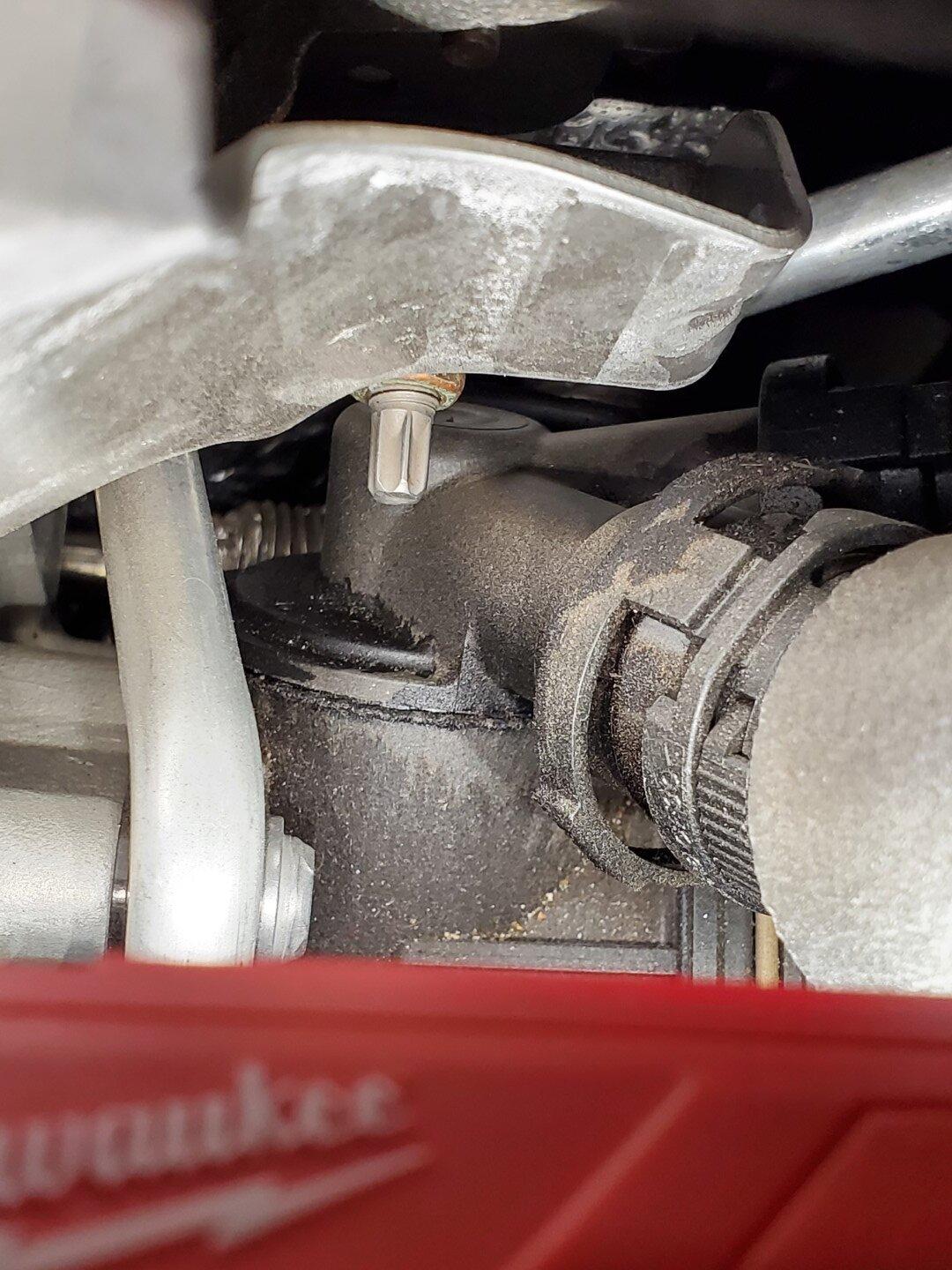

And is yours have a little oil residue coming out like mine? Lol. Seems to be common.
I have oil residue coming from both ends of the crankcase breather hose. Car (B48) has 3k miles on it. I wouldn't say the amount is alot...but you can definitely tell that significant amount is present. Is that normal? Or a sign of a bad/defective hose that needs to be replaced?
Natek
Nate
Aug 14, 2019
47
376
285
2020 launch
Its normal but we have been trying to find a way to stop it

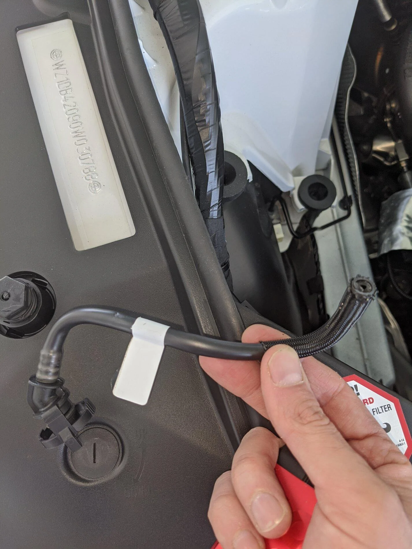

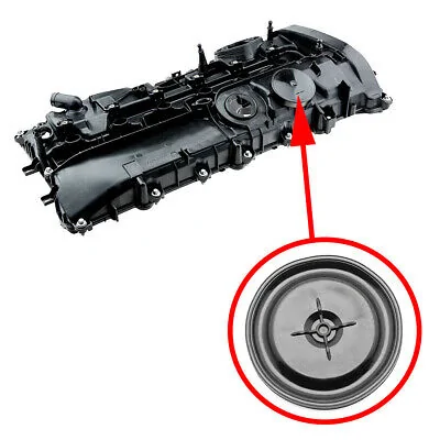

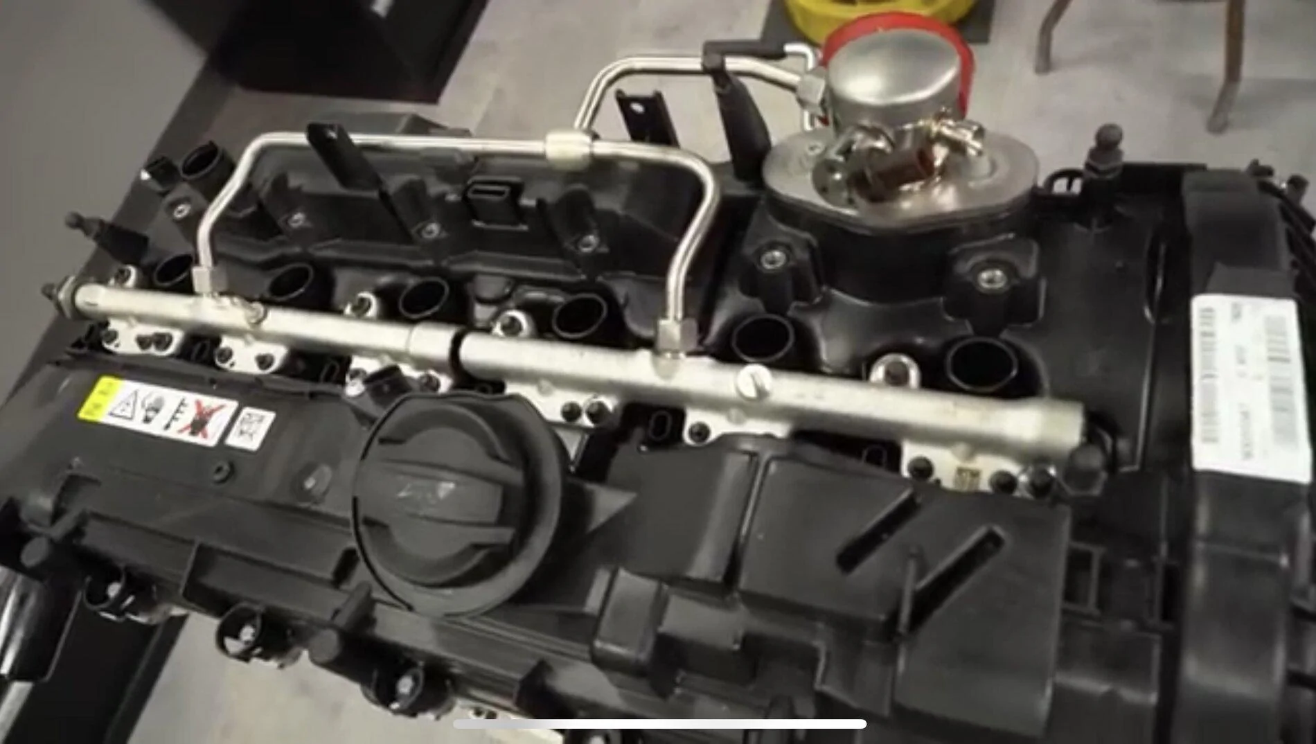

Hello! Fellow B58 owner here just looking for answers if anyone has any info here. My M240i had some serious PCV issues recently, resulting in a new valve cover, plugs, and fuel injector gaskets. Crankcase pressure got to 93mBAR when normal is measured at 20-50.
I noticed the OG B58 from my M240i has this breather valve on top of the valve cover:
But the TU Toyota uses instead has the hose that broke for OP. It does not have the breather valve according to this screen grab from the YouTube teardown.
Does anyone have any other info on how the Toyota system works? I’d like to try to prevent another failure, as the original failure was at a mere 52,000 miles.
