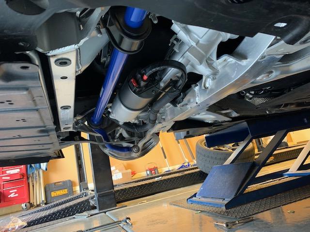

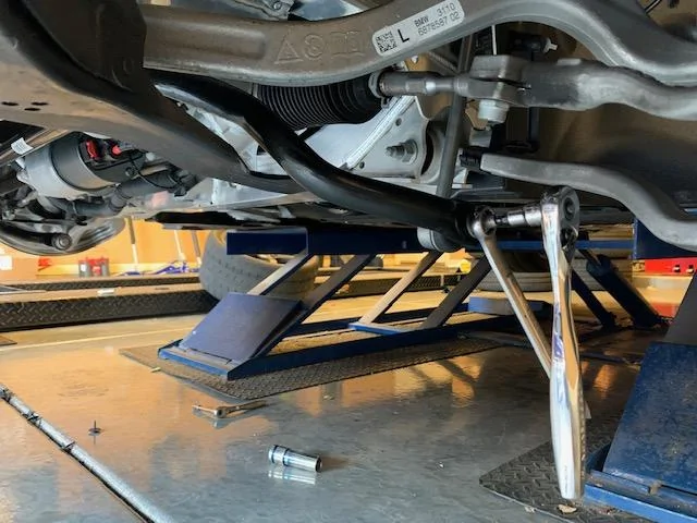

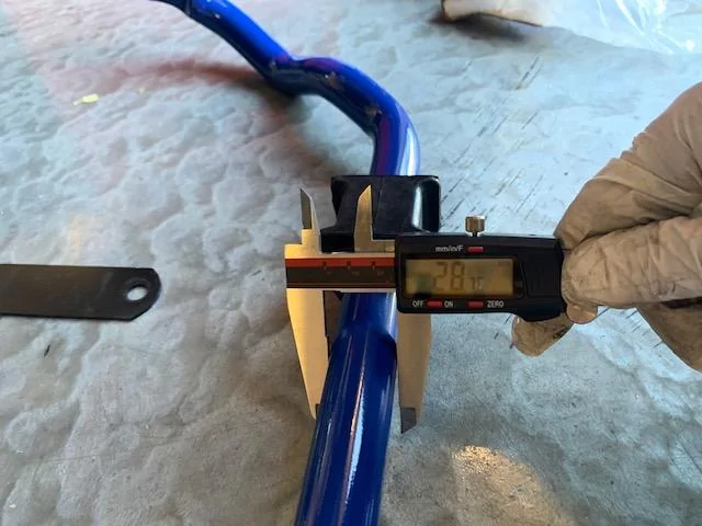

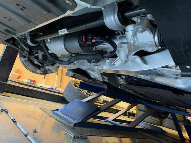

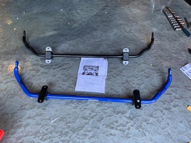

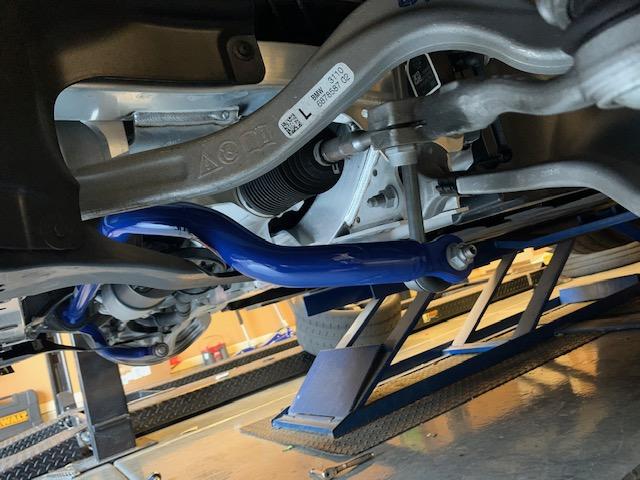

Cusco 28mm Sway Bar install
mitchely03
Mitchel
Sep 20, 2019

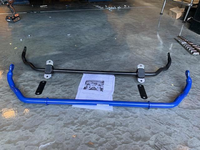

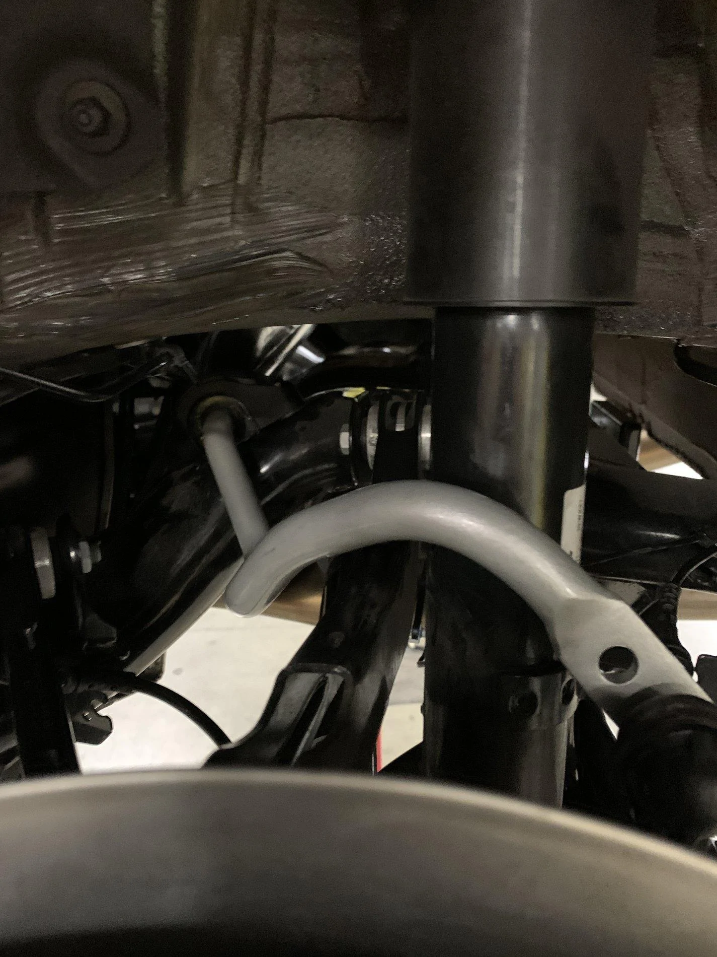

Who’s front car did you go with? What size was it?
Congrats on the install! In the scca class we run in, we can only change one bar, front or rear, but but both.
Best regards,
Dave

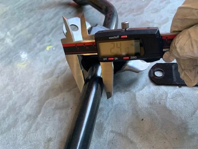

Its Whitelines front. Its a 24mm solid bar with 2 adjustable points.

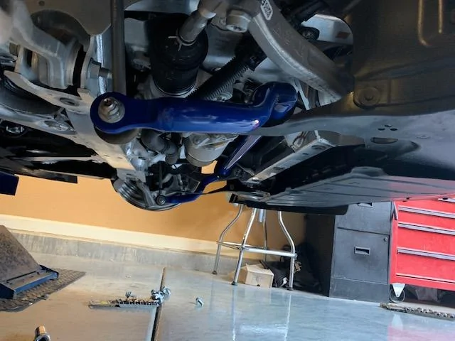

I just removed mine, if anyone interested.
It’s fairly straightforward, your first time might take 60 minutes start to finish. After that, 30 minutes tops.

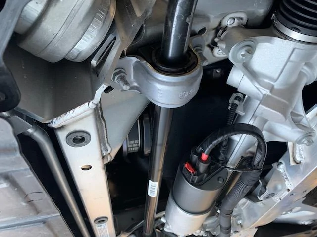

Did you have to take off the shocks to drop the subframe? Planning to attempt to install the rear sway bar. If you have any tips that would be appreciated. Thanks.
So I just put in the rear bar. Holy hell what a difference it makes on a stock Supra. Ours is stock shocks and springs. We have a front bar to put on but I’ve already confirmed fitment on another Supra. So wanted to do the rear first on this one. Holy hell its a dramatic difference. The car literally wants to go where you point it. I
Kiwi Greg
Greg
Nov 28, 2019
404
423
New Zealand
terminatorproducts.co.nz
2020 Supra, 2021 GR Yaris, 2022 GR86
I'm also looking for help on rear sway bar install. manual says, need to drop rear subframe to to do this. I don't have equipment to do this properly so I'm wondering is there a way I can swap rear sway bar without dropping rear subframe. can anyone chime in?
You need to drop the rear subframe at least 4-5 inches to get the bar out & new one in
Watch out for all the wires, brake lines, drive shaft etc, they limit how much you can drop it

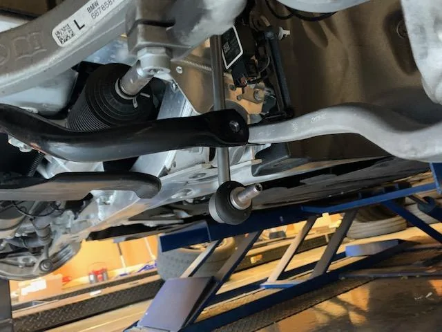

After installing the front sway bar, I noticed that when I go over uneven bumps at low speed (less than 15 mph) I noticed sound coming from front suspension. not exactly know where.. almost like something knocking.. I followed all the instruction here, manual, & any information I could get. Only thing I can think of is, I installed the sway bar while it was raised and torqued the nuts on sway bar/stabilizer links. should I have done it while suspension is compressed as if the car is on the ground?
RenierR10
Alexis
Aug 28, 2019
111
48
New York
MKV Supra
End-links need to be compressed when torqued down.
