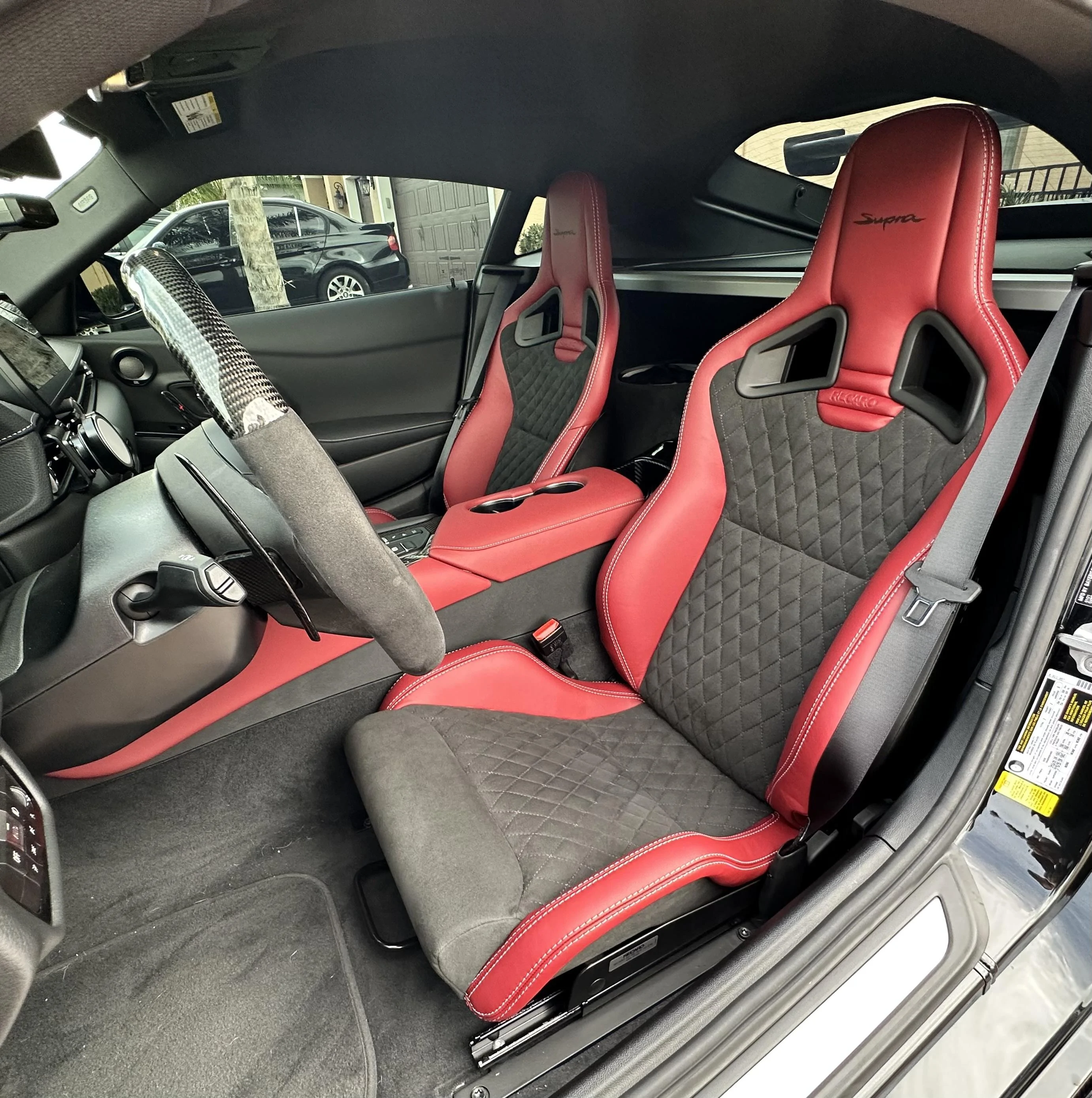

Just FYI - I bought these direclty from AMX Performance. I know theres another person on this forum with similar seats, but I did not buy from him (I actually DM'd that guy on here and on instagram with questions about the seats and never got a response but oh well).
I will do the same. Thank you so much ??. I found the install thread thanks to you for my awesome mechanic. He can probably do the electrical stuff I have no clue about too. And thrilled there is such an amazing option for track weekends and still look absolutely stunning ?. I’m only 6’ even and 185lbs. Should work perfectly. Beautiful build BTW and garage ? I still want your garage too someday ?

There were a few differences for me from reneglect's build thread. Namely i had to de-pin 3 pins on the passenger side to get the harness out. Honestly if i did it again, id try to find seat wiring harnesses on ebay to use, you basically wreck the stock seat harnesses by reusing them.

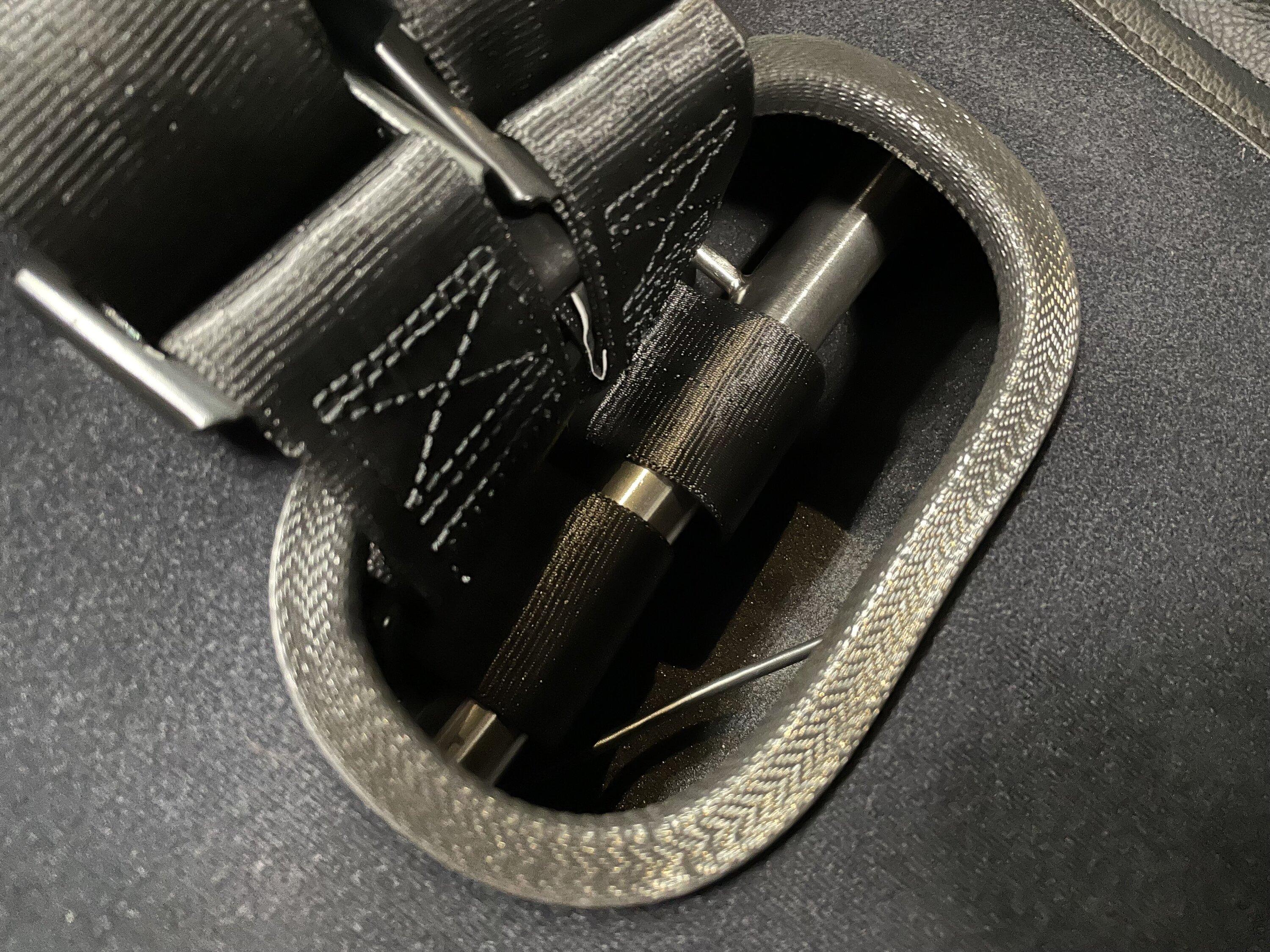

If you wear a harness, you want a hans if you enjoy having a working neck.

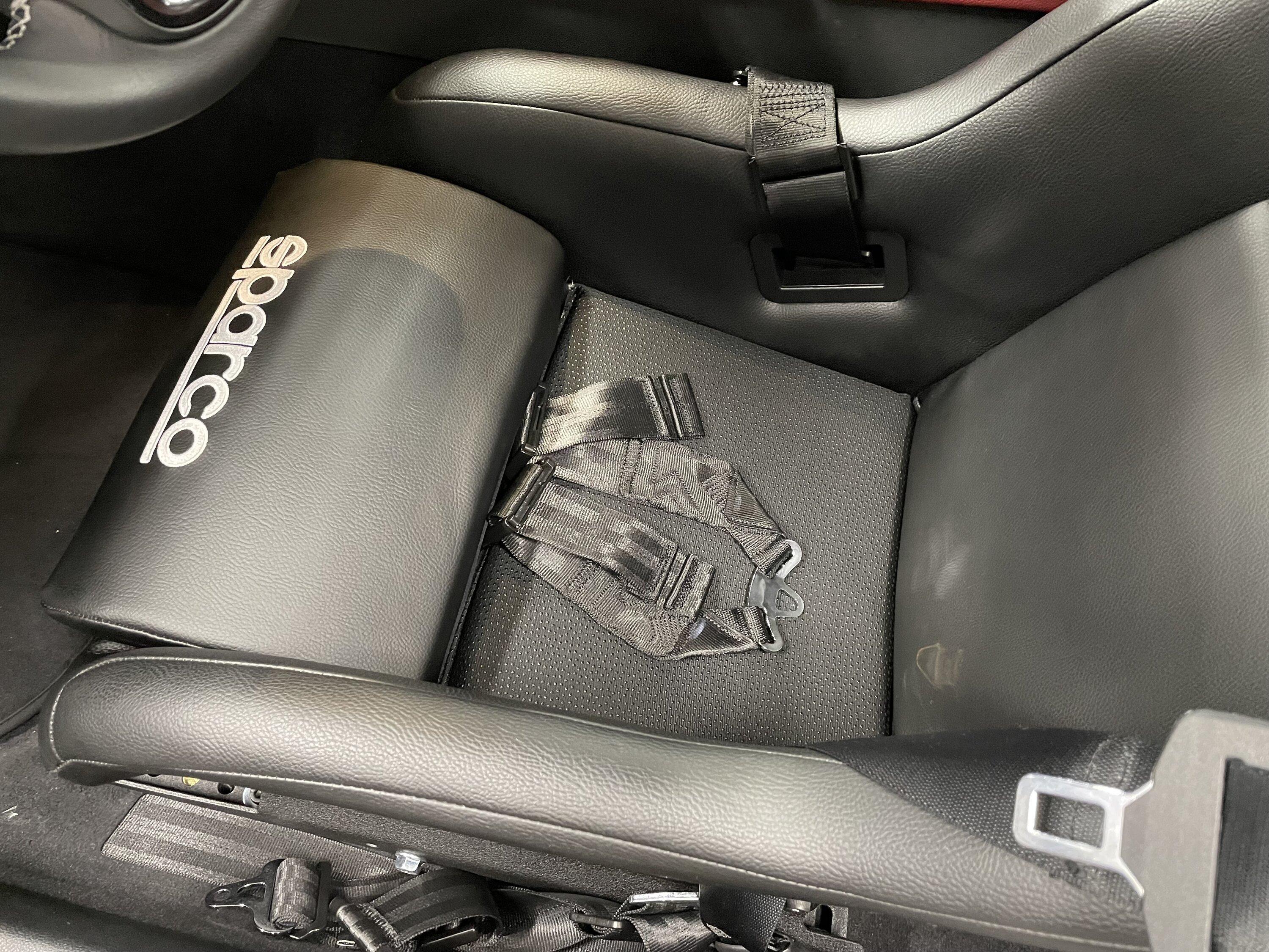

Also, a FIVE or SIX point harness needs a seat that has an opening in the bottom cushion for the sub straps to go through. A FOUR point harness does not.
I use a SIX point harness and the sub straps look like this:
