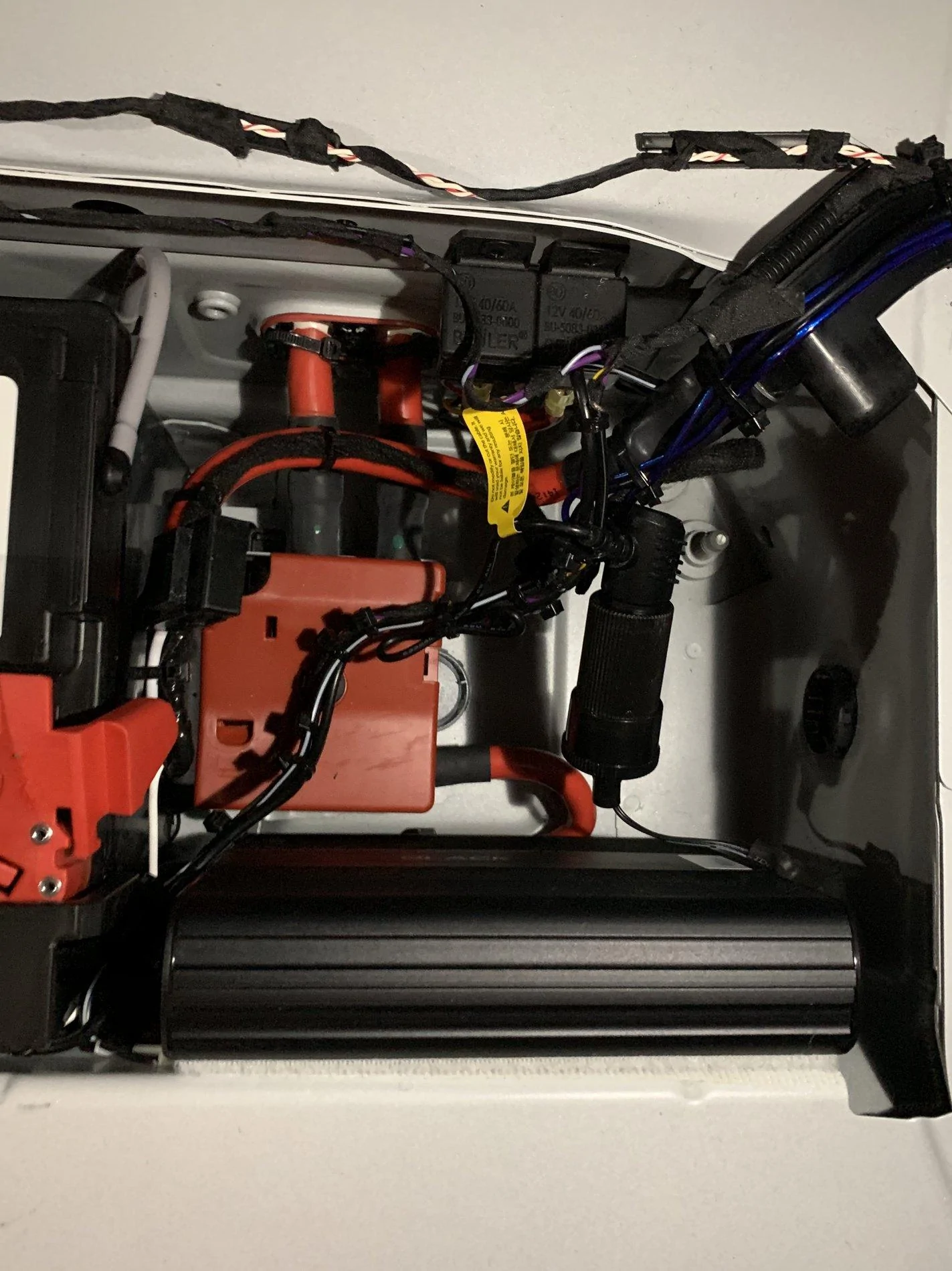

^^^ I considered size as well for the battery pack. Where did you mount the Power Magic Ultra?
To the right (passenger side) of battery, fits in there nicely.

I have a Blackvue DR900S 2 channel that I'm running successfully. I have it connected to the B124x battery which is hardwired (via relay) directly. This allows the dashcam to run in parking mode for 8+ hrs and quickly charge back up from the Supra battery.
I also have my radar detector directly wired.
This video will explain where you need to tap in. It's important that you use a relay or else you risk getting a code.

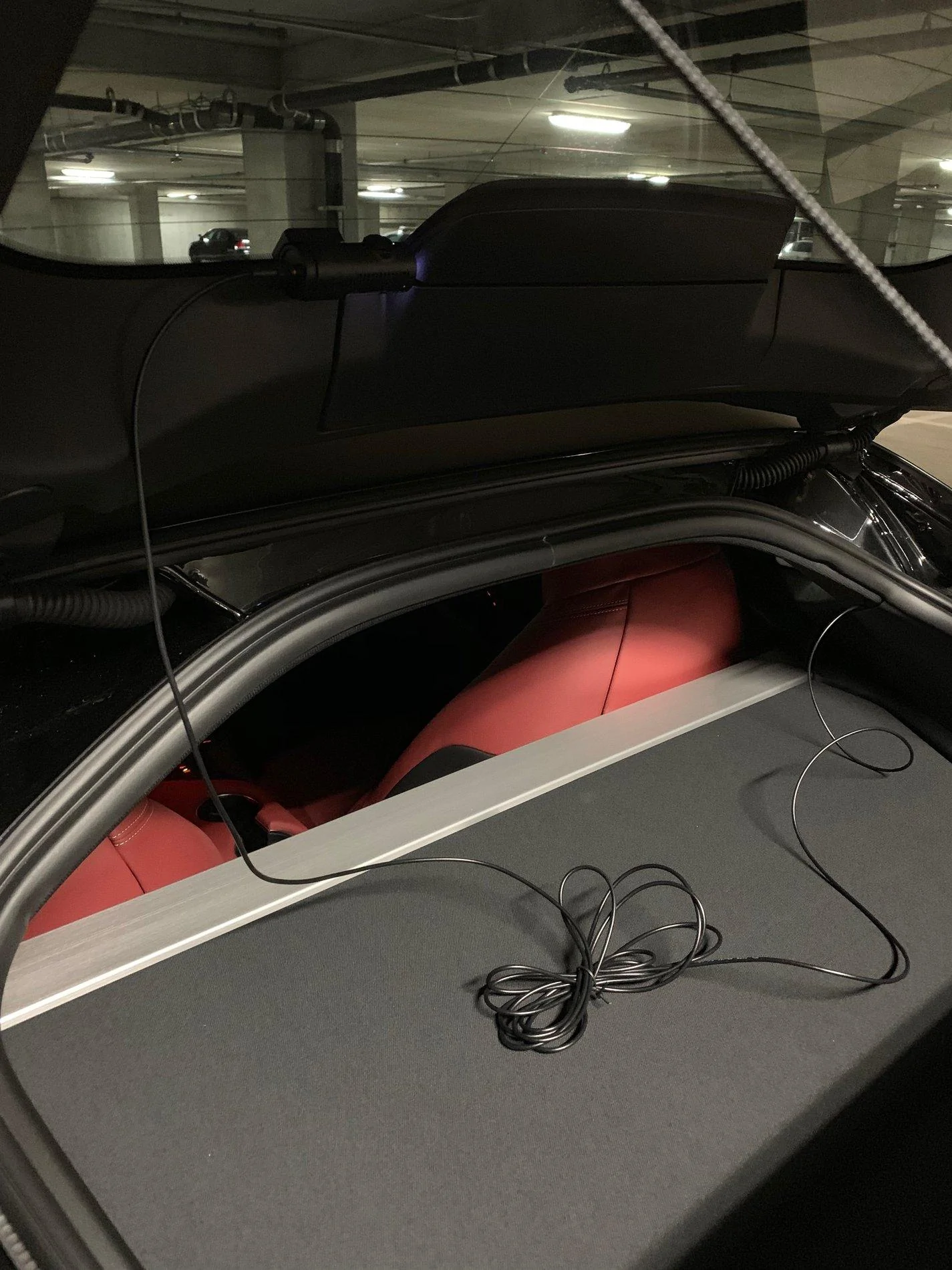

For any of those of you who've installed a back dashcam, how exactly did you get the wiring from the back of the body of the car up and through the trunk? I didn't want to mess anything up there and wasn't sure how to get it into the plastic tubing thingy, so I have the wire for the back camera just kind of dangling there right now. If anyone has any pictures / videos of how to discretely run this wire I would really appreciate it.
m(_ _)m

No pics, but, my installer ran the wires through the factory rubber boots on the trunk and then under the headliner to the front cam.
Yeah, that's what it looked like from the video, but I wasn't sure how to get it up under that area. It wasn't entirely clear to me what could/couldn't be popped off back there to access that area. :p

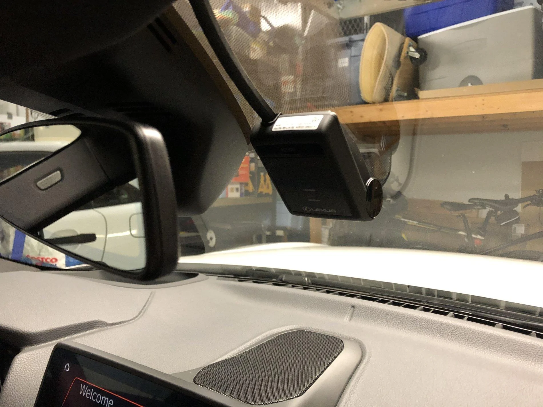

After much discussion with Toyota customer service, my Toyota dealer, and a large local BMW dealer, I found that there is no Dash Cam accessory suited specifically for the new Supra, or BMW Z4. BMW uses a standard model for all of their cars, and their techs use internally accessed installation instructions (which they don’t share). And no, they won’t touch a Supra. Like my ‘Clown Car’ horn replacement (see separate post), I asked my Lexus dealer (dealt with 20+ years) if they would install a Lexus Dash Cam in my Supra. I have the same Dash Cam in my Lexus RX350, and like the features and smart phone UI. Unfortunately, it is only front facing, but has parking surveillance and protection against draining the battery. The techs installed 2 fusible links, and 2 mini fuses. They ran a wiring harness from the camera to the fuse panel in the right rear corner of the car. It is fused through the ‘steering wheel media and fuel light’ circuit.
KahnBB6
Aug 23, 2018
1,410
1,944
Boomer64, do you happen to have the Lexus part number for this factory dash cam accessory? I've been looking into aftermarket options but I had no idea Lexus offered their own.
Further, based on your description of the installation in your MKV would I be correct in assuming that, other than having a smartphone handy, there are no further hard-wired connections needed for it it to work other than basic +12V power, Ground, +12V Accessory and applicable ignition circuit splices?

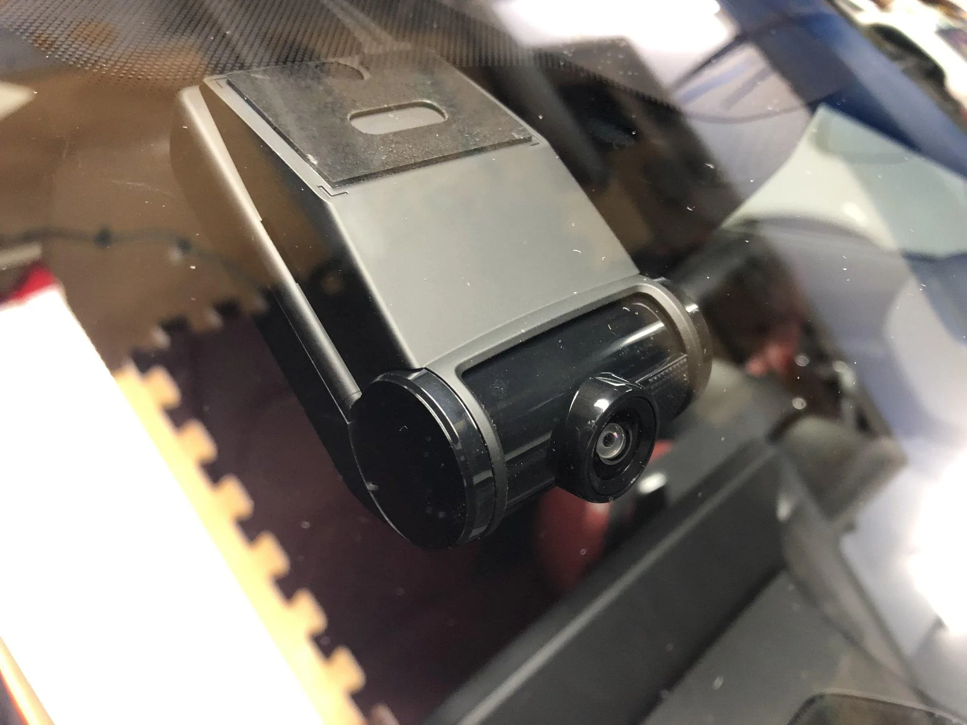

I would have shifted it up so that just the actual camera eye was below the textured line but overall great.
