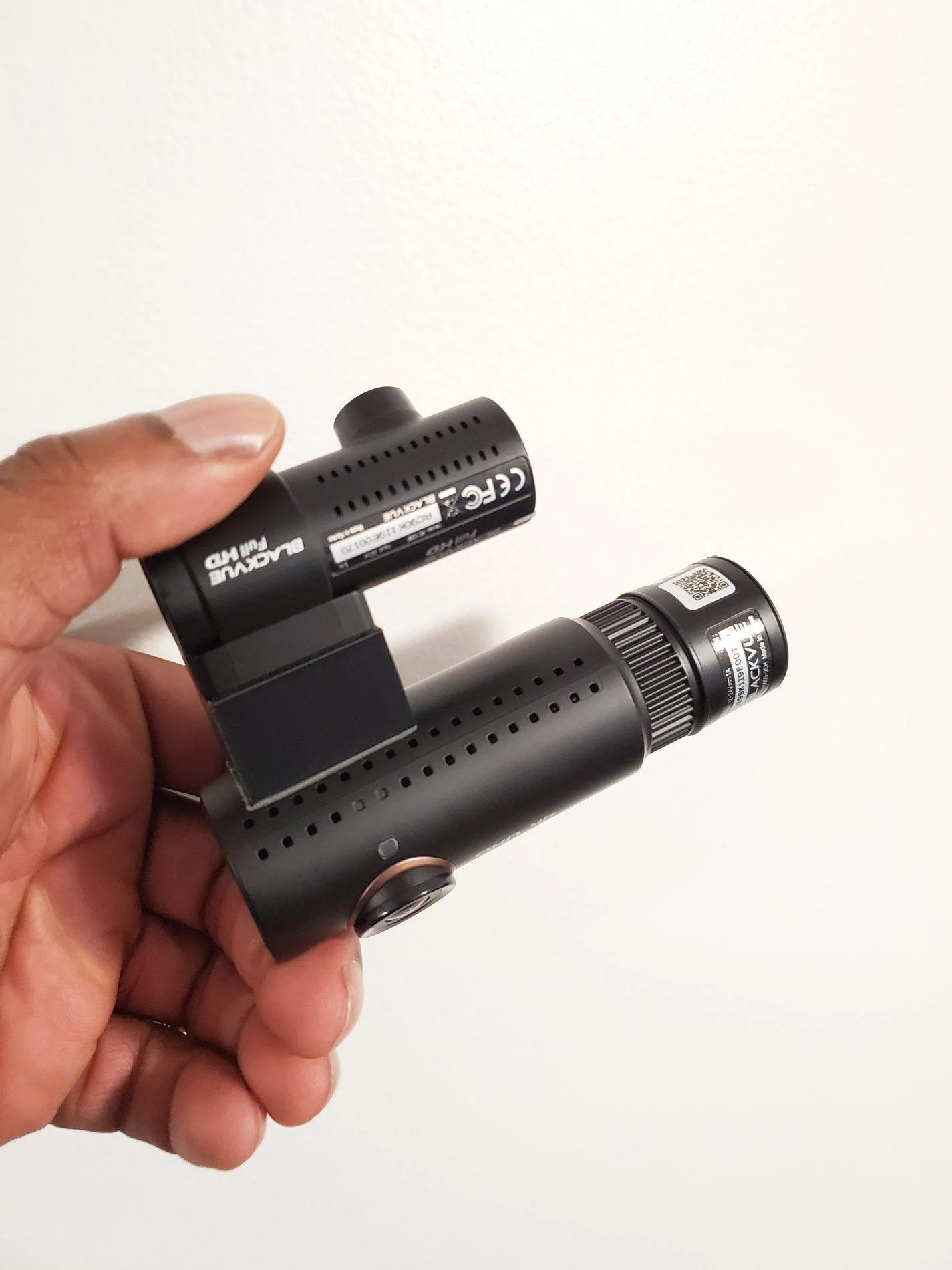

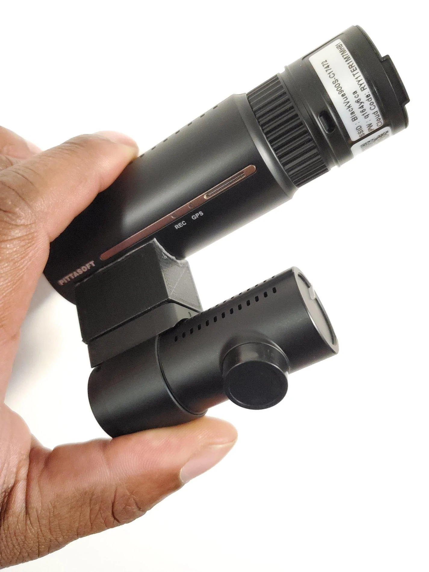

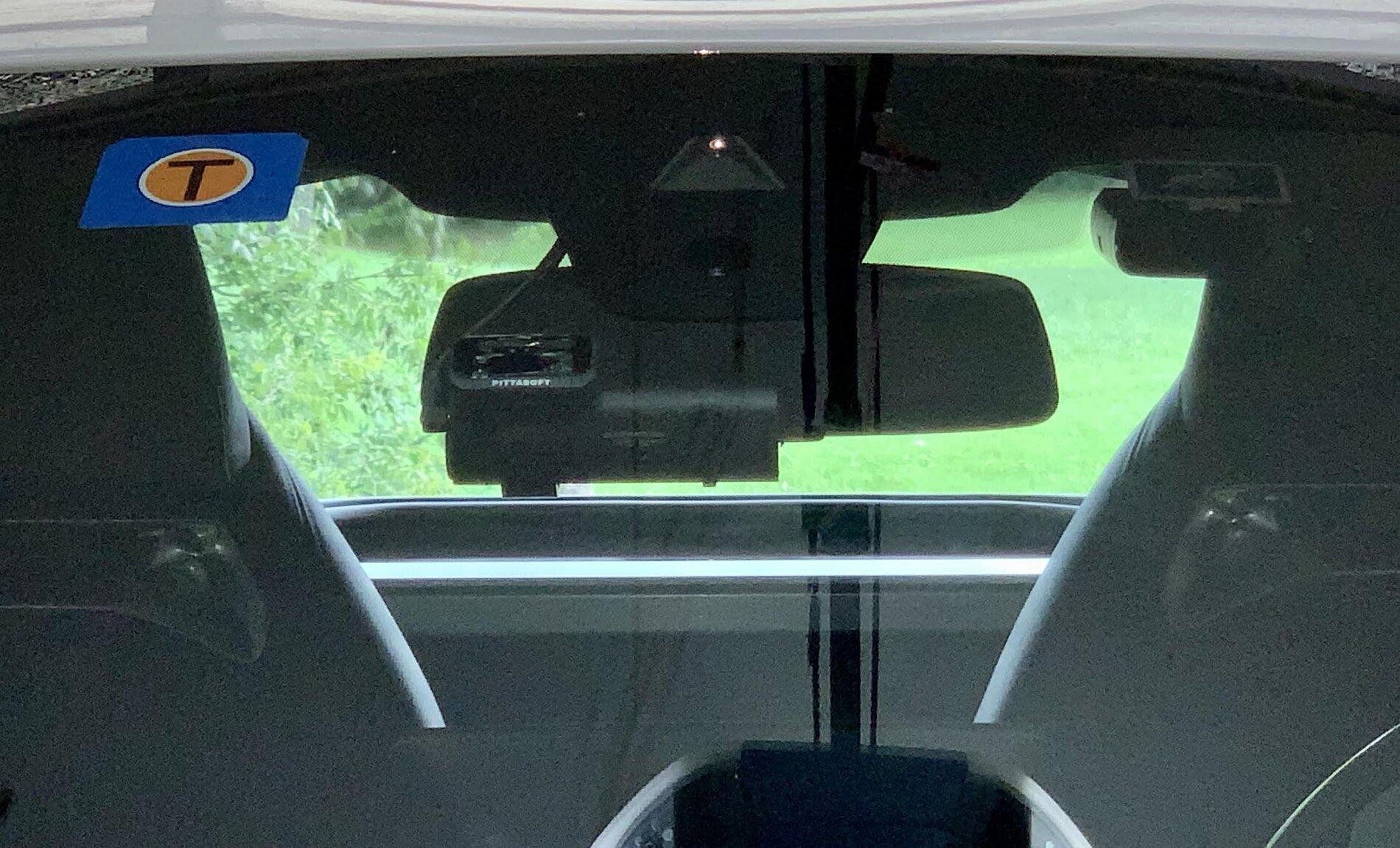

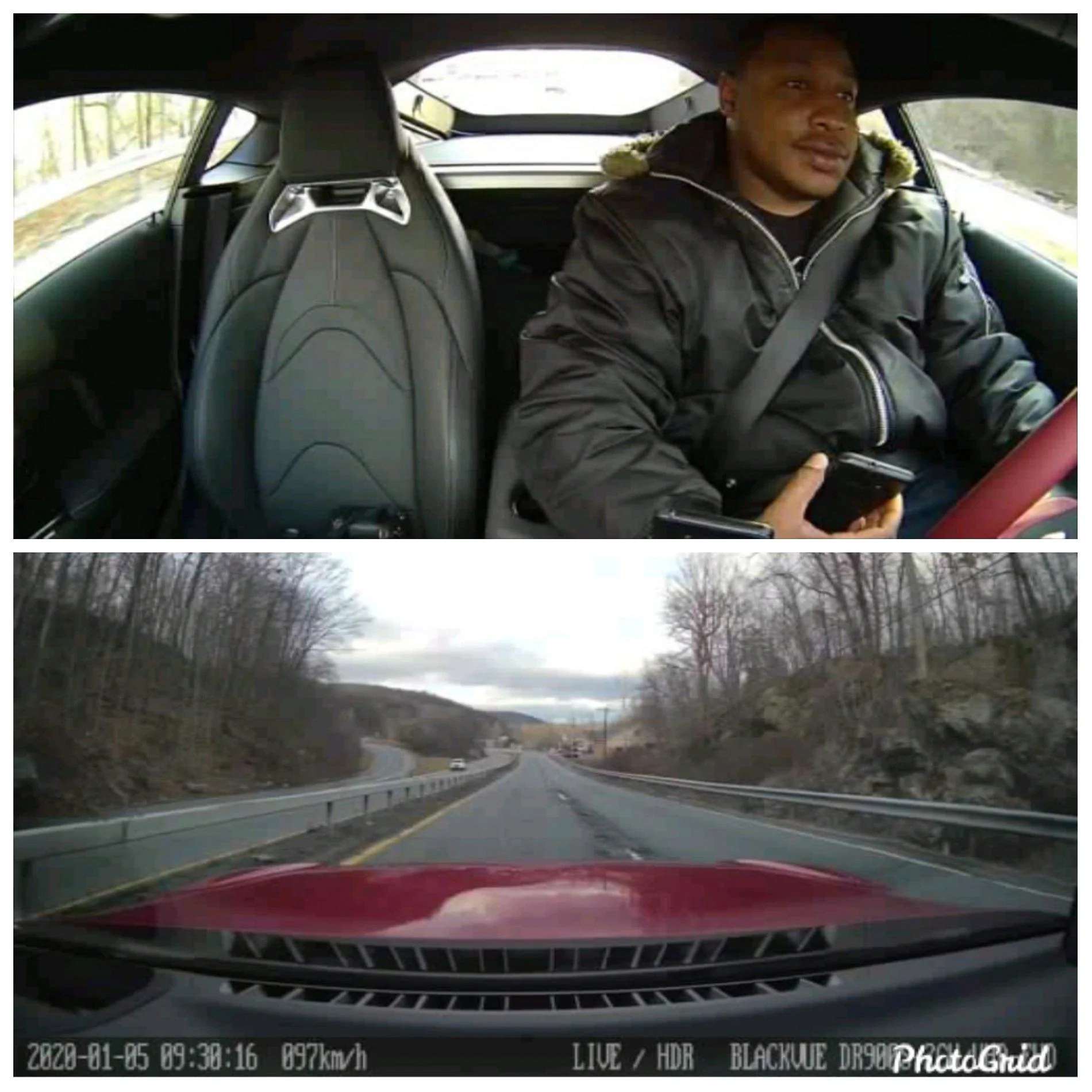

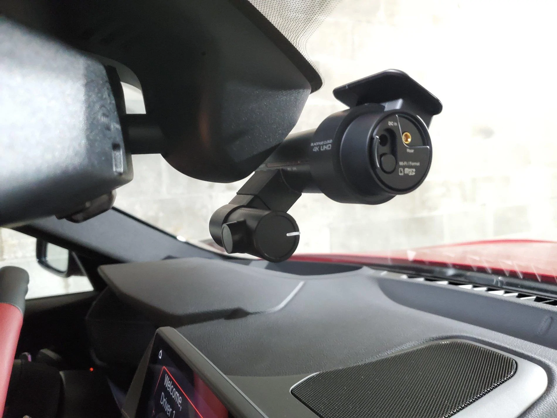

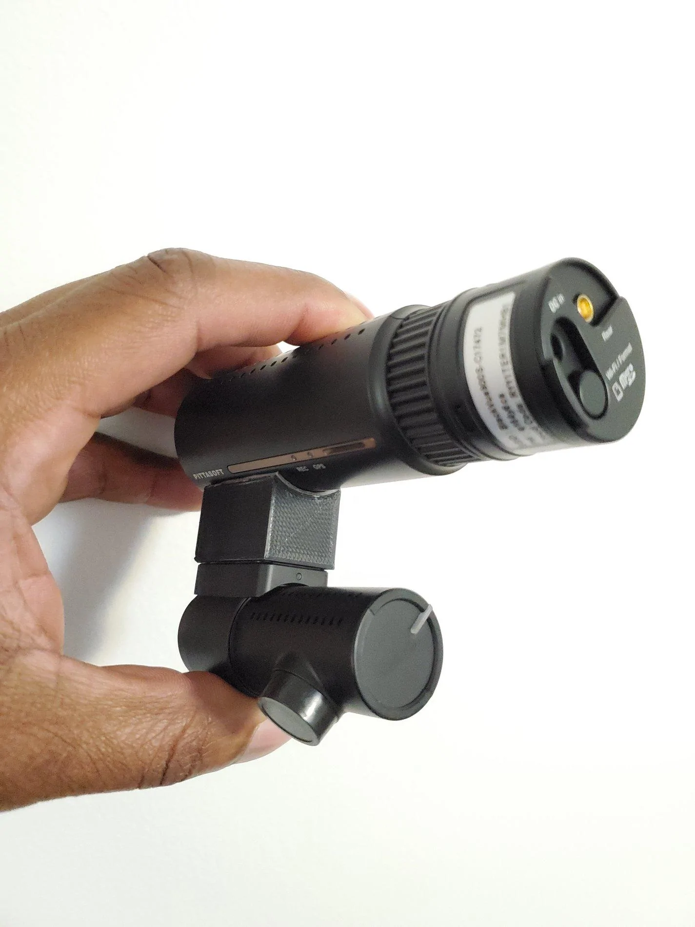

I have the Blackvue setup as well. I have the dual cam for front and rear. But made a little secondary mount to attach the rear camera to the front so I can see the cabin and rear and rear sides of the car. Love it!
Can you please provide some photos of what the rear camera see? :wave:
Sorry, just remembered you asked. Dont mind the quality. It's a quick screenshot from the phone app.

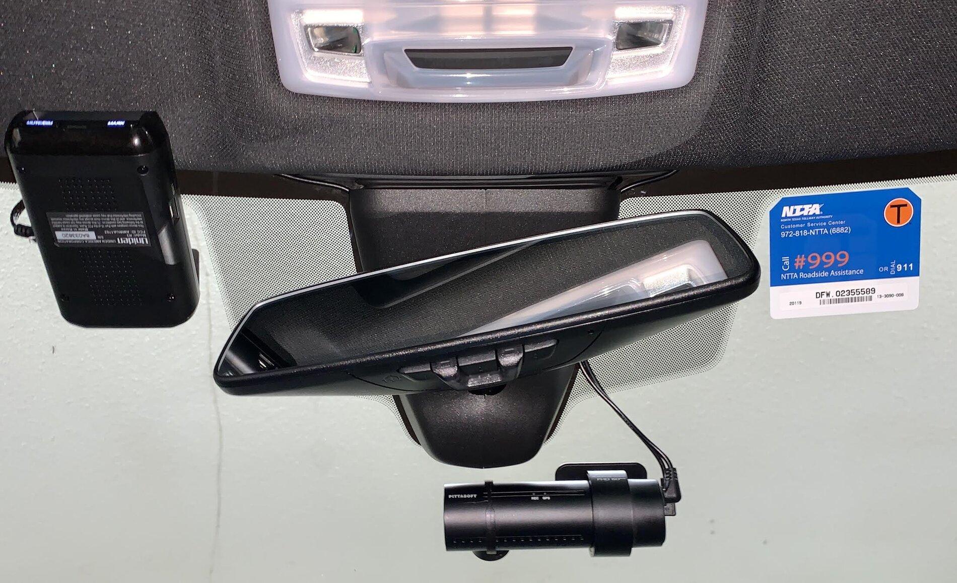

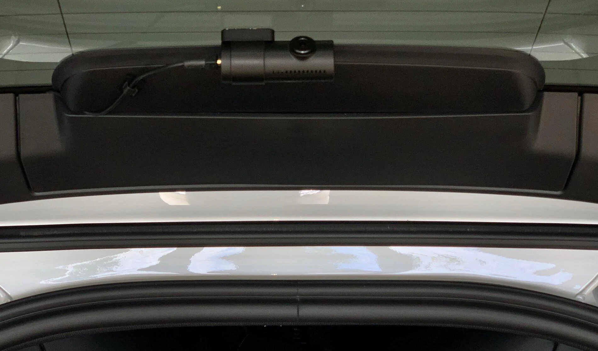

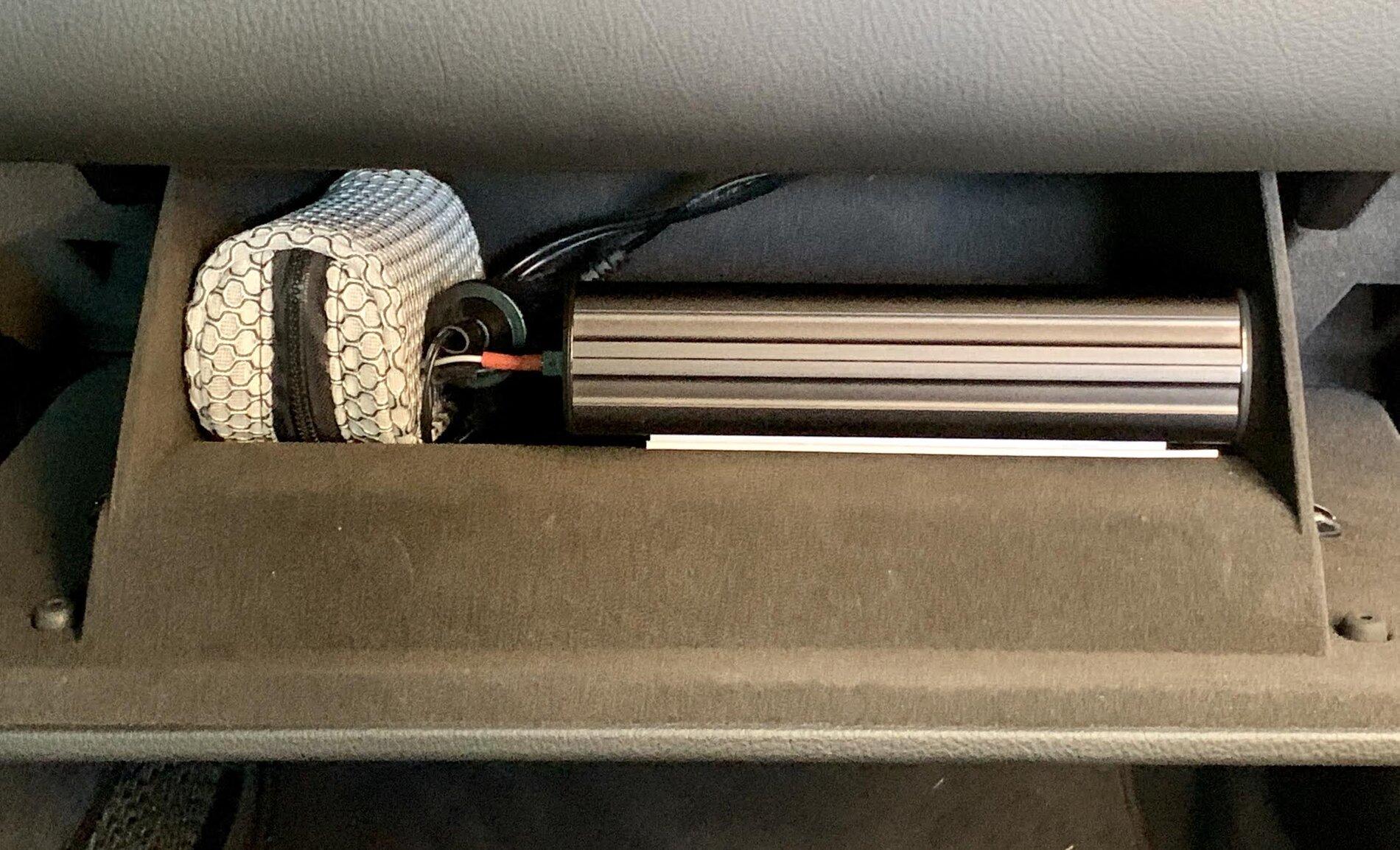

I recently reinstalled the BlackVue DR750-2CH (front and rear) cams off my last BRZ along with the Power Magic Ultra Battery (B-124).
I placed the center lens along the centerline of the car, both front and rear and ran the wires along the headliner and A-pillars down to the glovebox where I have my battery pack and hardwired it to the empty fuse (next to the 12V one) under the passenger side footwell.
I chose the glovebox for the battery pack since I like the ability to reach over and switch it completely off when I park in my garage at home.

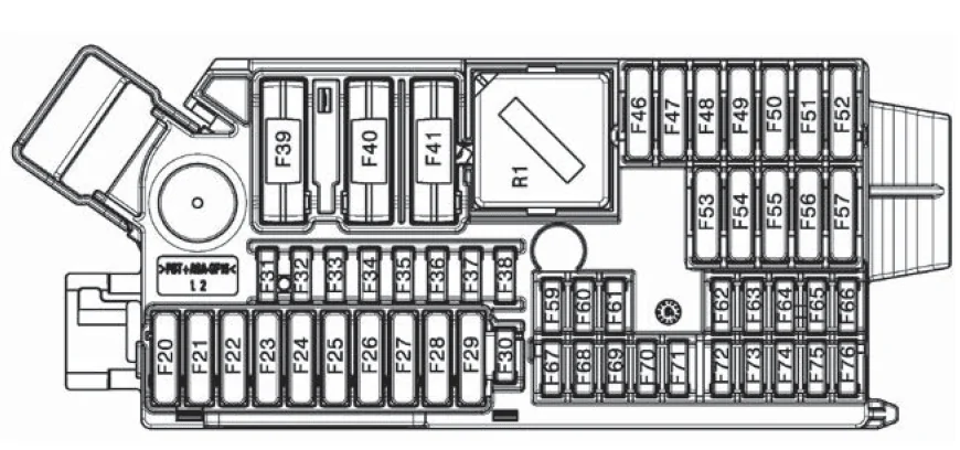

Wow, that looks very clean! Good job! The empty fuse on the passenger side, does that stay constantly on or only when the car is started? Thanks!
BA9092
Christian
Aug 1, 2020
1,213
1,650
Dallas/Fort Worth
Thank you!
I used fuse slot number F47 which is empty. It's right next to F46 which is the 12V outlet in the center console. They both turn off after 6 minutes once the car is turned off and locked.
