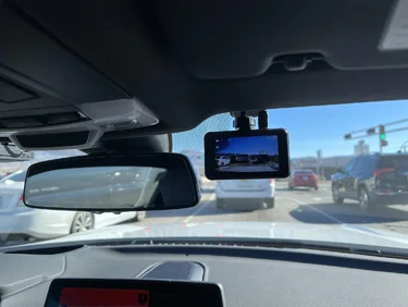

Mount mine in the same spot as diablo2112 above, puts the screen out of direct view while driving so less distractions.
I am using a cheap cam, it works fine and does the job: https://www.amazon.com/gp/product/B07XB78LTH/
I am powering it from the fuse block by the passenger footwell, using a piggyback off of one of the large fuses that are switched, even though they show hot when you first open the car and stay hot for 5-6 minutes after shutdown. Works great for both my radar and camera from the same fuse.

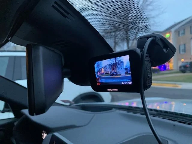

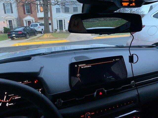

What I am doing for the time is using my Nextgen 322 (has WIFI, 1080P, GPS). Here is how I mounted it to the windshield:

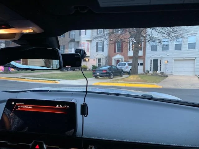

This give you an idea of how things look form the passenger's seat:
The camera is obscured by the rearview mirror from the driver's seat:
I haven't decided how I'll route the cable and connect to a power source.

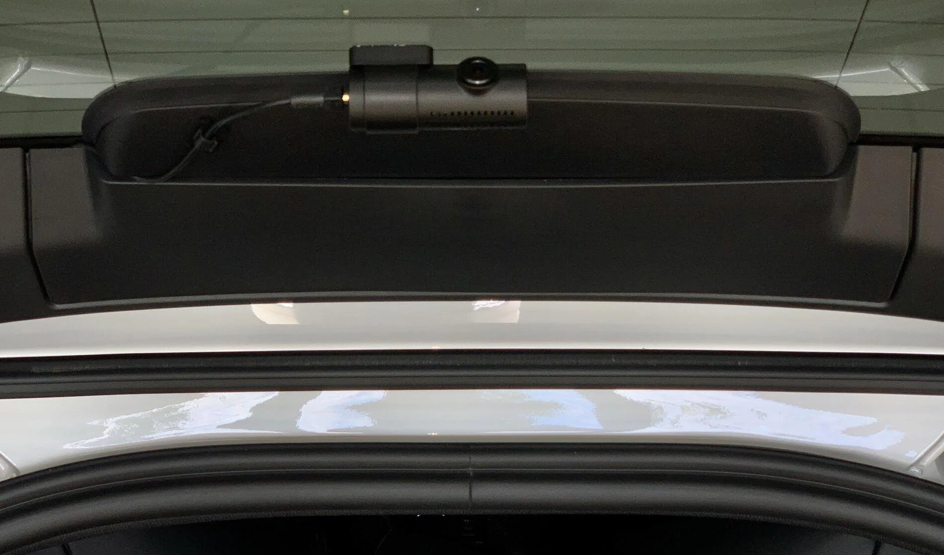

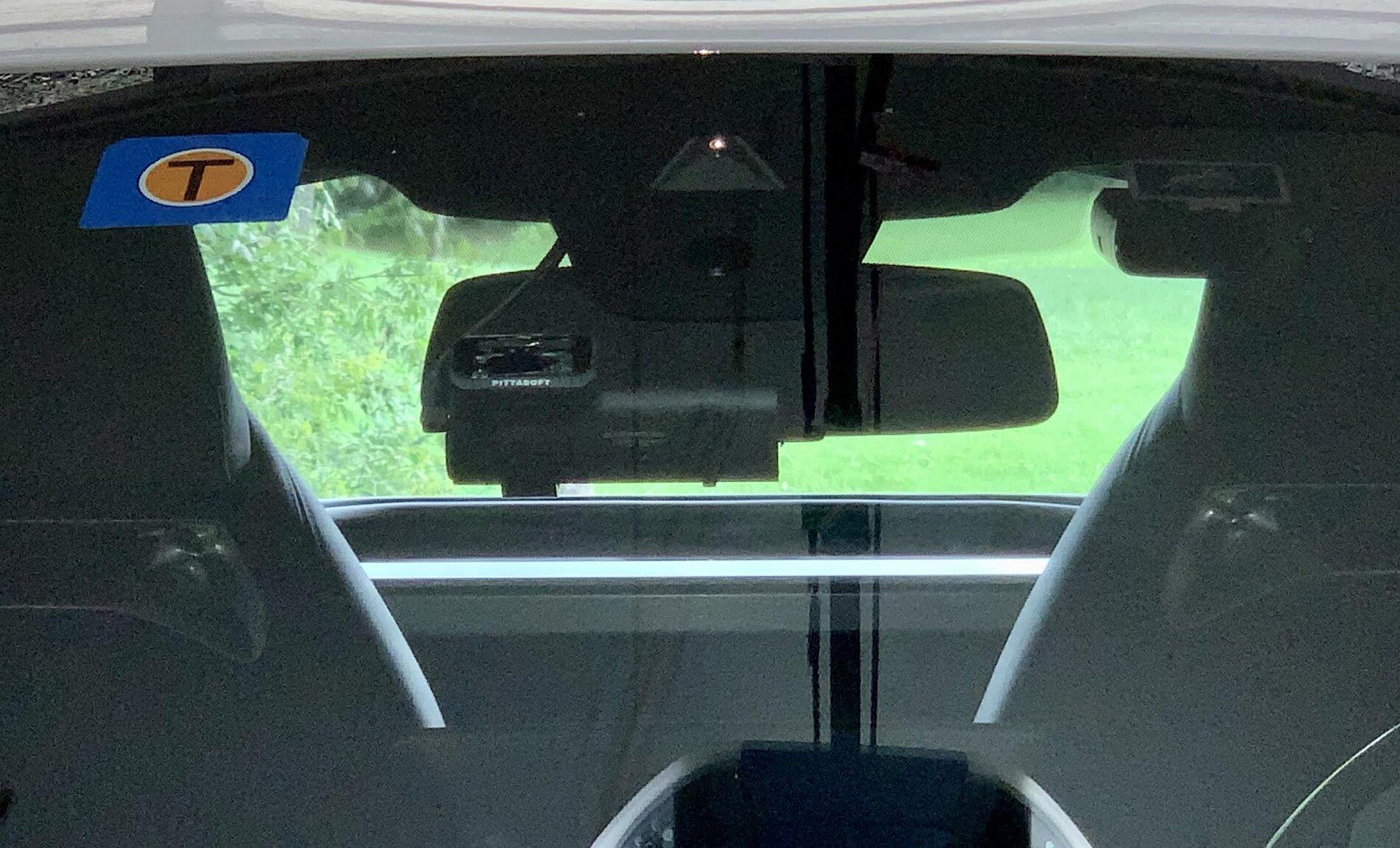

I've had the BlackVue front and rear cameras on my past 3 cars. Haven't had any issues or complaints.

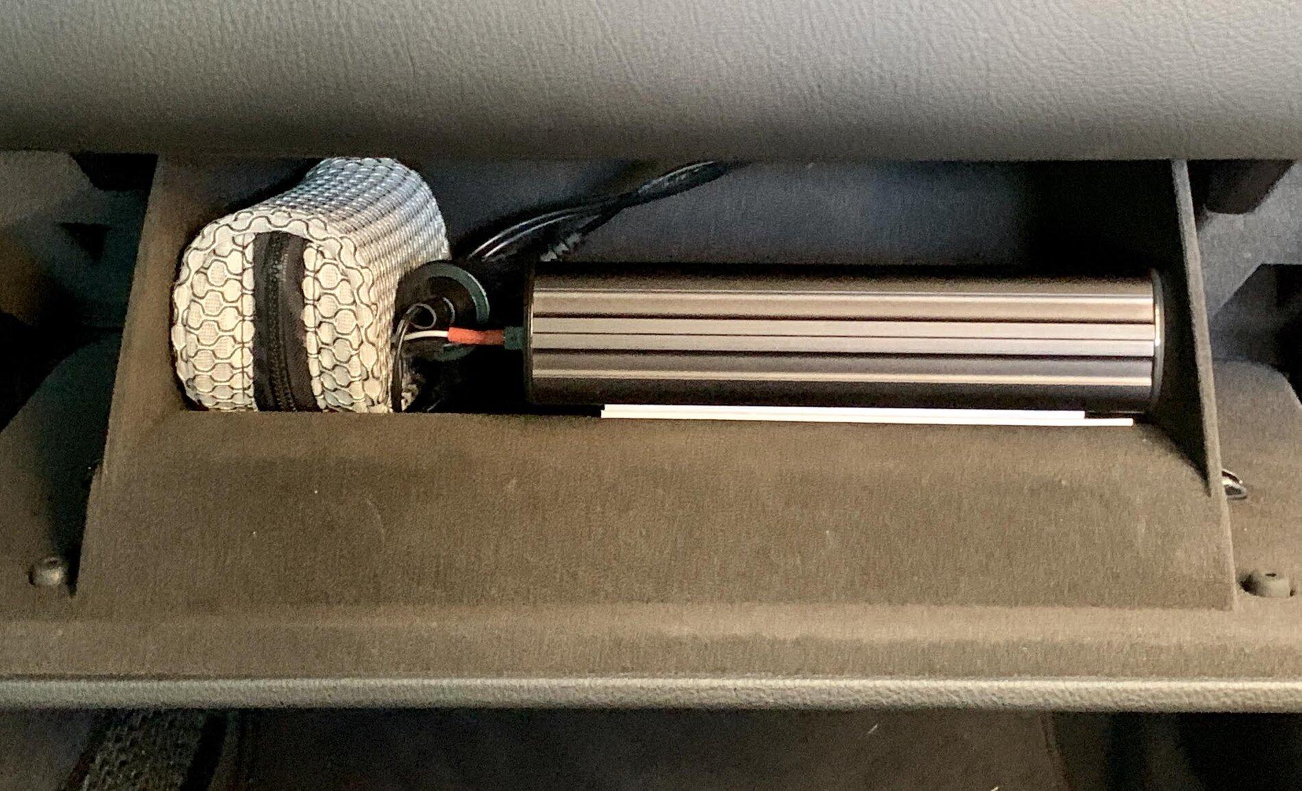

I installed the front below the rear view mirror (TX toll-tag on the left, R3 radar detector on the right), the rear camera on the 3rd brake light surround and the parking-mode battery pack in the glovebox so I can turn it off from the driver's seat when in my garage to save charge.

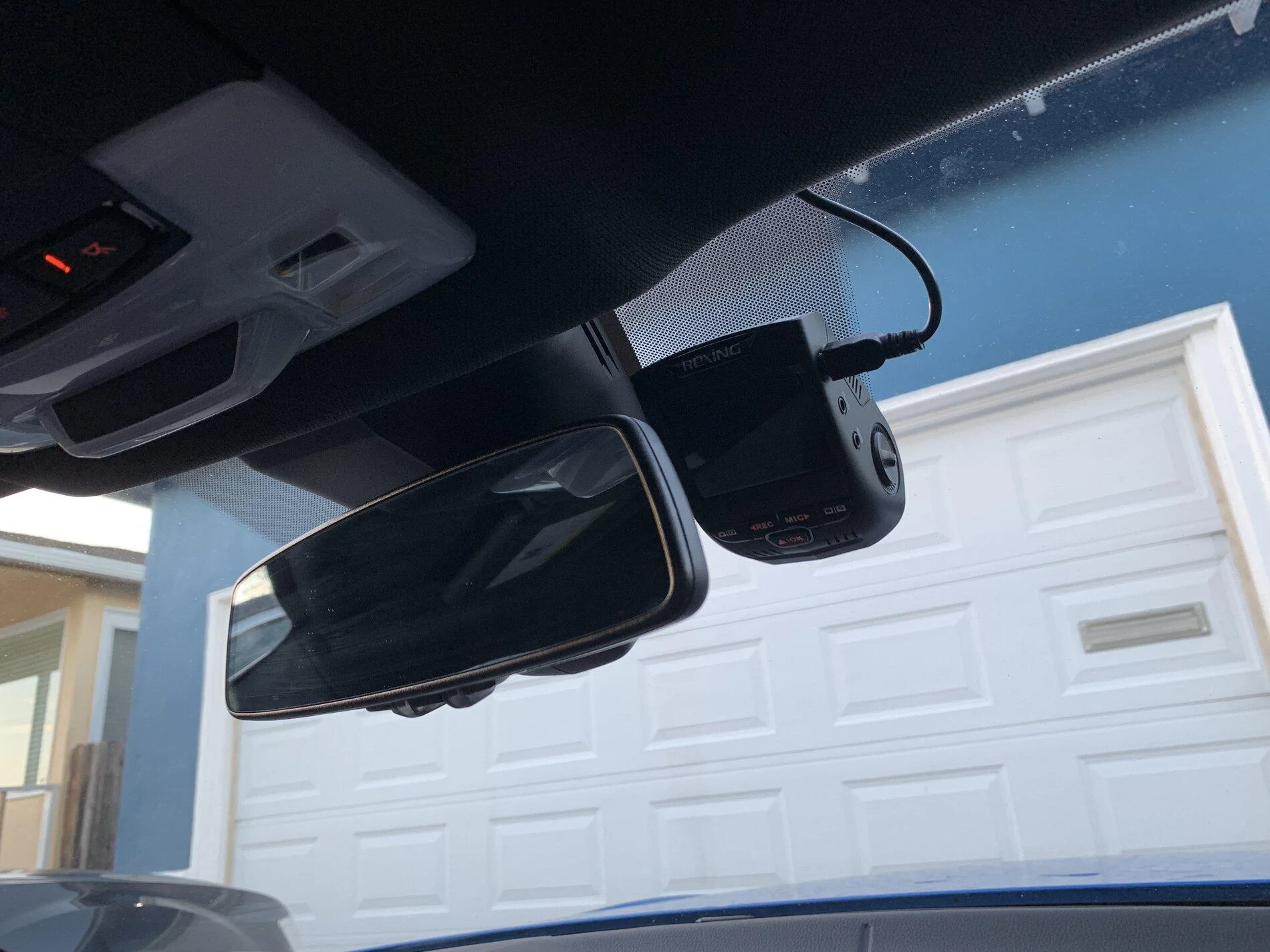

Rexing V1 Dashcam.
Wired to empty fuse spot 47 in the front fuse spot.
Is there any advantage to that over unplugging the forward camera? I put my battery in the back and rarely worry about turning it off, but I did unplug the camera for winter storage.
Good question. I never tried it. The camera plug is behind and under the rearview mirror so it's harder for me to get to and I'd want to use both hands as the DR750 plug is a tight fit.
The on/off switch for the battery pack in the glovebox is definitely a single hand only flick of the switch. That was my reason to tap it into the passenger footwell fuse location rather than in the rear hatch area. I didn't want to drain my dashcam's battery with footage of my car parked overnight in my garage.

Re: unplugging the battery vs. pulling the power wire from the camera - I do it all the time with the rear camera when I'm backed to the wall - this doubles effective parking mode recording time. Wish I could find a mini-coax cable switch. But the conclusion is that pulling the power cable from the camera is same as unplugging it on the batt side. There is no charge control / voltage step down IC chip in the fat 12v plug (battery side), so camera is the only power consumer.
