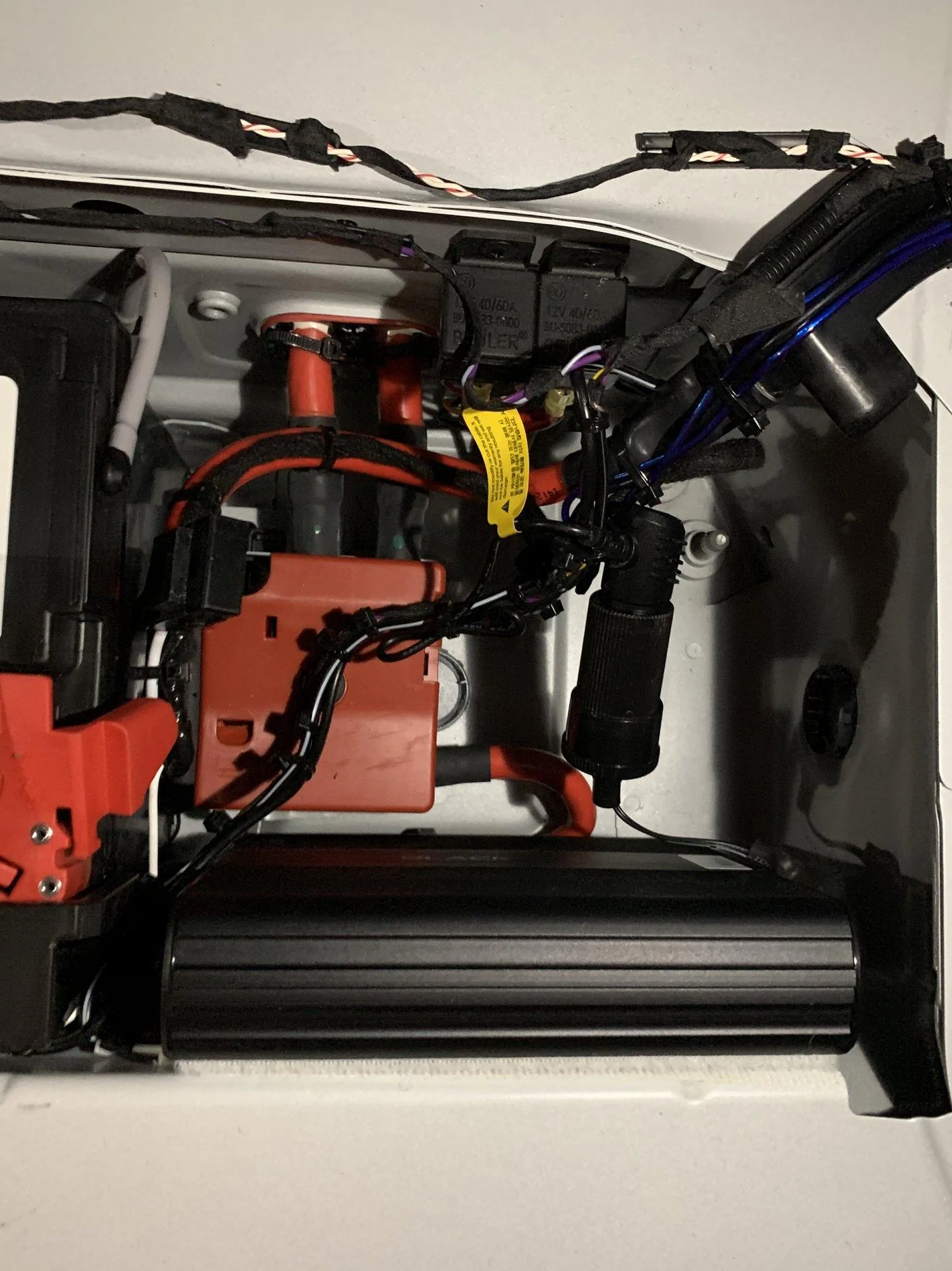

For those of you with the Blackvue battery, hard wired to your car’s fuse box, where did you all end up putting the thing? I currently have the Blackvue battery just kind of hanging out in my trunk in a IKEA Skubb but would prefer a better / more permanent solution if available (the only stipulation is that I don’t want to have it up front in the car, e.g. in the passenger side netting or glove box area).

As for the battery, it is installed right next to the car battery, fits perfect.

As for the battery, do you have anything that holds it in place back there (tape, brackets, mount, etc.)? That looks like a really clean install.
