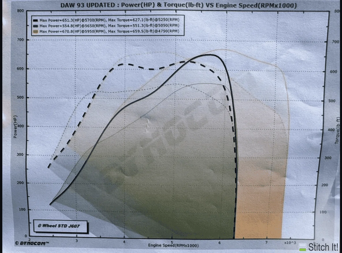

FBO and catless on DAW we did 480whp on 93 and 565 on E35. tuned by Sam. This is a91-mt. For reference. Was hoping for closer to 600 whp but was told Sam didn’t think it was a good idea for anything above 35 or he saw potential knock or some thing. Car pulls smooth and strong all the way to redline in 2nd 3rd and 4th.
That is really all that matters. As long as you are happy with the results and the car feels good.
Sometimes I ask a question: What's more important a number or reliability and how the car feels? I would believe that most anyone that follows this thread, would want the first and last. Why? Because its bragging rights..... ;)

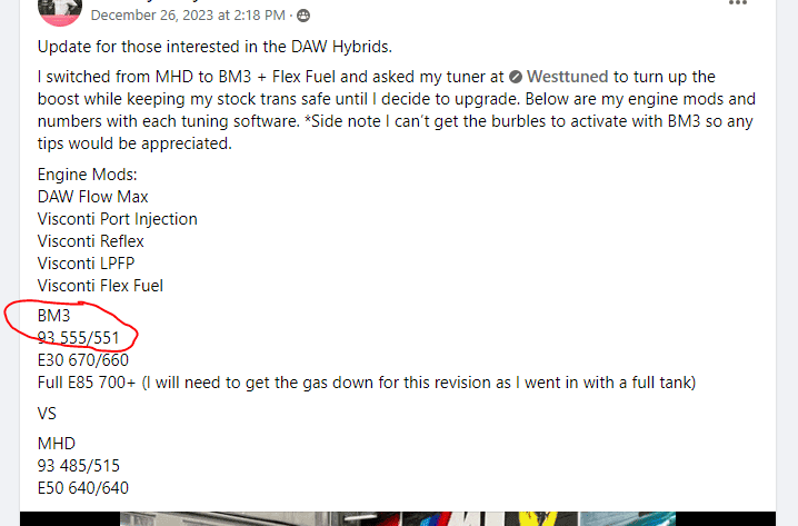

I don't want to hate on DAW or your numbers. I'm currently running an ots and a catless dp with an intake + resonator delete. I'm planning on going with remnant once I have enough money. However, I've seen people with full FBO getting 530-520 whp on 93 with pure 850 on a 2020 supra. and 2021+ getting somewhere around 540-530ish whp. I know DAW is one of the more quality and is more consistent, but isn't 480whp on 93 low for a turbo upgrade? you can push 480 or even 500whp with just a catless dp and E.
Results all vary. Dyno numbers are just numbers.
Heres a 93 car that made 550 whp on a daw.

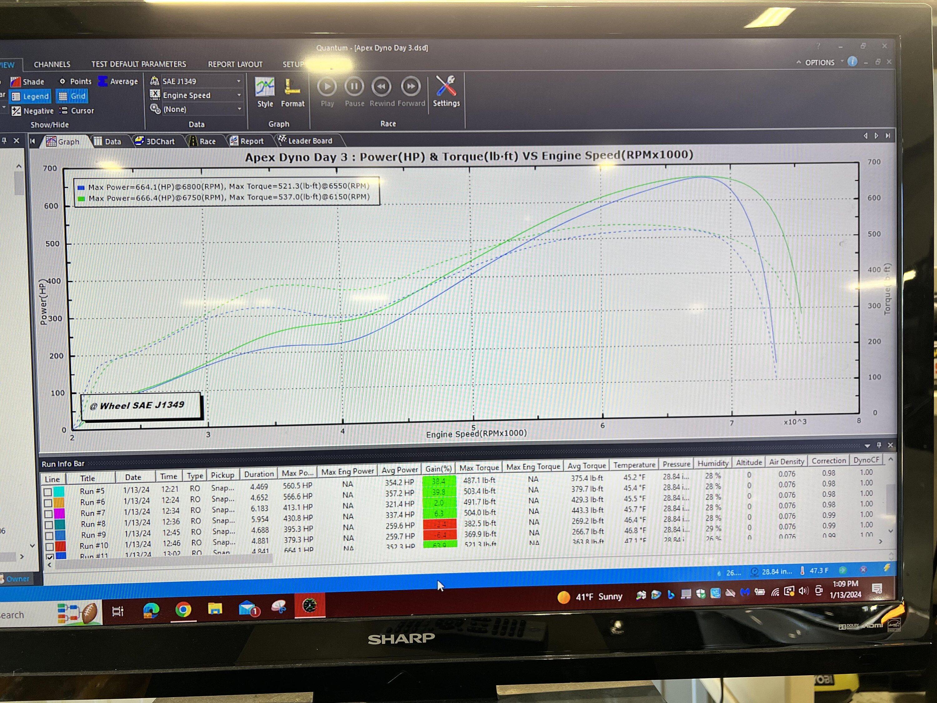

Do you have a screenshot or log of the boost on that pull? Just curious how the heads flows with a larger turbine, and whether you had to continue ramping boost to maintain that flat torque curve past 6k
You are the second one to ask me something similar. Sorry man I did not think about doing a log until after I did the final pull. I asked the shop owner, what he saw on my P3 Gauge for the boost psi. He said, "Man, I didn't even look over that way. I was looking at the computer on the wall and the car's cluster." Is this something that Botti might could answer for you in the tune?
Now these are better looking results. However I still prefer Remnant or pure850 result. Because with FBO you can achieve these numbers. This is using PI and an LPFP. However, these are phenomenal results.
