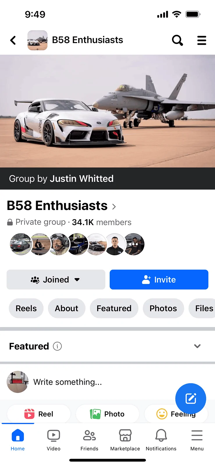

You know its funny. I posted a link to this thread in one of the B58 groups about the spool pump and they responded there. Hell another member was feeling like I was attacking them posting your issue.
Maybe try posting in the b58 Enthusiasts group and see if you get a response there.
Bilharzia
Tony
Oct 30, 2023
South Aust
'24 Supra M6, Commodore L98
Could you link to B58 group please? "B58" gets plenty of hits - not sure whether you refer to supramkv.com or elsewhere.
