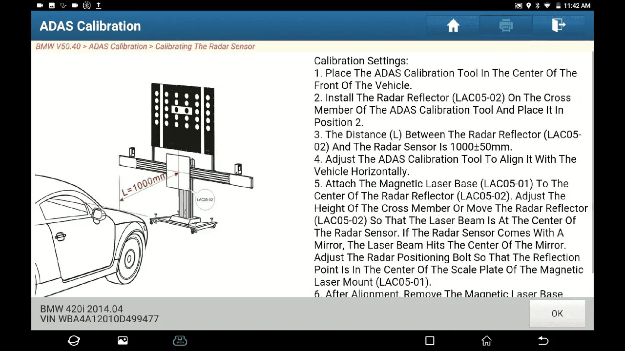

The dealer is obligated to perform a radar calibration when they perform and alignment. Any time the thrust angle has a possibility of changing, the system is supposed to be recalibrated. The dealer holds a lot more responsibility in this area than a random shop down the road, as they represent the manufacturer.

Hah, it could also be that he knew it booked for 3-4 hours, but had no idea why! That would have resulted in your car being there for several days, when he realized that he needed to order the fancy mirror tool for aligning the sensors, etc.

The radar calibration or whatever, I have no idea how much time. I would imagine it can't take more than 30 mins since it's just software.

What the book pays (3-4 hours or whatever) makes sense. We're talking about a dealership, who has relatively little experience with a Supra at all, etc. The book also calls for replacing a bunch of parts that most people wouldn't replace, etc. Lowest common denominator.
The radar calibration takes quite a while, actually. It probably takes more than 30 minutes just to setup the tool properly. If you do it by the book, it's a pretty long procedure. It isn't just software - though unless there was something really substantially changed (or broken), I can't imagine you would need to make radar position adjustments for things like dialing out .01 degrees of thrust angle. Just an example, though:
Anyway - for a simple alignment, there's zero chance I would use the dealer, assuming I had other options. If I went up over a curb or something, it might make more sense to calibrate afterwards.
