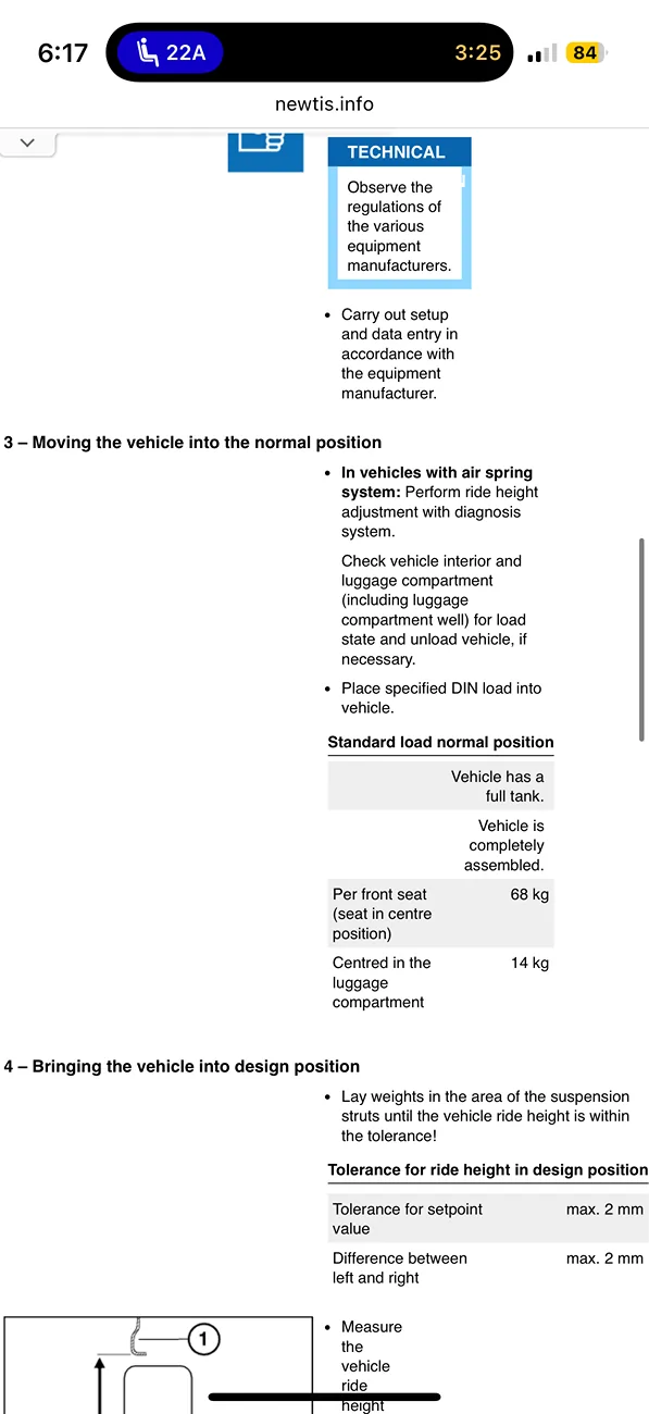

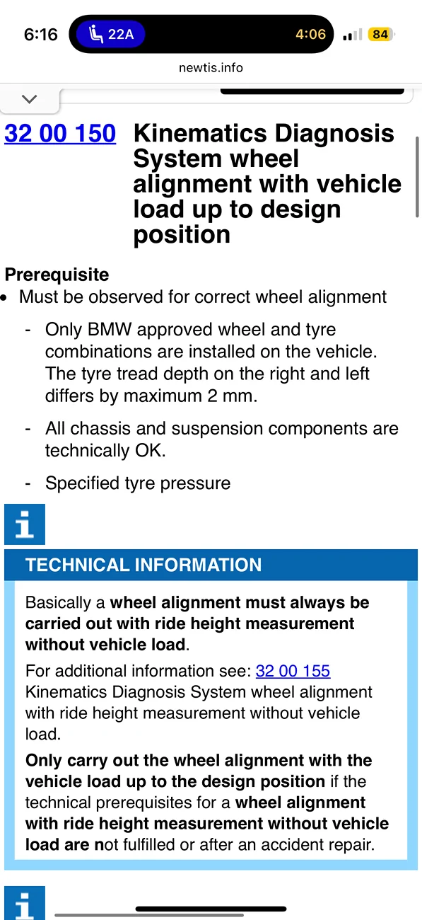

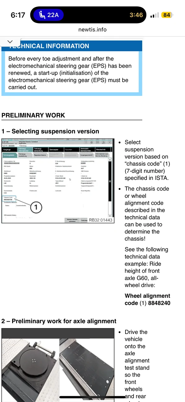

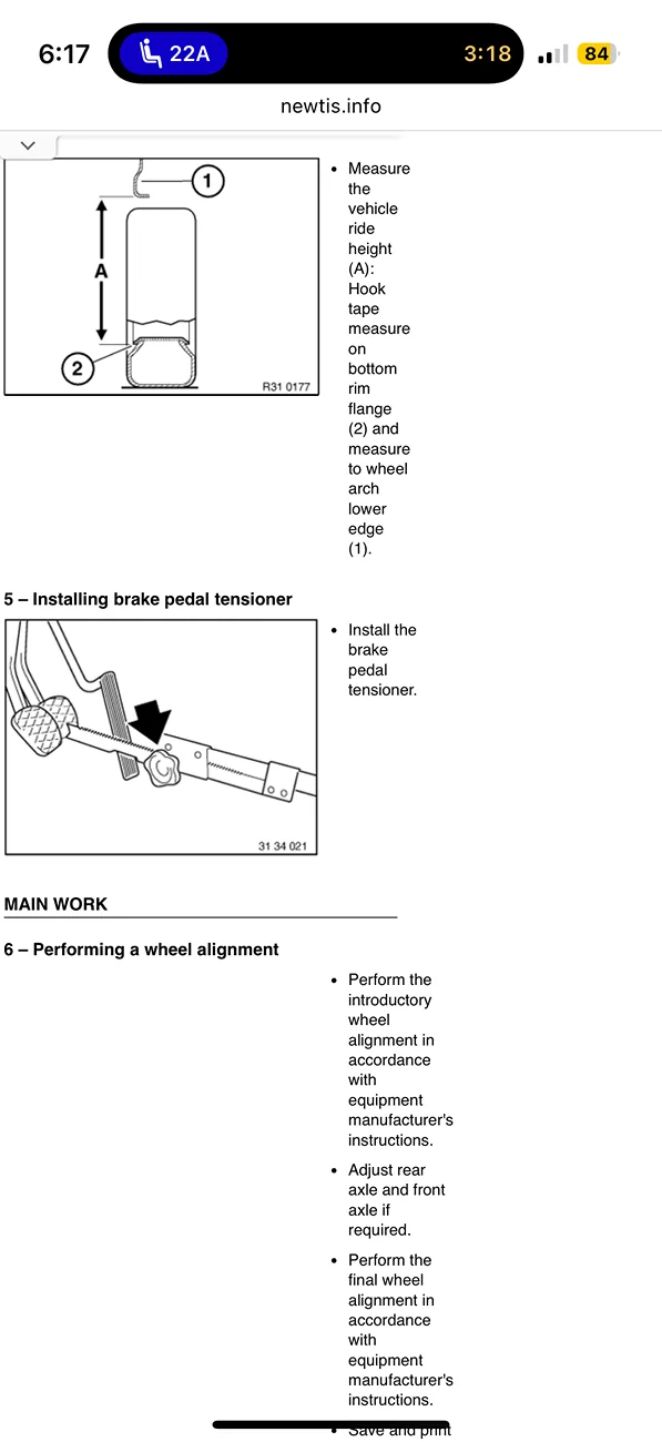

Fake news. Rule of thumb though is don’t press a shop that doesn’t want to touch your car.
have had probably 7 or 8 alignments done on my car. Never needed to clear codes or “calibrate” anything. Even the TIS doesn’t state anything like that, and they go way over the top in regards to procedures.
*edit with TIS attached
I guess I’ll go ahead and have it done somewhere else then if it’s not a big problem. I had the car aligned at the dealer when I initially lowered it. Just wasn’t happy with it
