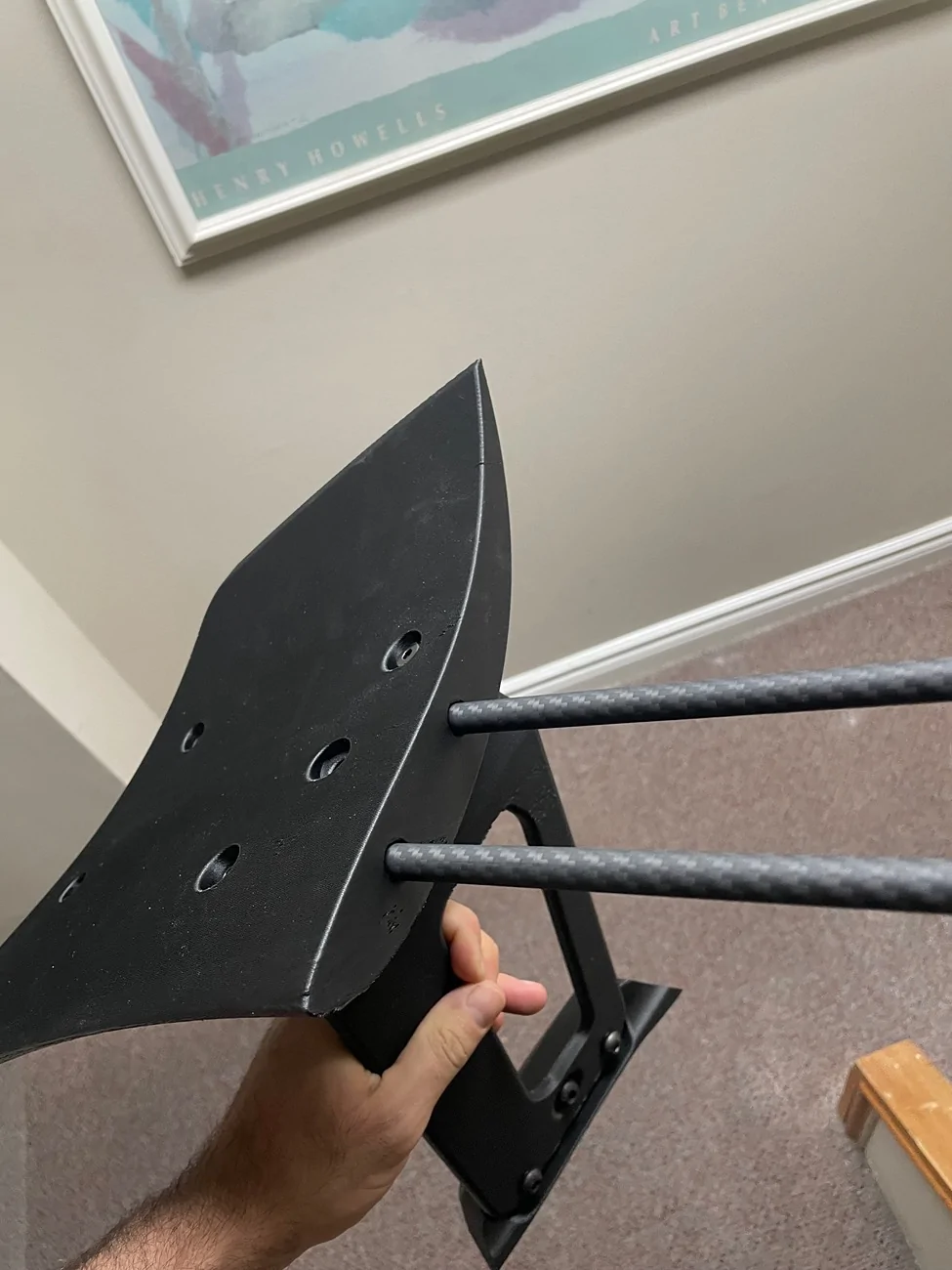

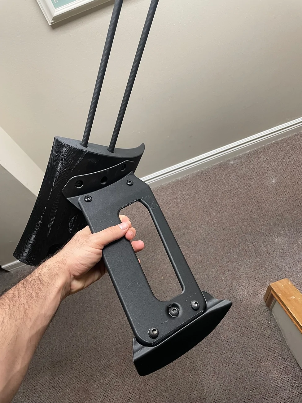

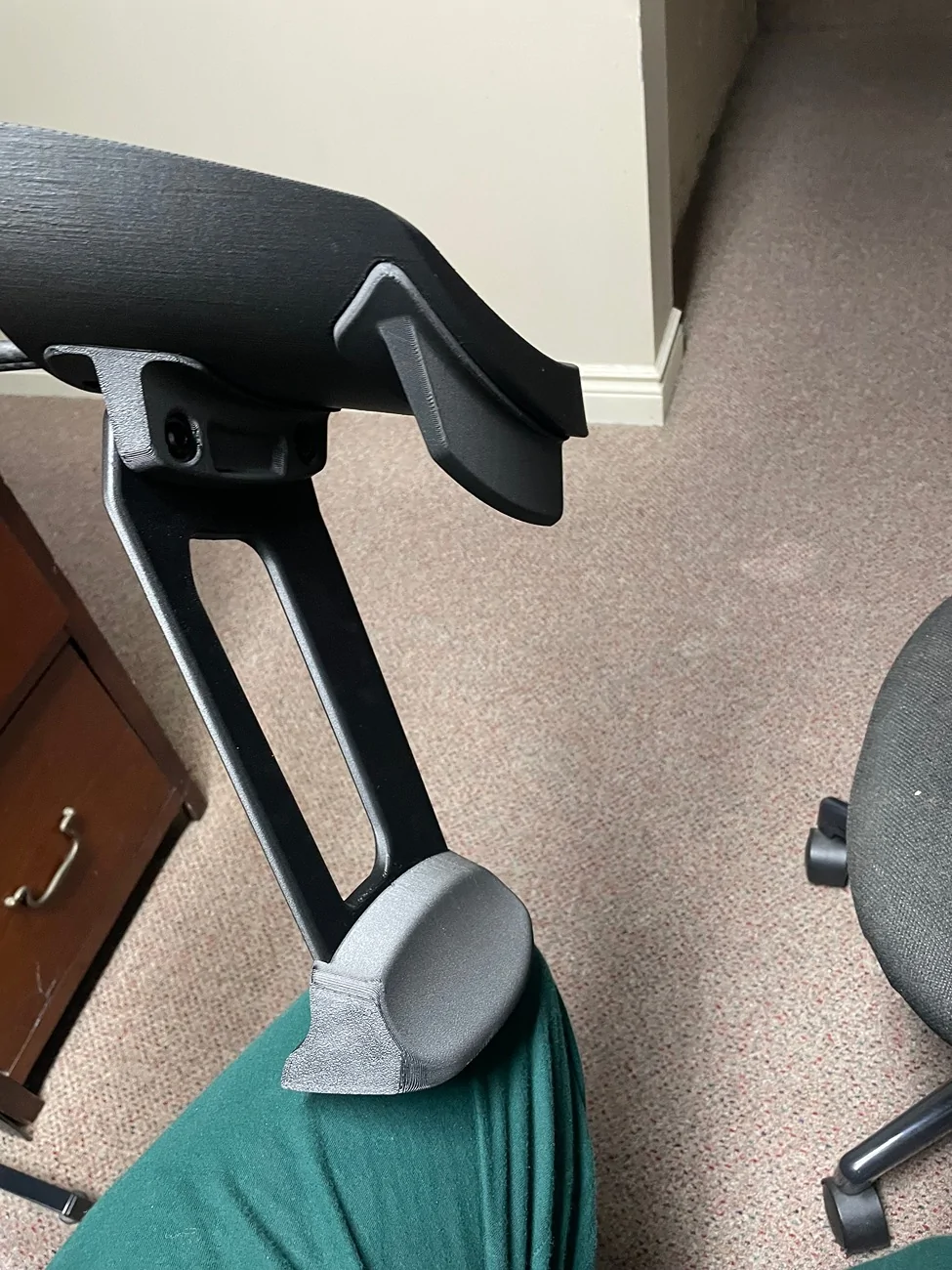

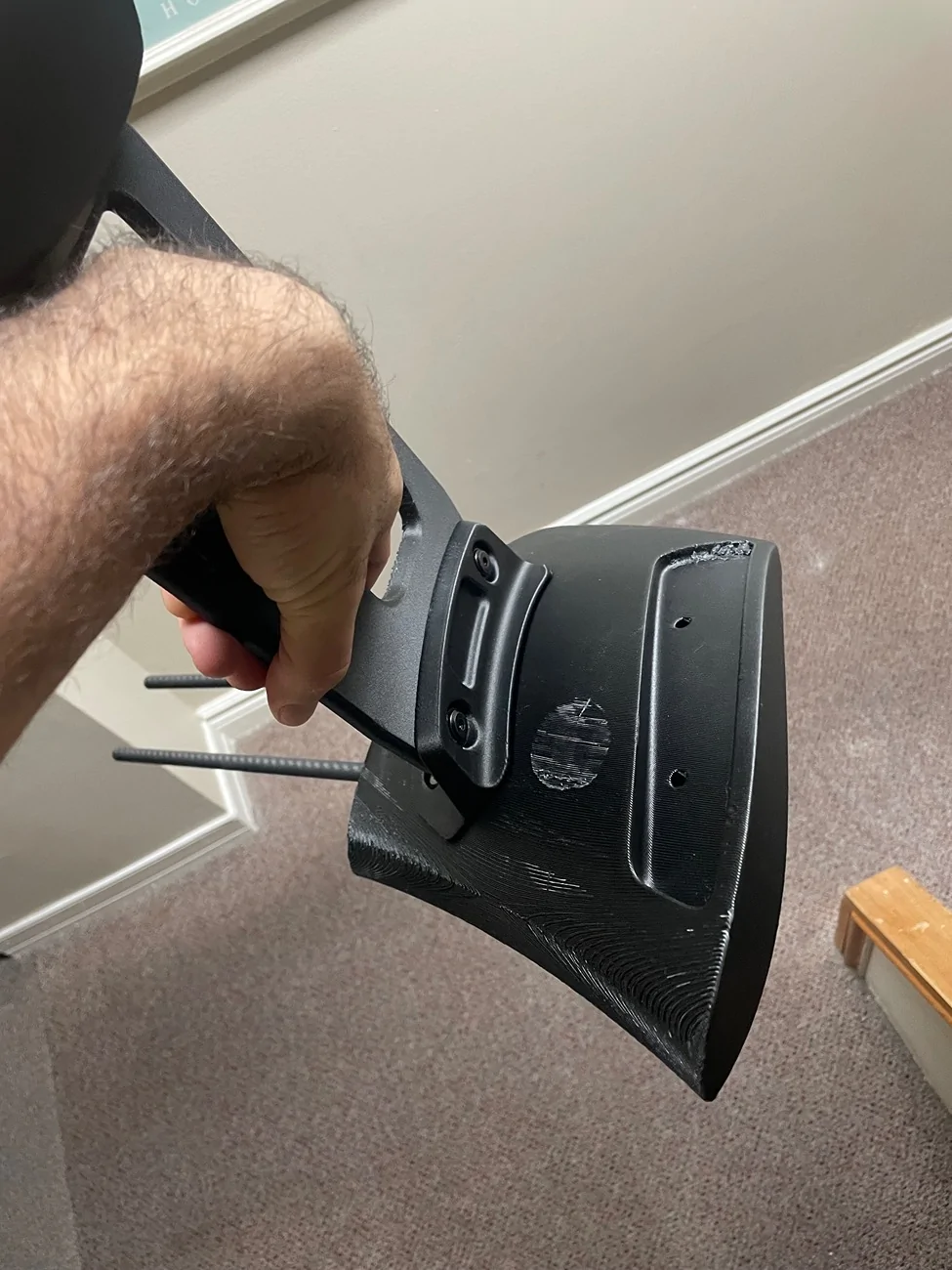

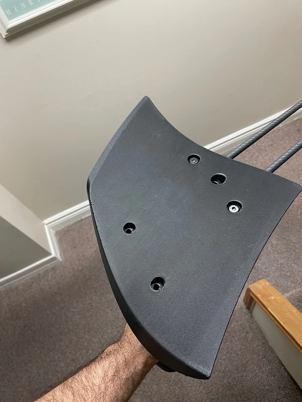

Not going to spam you guys every time something comes out the printer but this is the first piece.
Overall it came out great though i may use a different support going forward as it was more difficult to remove than expected.
The bolt sleeve and cf rod channel tolerance was a bit tight for my liking… the channel more so. You need it to be tight, but have enough room for the adhesive to build up a bit as well. I might increase the tolerance by another 0.1mm. We’ll see how the next section comes out.
the mounting locations fit perfectly though… very happy with that.
im already seeing areas of improvement so well chalk this up as prototype #1

Sick! Looks good so far. Dont worry about spam. Each update just bumps it for more visibility. Its in your best interest 😉

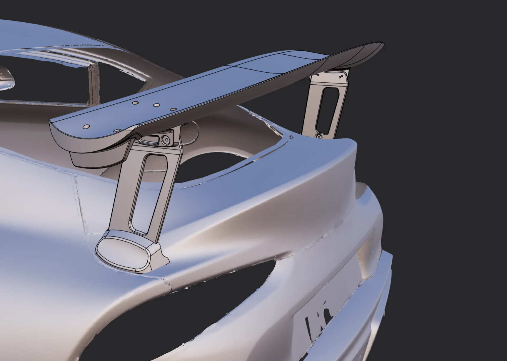

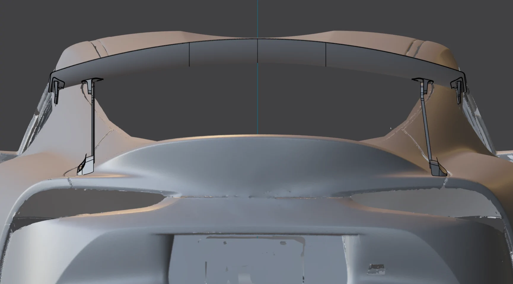

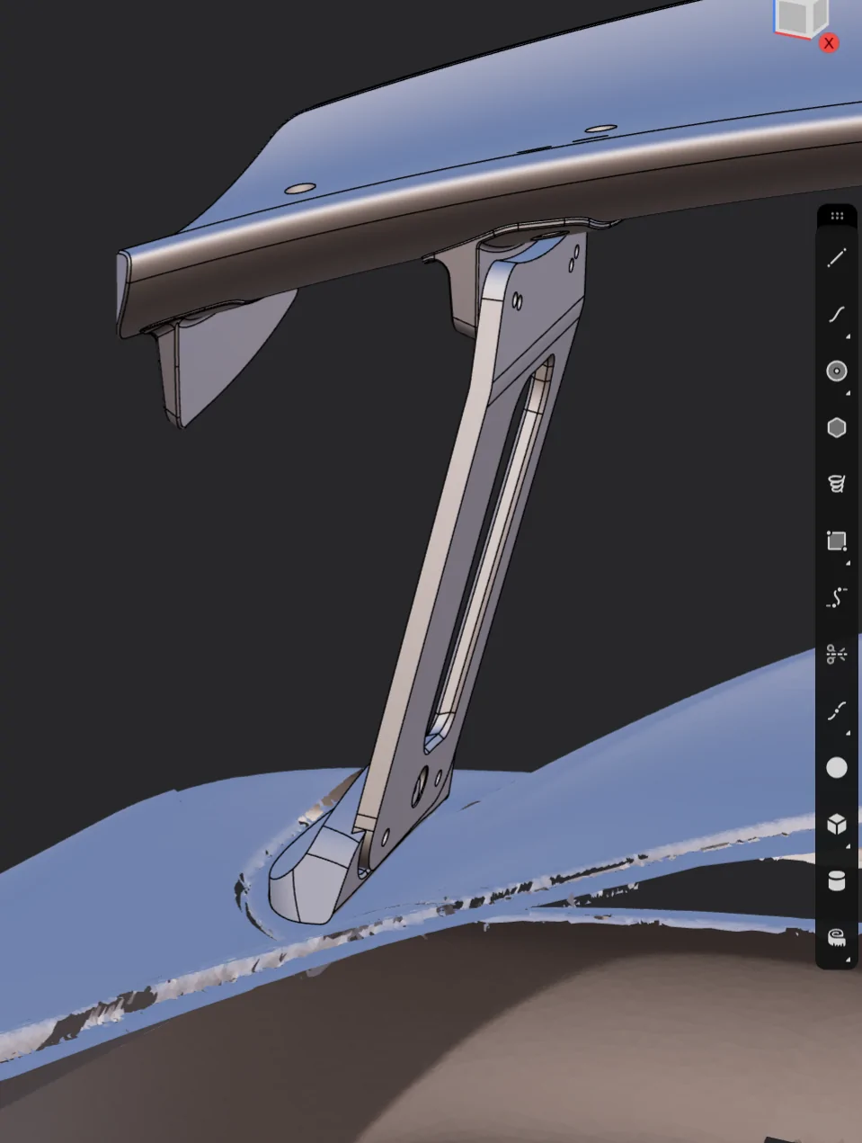

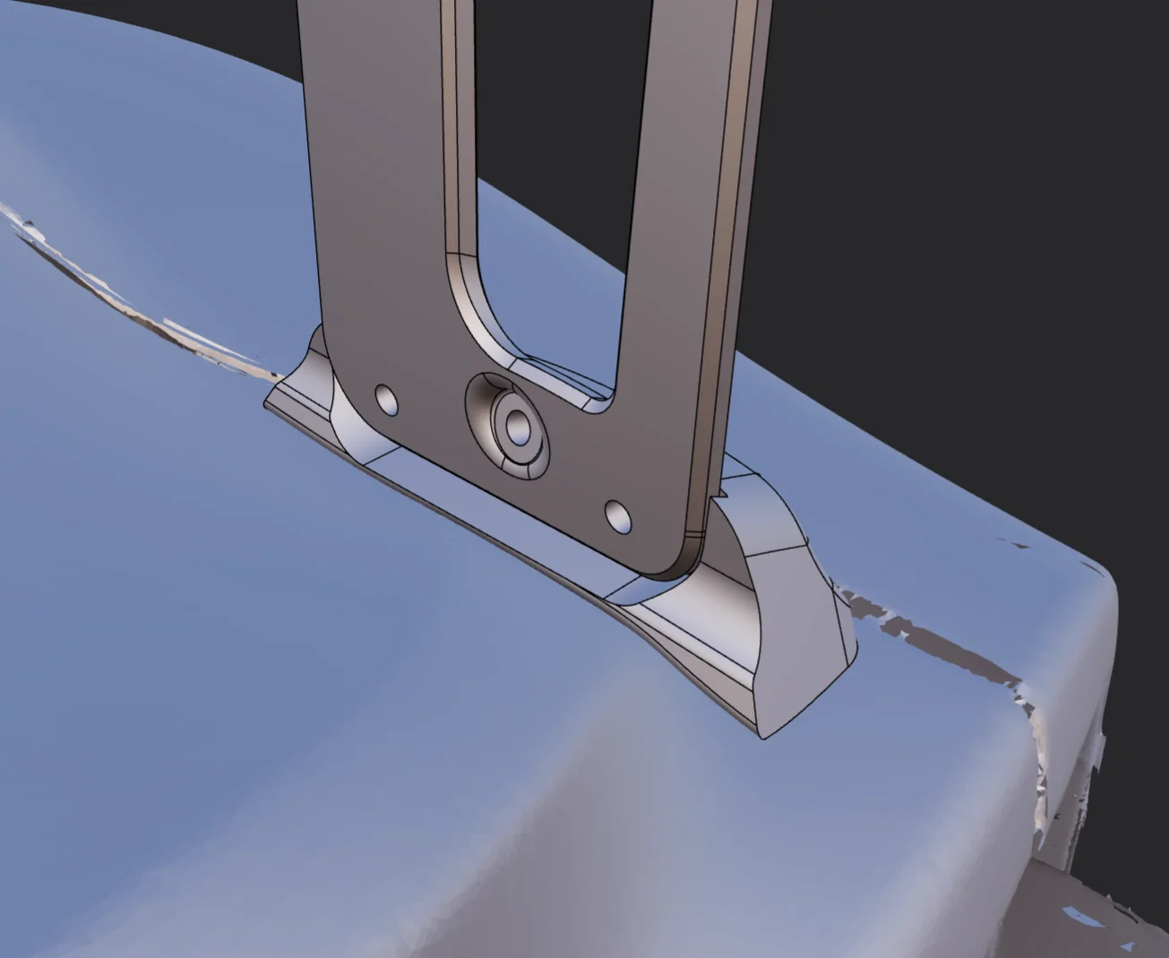

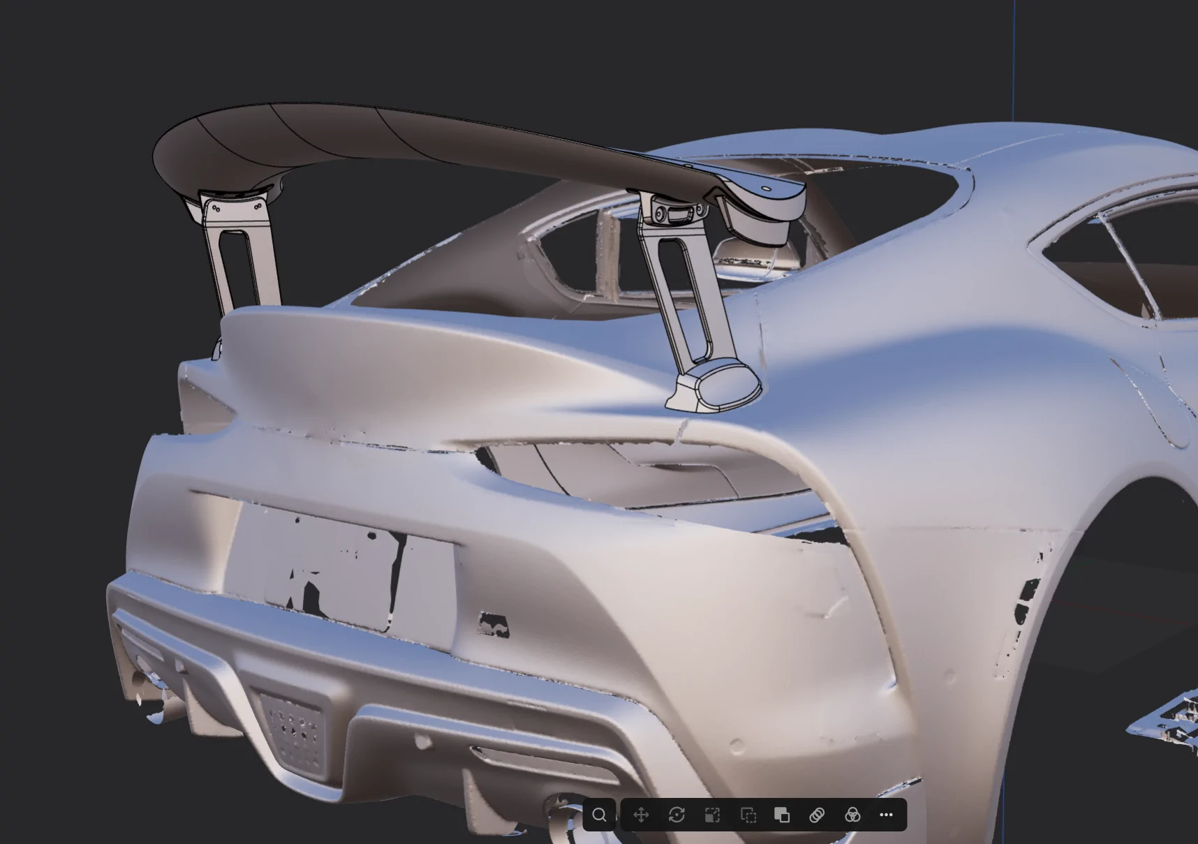

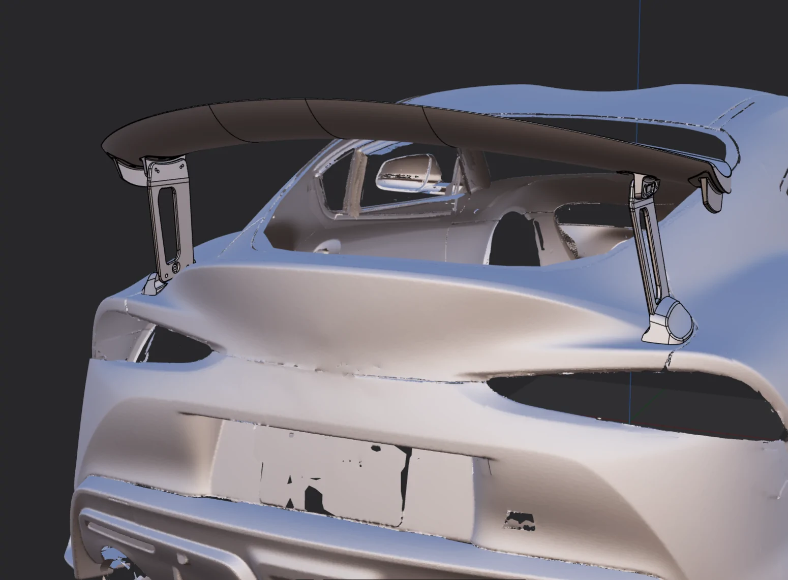

I was able to slant (with minimal design changes) the riser to push the bottom mount closer to the edge of the trunk, effectively giving it more space in case some people may want to run a ducktail in junction. @rwense Let me know what you think.
Also added a secondary more aggressive AoA, adding 4 deg (11 total) the entire deck needs to be uninstalled and repositioned (best I could do given the bolt diameters and already aggressive aoa) but its only 4 bolts.
The top section remained unchanged.
Edit: youll notice the trunk mounts have a bit of an extension to add a bit more surface area. I felt it completed the look and didnt add much material, ducktail should still be able to ( not confirmed, educated guess)
That last photo, rear 3/4 shot 😍

Looking amazing. I am wondering if it sits too high? Over all looking awesome.
Thank you!
Currently sits 320mm from the top middle of the wing to the top middle of the trunk. Its shorter than APR's gtc wing by 10-35mm respectively. If i go shorter, rear visibility gets worse and the air stream isn't as good. Hard to say exactly how high the FT-1 wing is but it looks like its at least 280mm tall. Mine has a larger chord and span which was needed to keep the proportions right.
I was thinking of making a smaller wing, something more low profile like the Camaro ZL1 or Mustang GT500 after this one is done. I have an older version of this wing I could lower and stretch out a bit, keep the mounts and just redesign the uprights... a shorty version is possible
