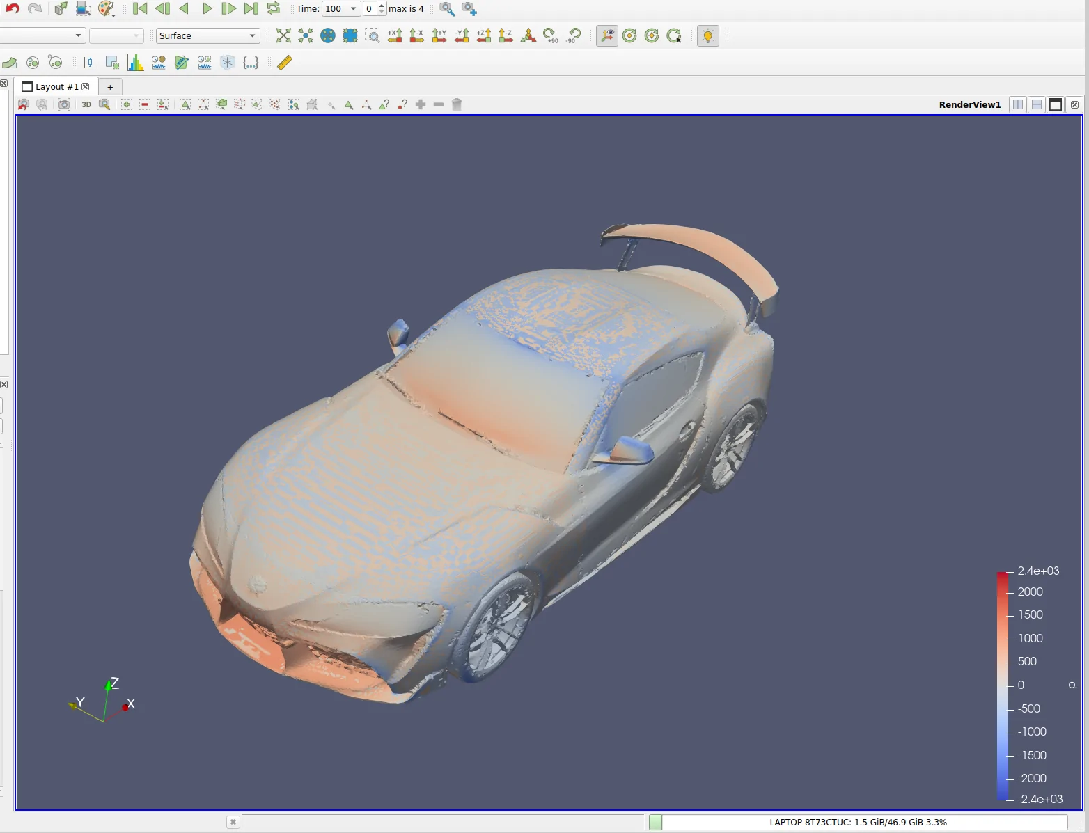

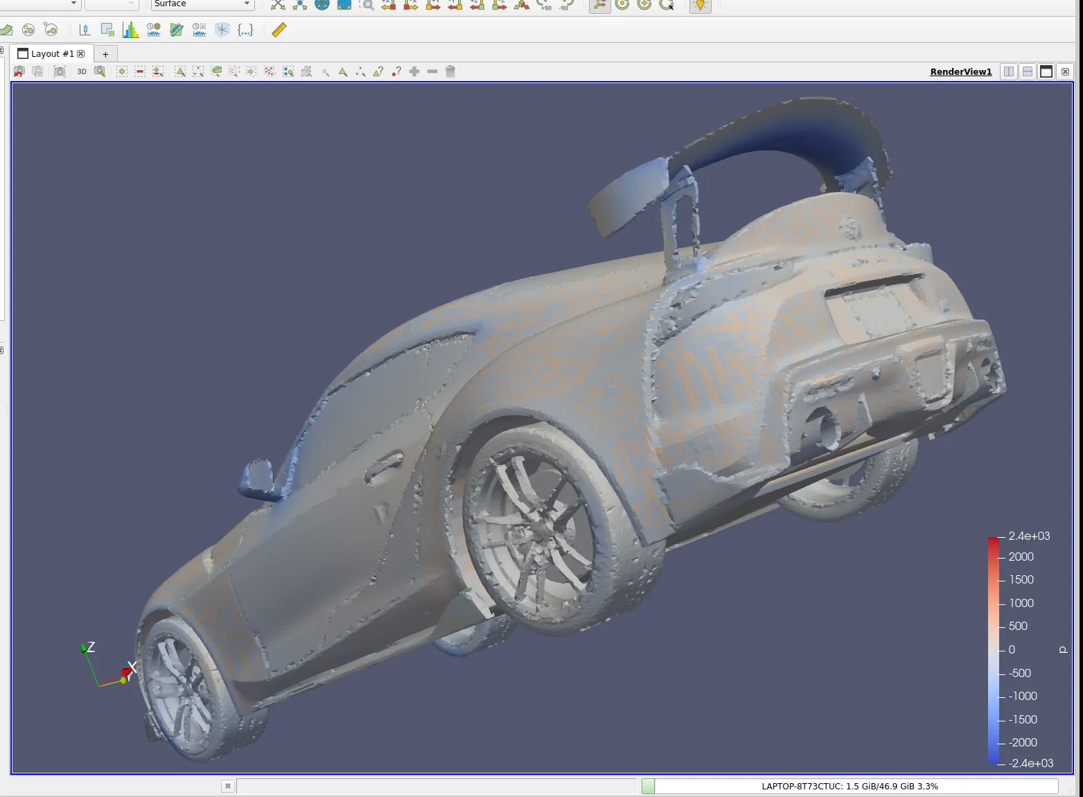

First CFD test done!
Theres a few things i learned from this but before i get into that here are the results:
Downforce @ 144kmph (90 mph) 140lbs (105 lbs once you cancel out lift produced without the wing)
Drag: 250lbs ***
the plus side is OpenFoam is working and I can finally do successful testing and we do downforce being produced..
Downside is the fact that this test was unreliable.
I need to do a test without the wing and subtract whatever drag is produced from that test because the STL I bought is not 100% watertight despite repairing as much as possible AND it includes the interior, ill need to buy a shell STL only. The test was only 87K cells, normal cell count for a quality test is around 1+ million. That 250lbs drag is total drag, not drag produced by the wing, so i need to do the wingless test to know what is added vs existing ***
So.. we have 140 lbs DF, but not ideal STL, lower cell count (test) and generally not reliable drag data*** but this a good first step. Ill update this post once i do the test without the wing. Ill also do a few more runs and tweak some settings and optimize the simulation parameters and try get better quality data.
Im also considering a built in 6mm tall gurney. So itll fun to see how that affects the results
After that, i align the mounting holes and do a test fit, ill look into an engineering firm to give me solid numbers but so far this is great progress.
***UPDATE***
Car alone is 230 lbs of Drag. the wing add 140 lbs of DF but only 20 lbs of drag
The Design looks solid for the time being...

In general, i would avoid making CFD claims that you have run yourself, unless you have a academic/professional background in it. You will get torn apart by real aero experts (which I am not).
CFD analysis is typically done in steps.
1. Standalone wing. Use a wing with a lot of published data ike s1223, make sure this matches the published papers.
2. DrivAer open source reference model, match the different reference conditions. These first two steps should be as close as possible, because there are other published calibrations you can compare to. Changes to your cfd settings should be carried back to Step 1 to make sure that those results remain consistent.
3. Supra model, does it match toyota published cd? This one might be a bit off because we know that manufacturers like the cherry pick the condition to a publish this number.
4. Then do the car+wing downforce calculation.
5. The difficulty of 2,3,4 is why a lot of wing cfd is done free stream. Because if your car model is garbage, then it'll make your wing result garbage as well. Whereas free stream wing data has less variables to pollute it.
That being said, 140 lb @ 90 works out to be 248 @ 120. This seems a bit ambitious to me, given the relatively small wing area.

In general, i would avoid making CFD claims that you have run yourself, unless you have a academic/professional background in it. You will get torn apart by real experts (which i am not).
Thats fair enough… i took this simulation as more of an “it seems to work and i didn’t completely waste my time” approach. It was nice to see something that looks like an actual test. There’s some caveats in this case so its not 100% accurate. Im still going to pass this off to an engineering team but its nice to know im heading/designing in the right direction (seemingly)
The 140lbs @90 i agree seems a bit too good to be true. The cell count was only 87k … a 1+ million cell test will be much more accurate. Even if it just neutralizes lift at 60mph/ 100kmph i think that would be a decent result
