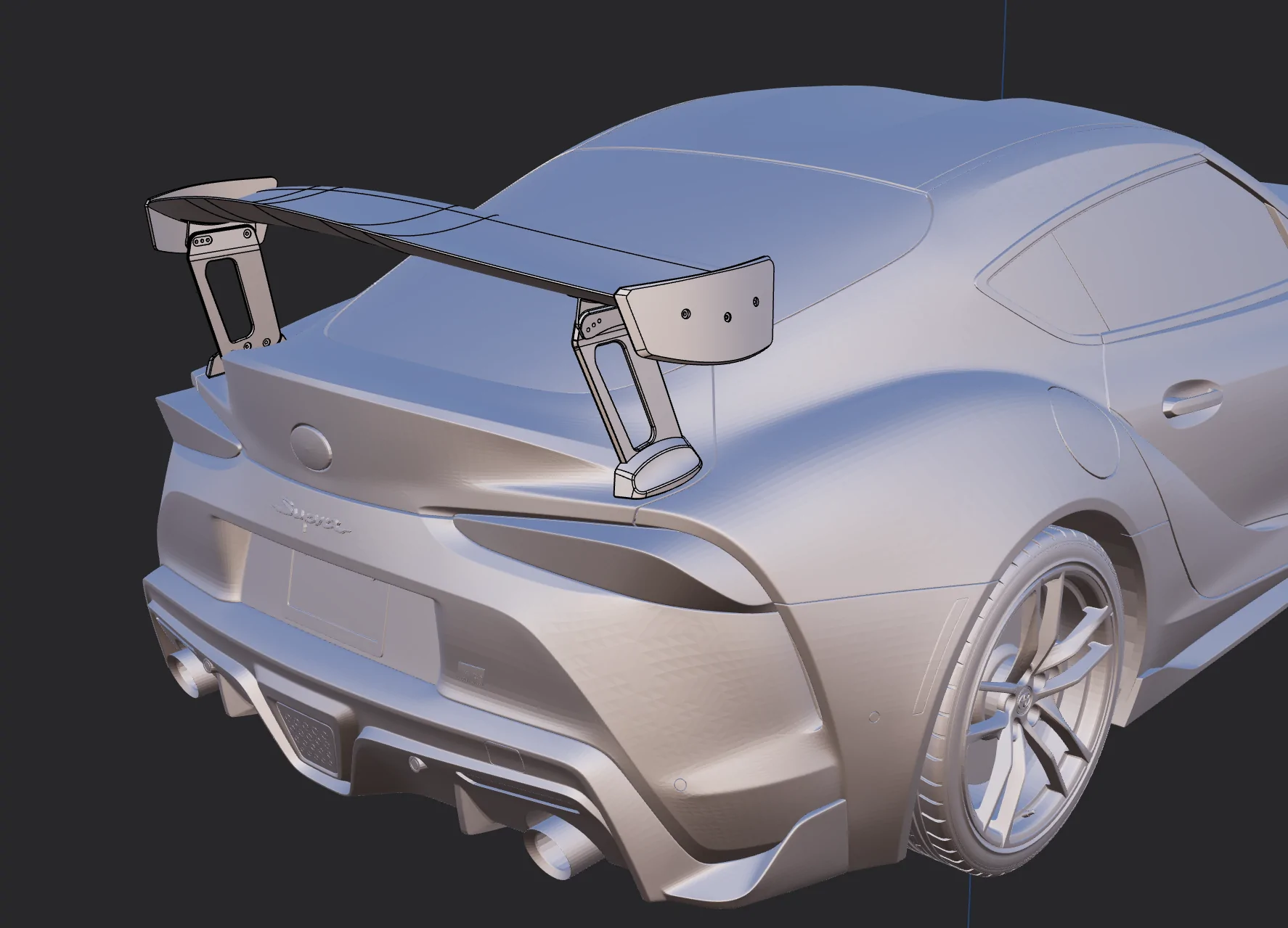

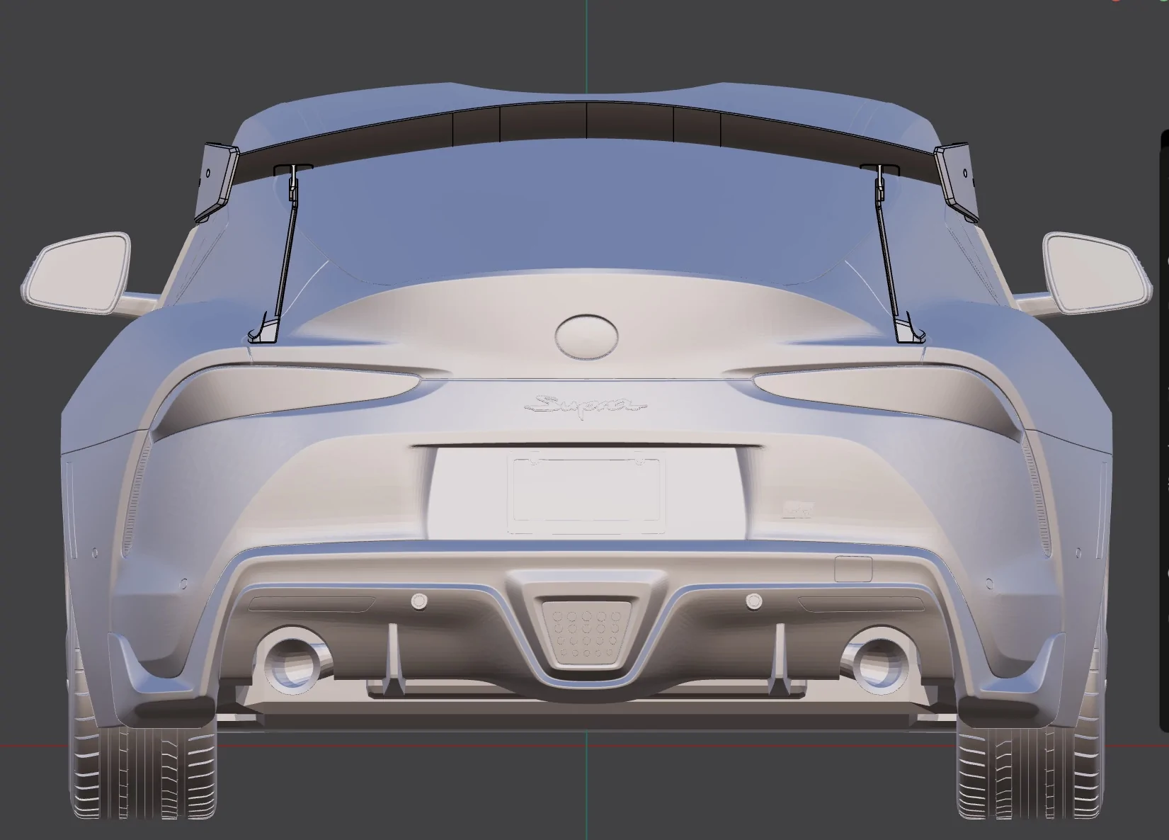

Using this model to showcase the wing from now on. Its much cleaner than the scan data and its the model Ive been using for the testing.
So curious. There’s probably more physics to this that I’ve forgot about but I see most wings on brackets that are angled back. Doesn’t this create torque on the bolts and some opposing/ lost downward force? What if the brackets were angled forward in such a way so that all the force is now perpendicular to the rear of the car?
Yeah you can do that, it’s just different ways of transferring the load.
The wing’s still making the same downforce regardless of the bracket angle, so you’re not really losing anything there. Unless you go swan neck, they tend to make a bit more df because that setup doesn’t disrupt the low pressure side of the wing. Downforce is way more about the wing’s angle to the airflow than how the brackets are positioned.
The angle of the riser mostly just changes how that force gets handled by the mounts. The bigger factor for torque is just how high the wing sits off the trunk, not just whether the brackets lean forward or back. Height and crazy angle, now you've got a lot of load. You’d also need significant flex before you’d ever see any real loss in effectiveness.

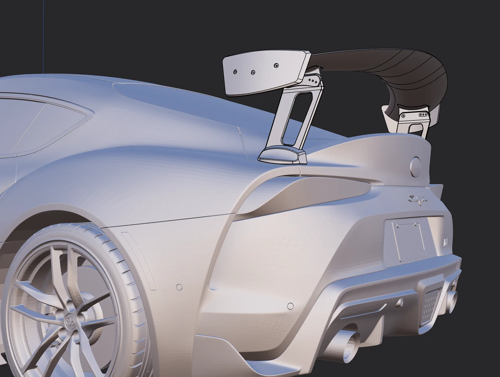

under trunk supports done (not 100% , still need to pocket them) 15mm thick. Even with the scan data and blue laser scanner, there was still a bit of mess in the mesh. I got my surfaces as close as possible and this is the result.
I should be ready or at least close to doing a full 1:1 scale print. The previous printable version ate filament like crazy... now that printing this isn't the goal, I can use less wall thickness and save a lot of filament but more importantly print time.
Hoping to get a test print soon..

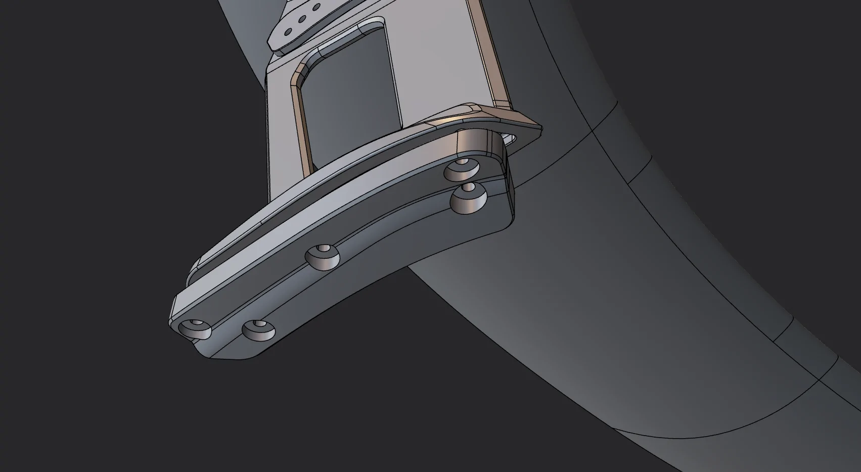

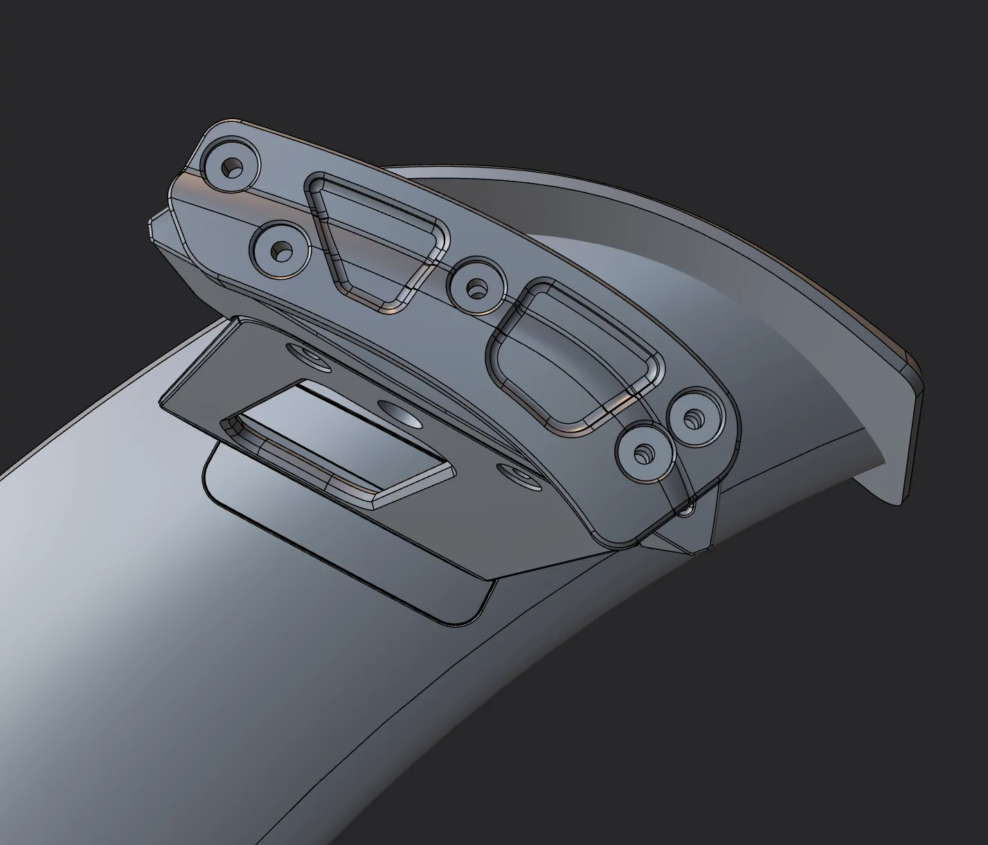

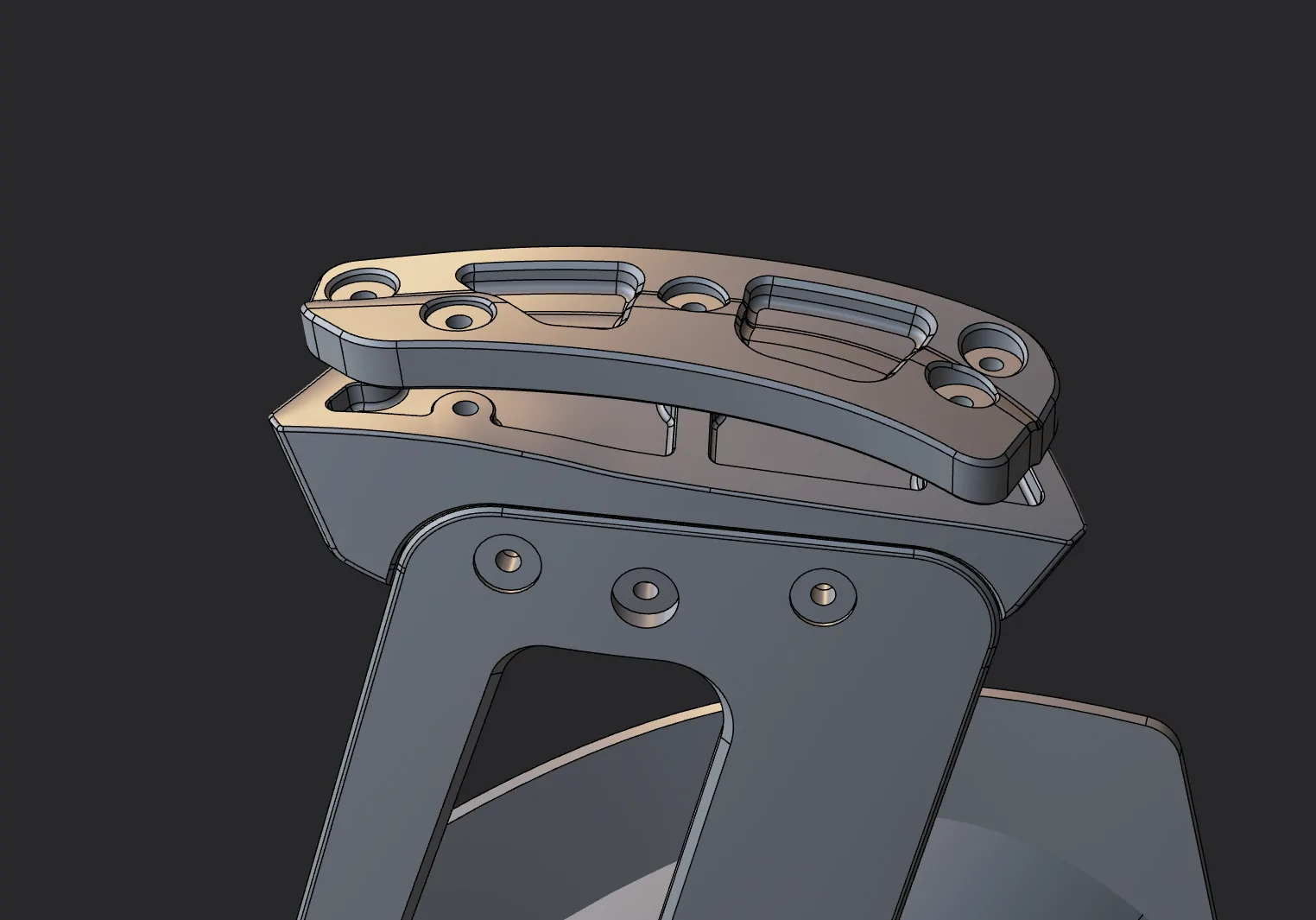

Didn't go too crazy on the styling on the pockets for the trunk support, but they are pretty much done. Im just more excited to finally have them done as they were the missing puzzle piece.

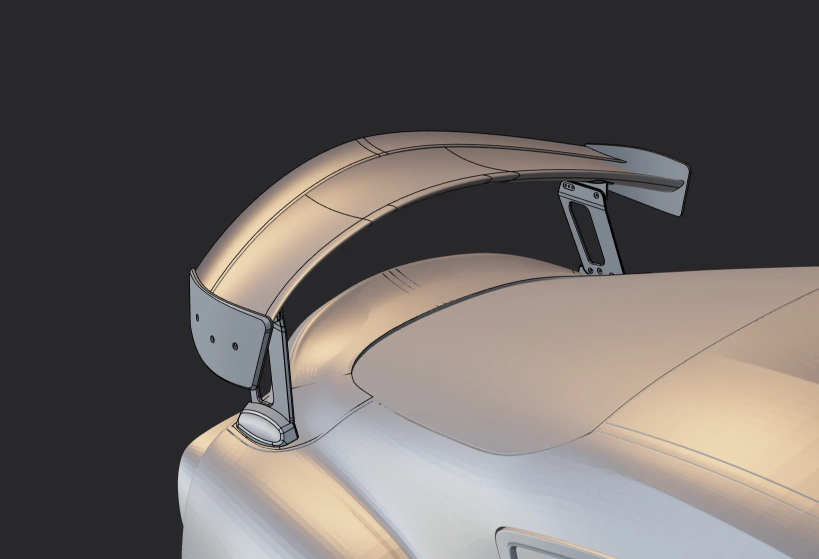

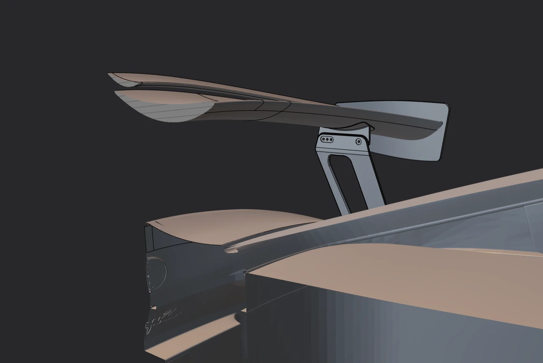

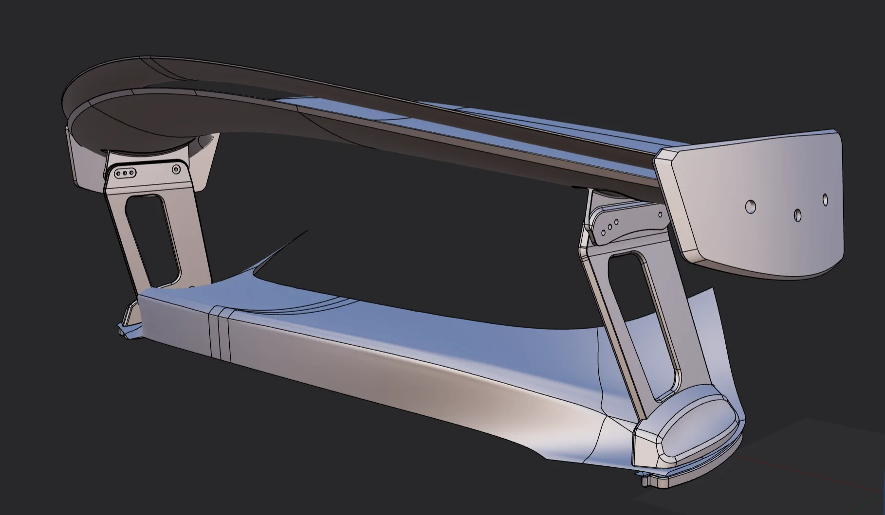

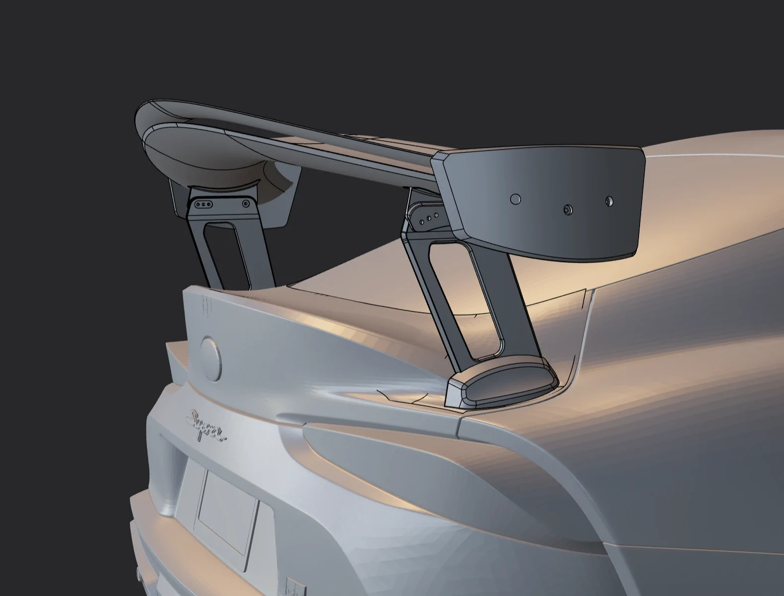

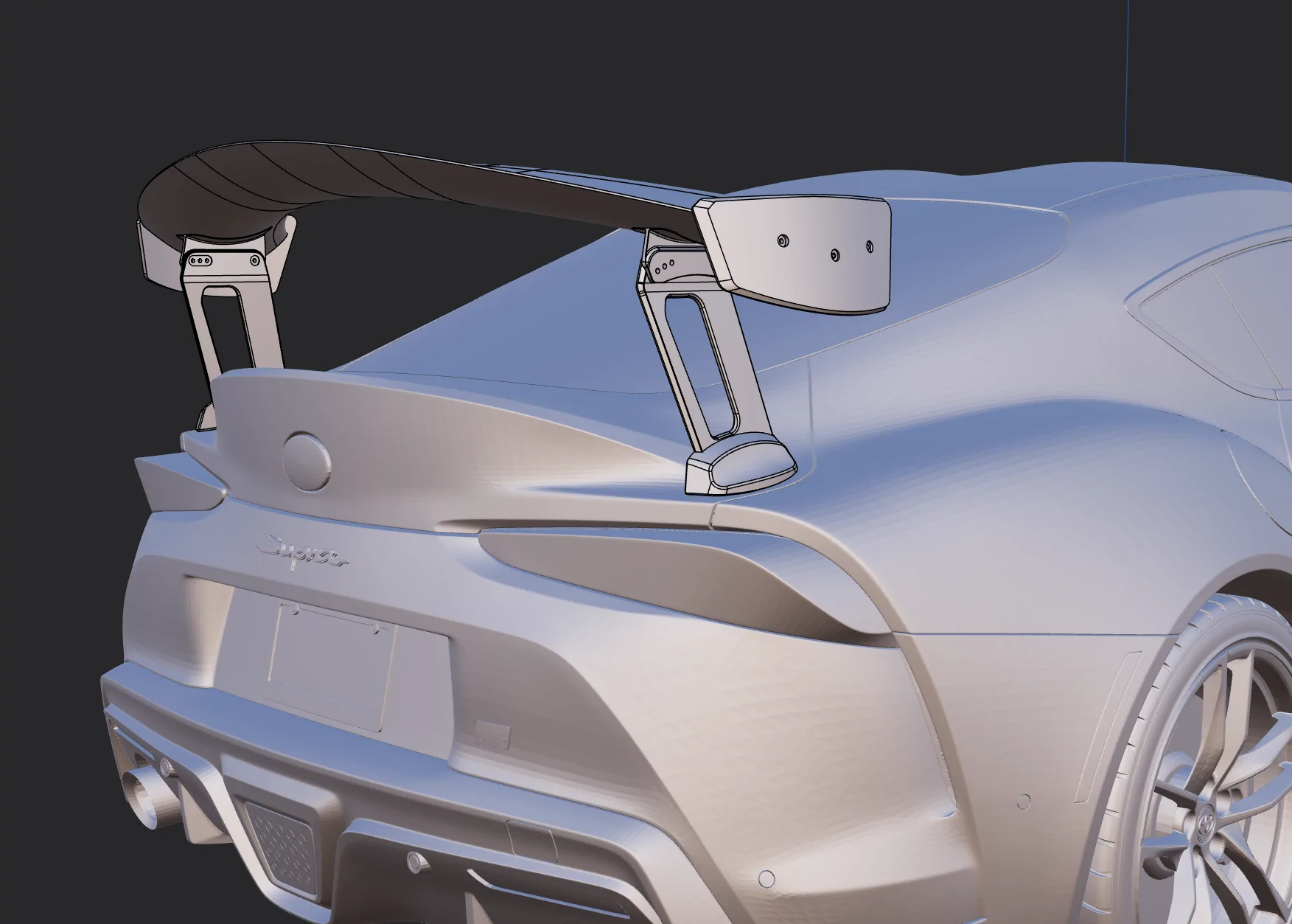

Playing around with new modular concepts while i have the mounts printing

Looks more like a DRS concept to be honest
There would be like 2 or 3 supports once its 100%, i just didnt add those in yet. I really like the idea of dual elements but its hard to make it look good... it really draws attention ..idk if thats good or bad yet
Edit: if i were to make a drs flap it would blend right into curvature of the too side so it wouldnt be lifted until its flipped

I could see doing DRS with the whole wing, but a DRS flap on a wing with that much curvature around the vertical axis?
That may actually be new territory entirely. If not, I'm sure that the only people that may have gone down that road with any sort of success would be some engineer that was on some F1 team over the years, some random composites engineer at somewhere like Pagani or Koenigsegg, or someone at Lockheed Martin special projects or NASA.
Not saying it can't be done, but I am saying that you'd have a hell of a list of problems to solve.
1 mistake I made was trying to fit a secondary element on that chord... main element needs to be brought down to like 210- 225mm, secondary 80-100mm.
I probably would not attempt a DRS type wing with this current wing deck profile... as much as I'd like to keep the curvature it would pose a huge challenge. That being said I have thought of ways around it, the design might just look better in mind than in reality... i dont know, I havent actually attempted the CAD... 1 fixed product is difficult enough for now.
The main goal is getting this wing from cad to real... after that, i can experiment a bit but a drs wing is out of my realm of knowledge at the moment.
