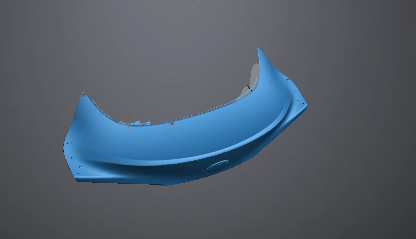

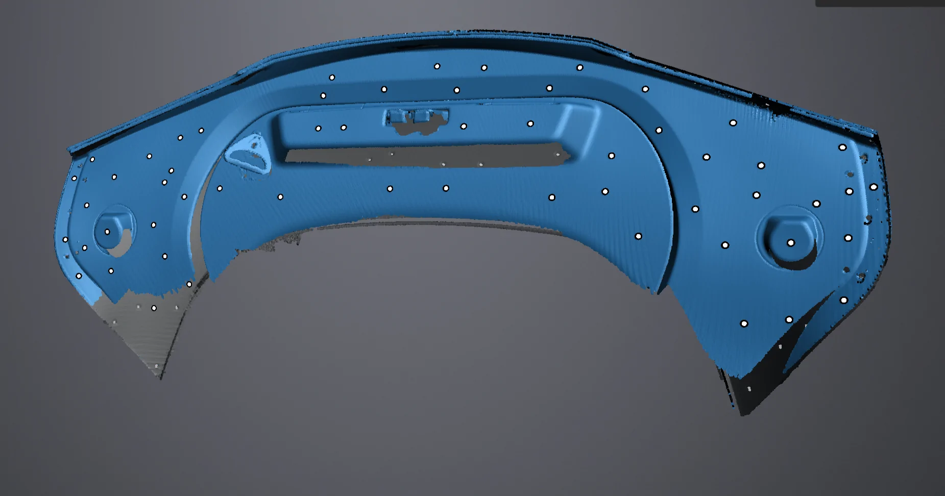

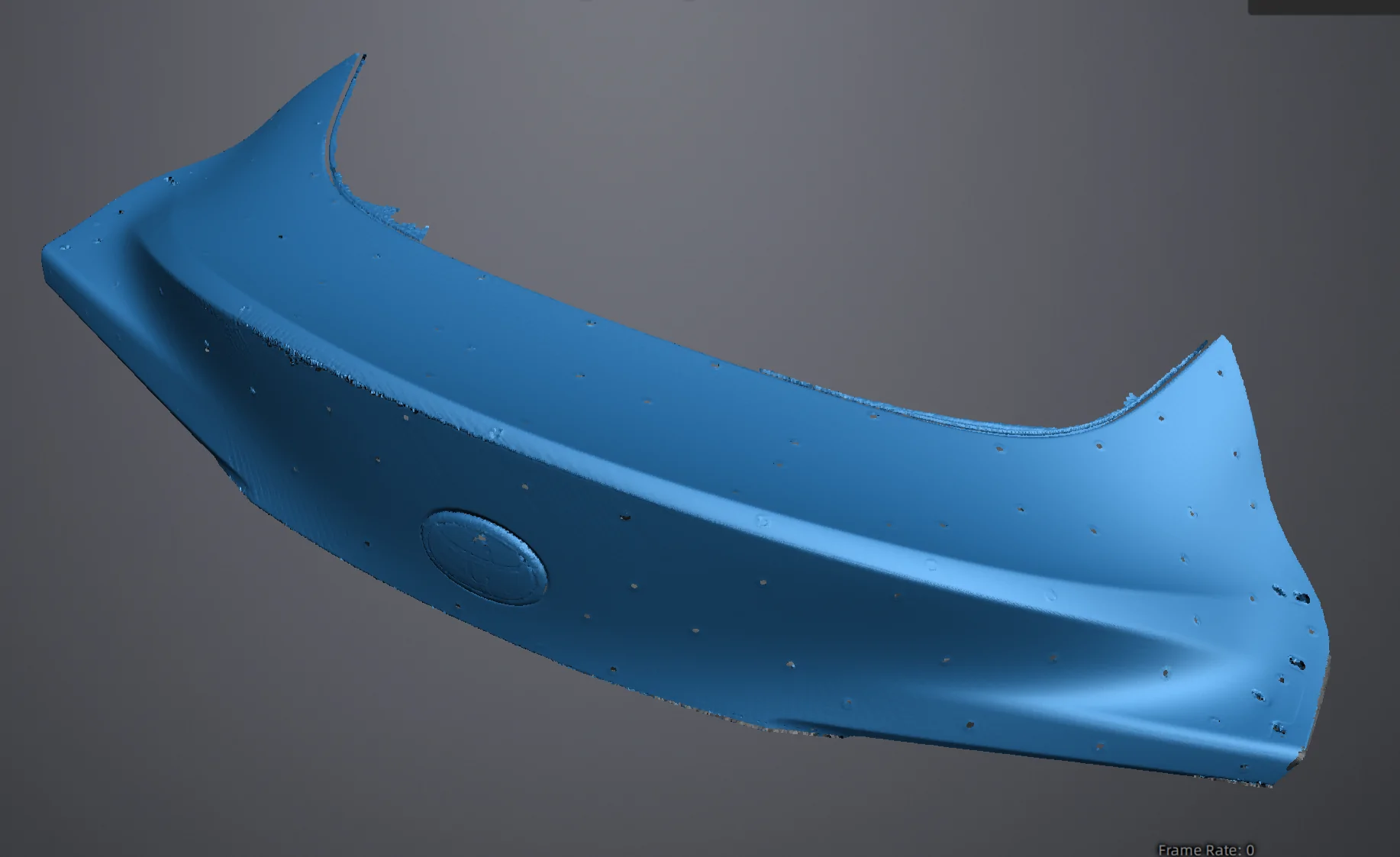

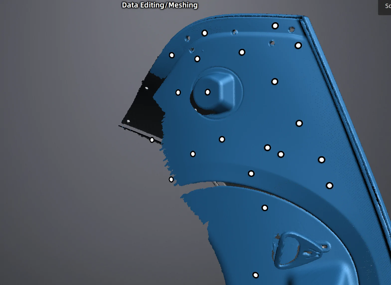

Finally got around to scanning the trunk top and bottom.
Got some useful scans/data... ill be making the mounting holes and underside supports soon

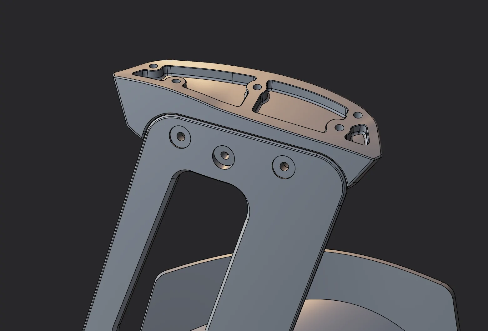

As for construction, current plan is:
• Wing: 3mm composite shell (carbon + fiberglass), reinforced internally with 5–6 spars for stiffness
• Upper mount: 6mm carbon bracket, bonded + riveted into the wing structure
• Risers: 8mm 6061 aluminum
• Lower mount / trunk mount: CNC 6061 aluminum
• Mounting geometry: middle riser hole is angled ~20° or so i can’t quite remember now, to provide cross stiffness
• Underside support: additional aluminum bracing under the trunk for load distribution
Main focus right now is making sure the load path is solid from wing → risers → mounts → chassis so nothing flexes or fatigues over time.
Still dialing in details, but trying to keep it strong, serviceable, and not overly complicated to manufacture.

Feet pics anyone?
Trunk mount and hole position made easy with the scan.
Still need to do the under trunk supports

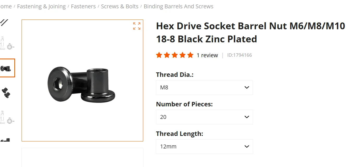

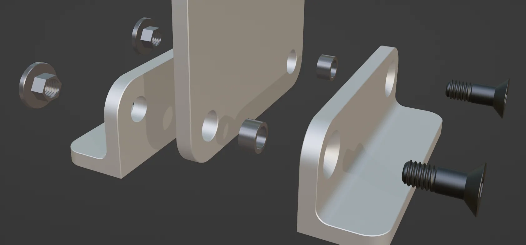

Did you mean like a flange nut when referring to sleeves? Photo for reference. I use those in prototyping but I can transfer it over to production (if and when). I like the look too.. same hardware appearance on both sides looks professional. I decided to go with M6 hardware all round but M8 would considered for the riser-to- trunk mount threads
I had considered a gasket in between the components as well but i never see other manufacturers use them so i thought i was just been over cautious... good to know my thinking was correct

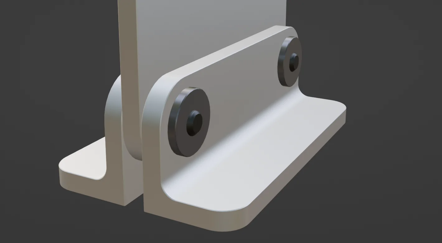

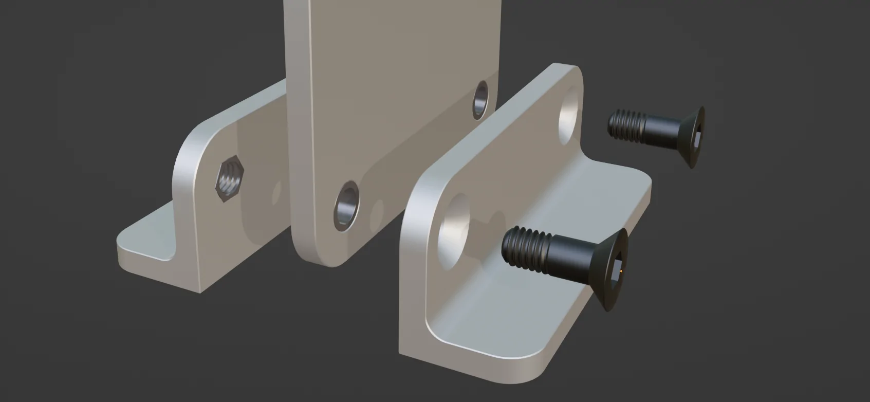

3mm isn't a bad choice. I'd call it good tbh. It'll last.
As for the sleeves and barrels, I'd look at using both. The countersunk bolt will hold it's piece in place but the slack between the bolt and the bolt hole on the other parts isn't a matter of whether it will or won't wear, but rather how much and how quickly.
I drafted this up just to show you what I mean. Instead of threaded barrels, I drew it up using broached inserts but either is viable for the opposite side. Yours looks better but the key to either is a very tight fit. You can absolutely make it work but every thousandth of slack contributes more to a problem. A broach fit is king when it comes to staying in place (when used correctly). I'm not sure where to get them but I've seen them come in a bag from a hardware supplier.
Of course if you're going single shear, a barrel nut on one side and a countersunk bolt on the other will absolutely work, you'll just have to make sure that your barrel depth and part thickness match either in the design phase or hand fitting phase.

Nice example thank you
I was going single shear ...trunk mounts-to-riser, 3 bolt with the middle being at an angle. and single shear up top .
The riser being 8mm and the top bracket being 6mm thick is 14mm total... then add 2x2mm washers and a spring washer on the riser side you're at 18mm before the spring washer..20 ish mm with the spring washer.. so an 18mm barrel nut like a showed you should be long enough with just a little extra, the flange bolt (matching style) would be about 20mm.
The spring washer could be thicker to offset the setup so the flange bolt doesn't bottom out completely and leaves 1-2mm of thread. Thread locker too... or could just use nylocks and through-flanged or button head bolts. It looks a lot more aftermarket but nylocks are better
