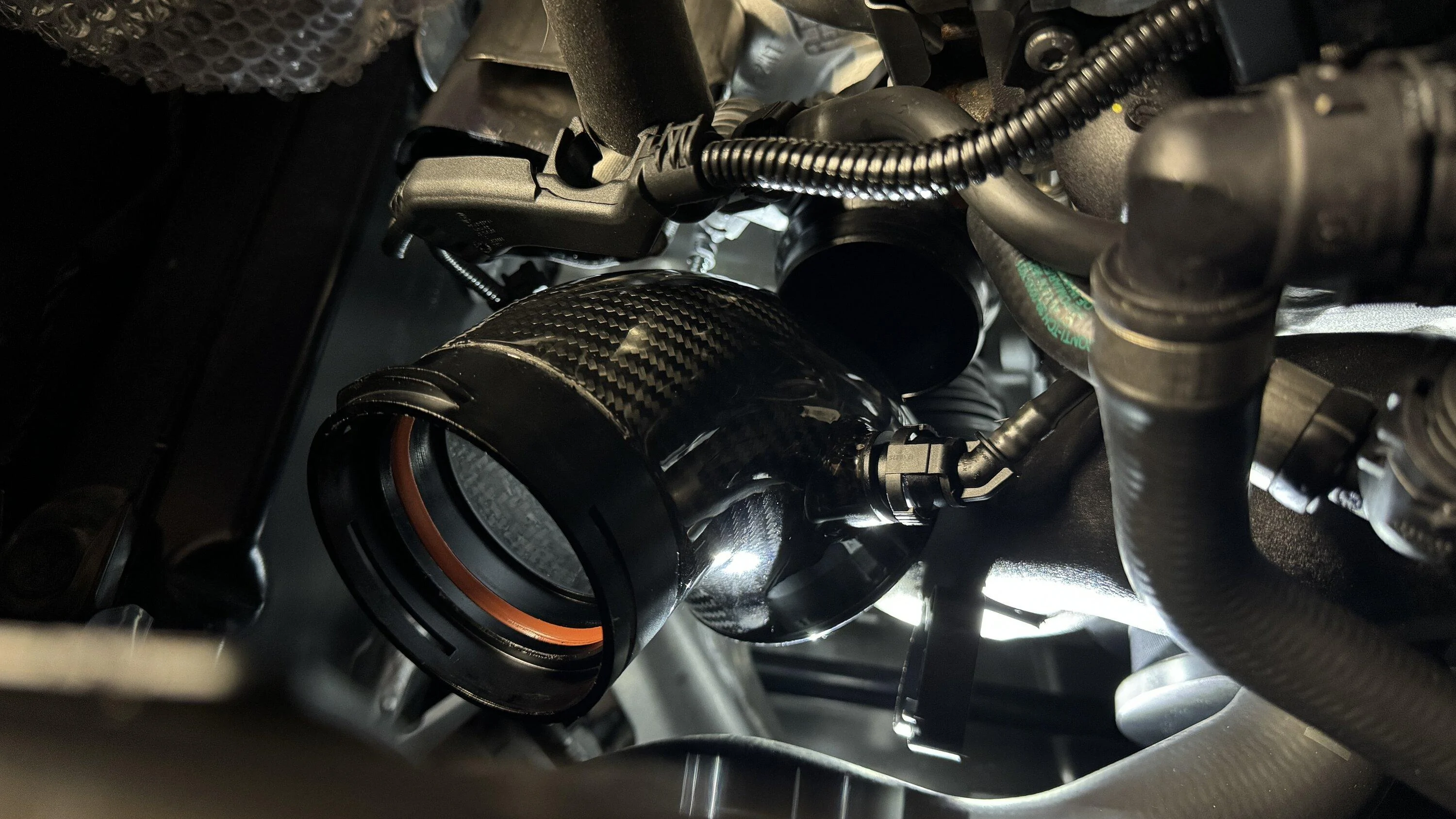

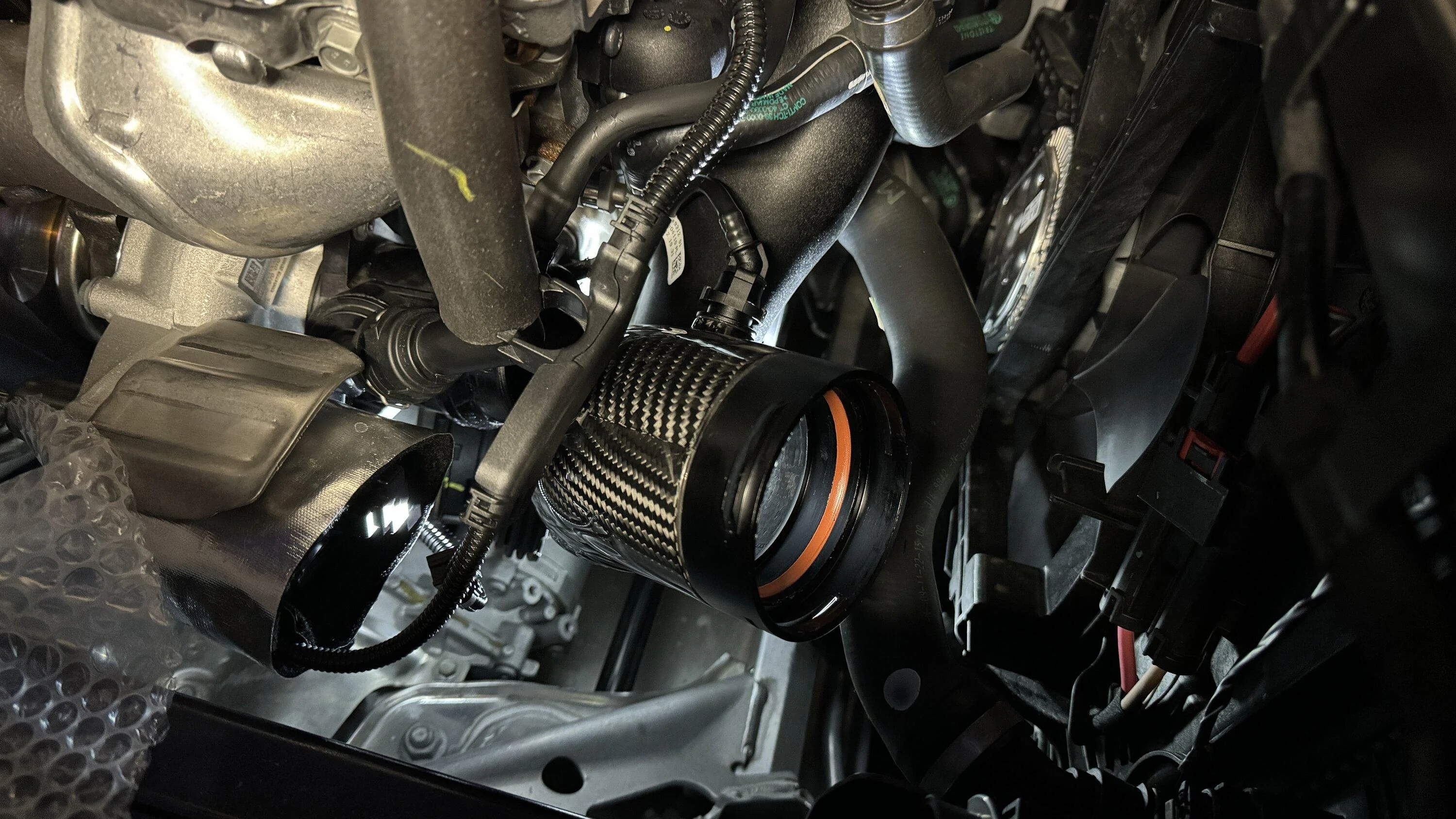

In case anyone has a hell of a time connecting the breather / PCV hose like I did.. here's what I found that made the process super easy..
1. DO NOT connect the inlet pipe to the turbo (yet)
2. Flip the inlet pipe upside down and pull the hose out a little bit
3. With this orientation, you should be able to align the inlet pipe and hose while also being able to give it proper pressure to click in the hose.
4. Carefully (and slowly) spin the inlet pipe back up to the correct orientation and connect it to the turbo
Thank you I know you just saved me 30min of throwing tools
