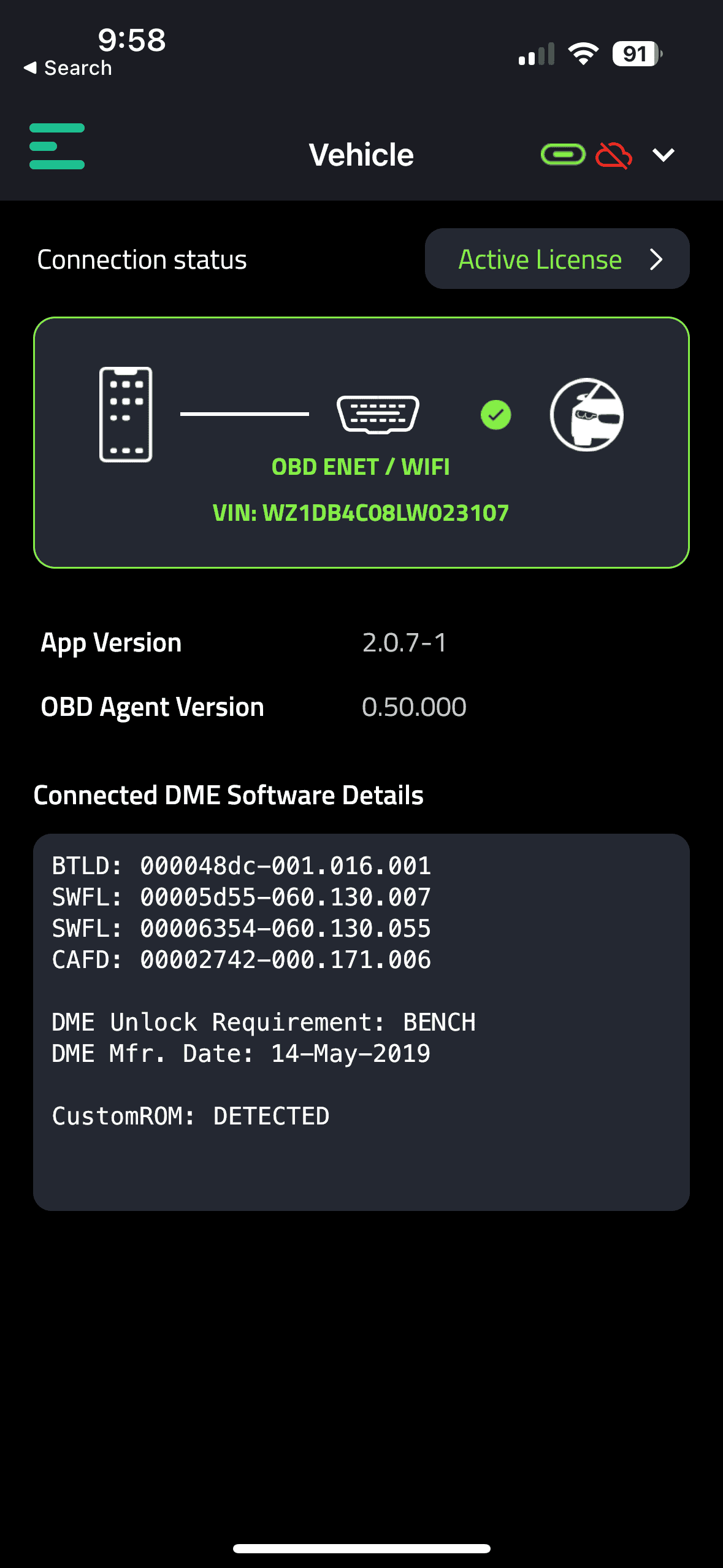

Recall locks the ecu, tuned or not. I have no plans on doing the recall.
For pre 6/2020 ecus that get locked, you just need to get it bench unlocked. No Femto needed.
8,783
17,240
Just took this screenshot now. Even today, it still states it needs a bench unlock…
Interesting, will have to give it a shot. Thanks for the info!
