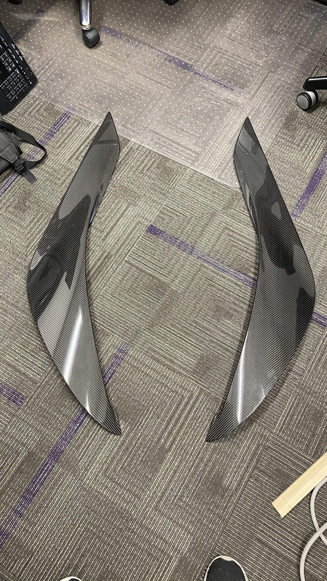

i got the Seibon ones, good quality and they utilize all the clips, I've seen some only use a few. I managed to only break one clip out of all of them removing the stock ones.
i noticed the channels that the clips slide into on Seibon are a tad thinner than stock so the clips fall out when you hold it up to install. So Iā€™ll have to get a drop of some adhesive on each channel to hold the clips in long enough to install it. I did break off a few of the tabs that hold in the fake vents. A plus for versions of these that get rid of the fake vents. The tabs are very weak and flimsy. The Seibon ones donā€™t utilize the stock foam small insert at the corner that i assume helps keep water out and vibrations or something. But for carbon fiber fitment that has usually been a pita from past cars or me, these are pretty spot on. Like the rexspeed rear lip spoiler.
