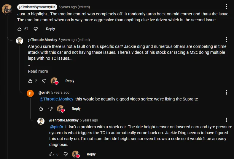

I would think so to.
This is what made me think otherwise.
That was 5 years ago and they had no idea how to fully turn it off.
You can 100% turn it off.
If you have TPMS and pressure is below a certain psi, it will flip the TC back on, but you can just long press again and it will stay off until you shut the car off. If you have no TPMS, then no issue.
This platform has been out for seven years now. It's all figured out.
